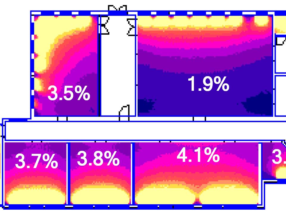

Ignoring the cost as requested which is my biggest concern, it's a balancing act. You could get a daylight analysis study done. It's a 3D version of the house done by an environmental engineer and measures the daylight available. We get them done a lot (for larger projects not houses) and they're very useful. We always get them for schools and offices so you can work with natural light without needing additional artificial light. They give great insight in the difference of increasing a window 200mm or moving a wall slightly makes. The below example shows a room with only 1.9% which has multiple but small windows that needs review and will be dark compared to the others which are well lit naturally. With the amount you're going to invest in a basement this could be money very well spent.

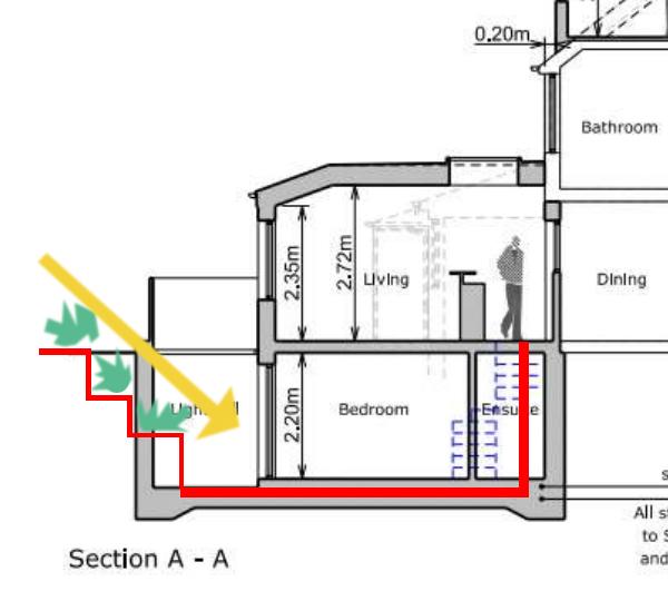

Have you a section? Could you look at stepping the light basement lightwell so at the base it might be only 1.2m but it steps up in raised planters to somehow merge and incorporate into the garden. It will also make it a lot less depressing to look out of a bedroom onto a massive retaining wall.

@Dudda - the daylight analysis sounds like a good suggestion - I will look into it as we're also a bit worried about the kitchen. it's actually one of the things we're hoping to improve on from the current house layout, as the existing room isn't super dark, but definitely is not light. We're hoping that taking out one of the internal walls will help quite a bit with that but hopefully the light survey will confirm that. I quite like the stepping idea too, I'll have a think about that.

I'd try and keep the basement wall out a bit from the existing house. It will work out easier to build (and therefore cheaper) not having to underpin the existing house as much. My crude overlay also shows how more light can get into the basement if you've the wall stepped and it will look a hell of a lot better than a 2.7/2.8m high retaining wall.basement.jpg.9906d2cf5265f900a9e2bc511acf8222.jpg
