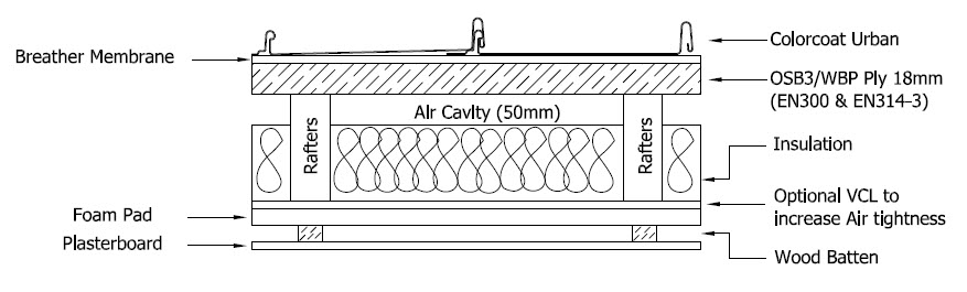

Out of interest is your roof make up something like the tech drawing that I've shown below? I'm waiting for Tata to confirm the make up as it seems to be causing some confusion (largely caused by my architect!). Tata's technical guide isnt exactly clear on pitched roof makeup as to whether the ventilation gap is required in all scenarios.
I know @JSHarris considered Tata on his MBC build?
On the strength of this drawing I've suggested:
(from inside)
1.      15mm Plasterboard
2.      22mm Service Cavity Batten
3.      Airtight Membrane
4.      225mm Rafter
5.      Airtight Membrane
6.      50mm Counter Batten on Rafter
7.      18mm OSB3 Deck
8.      Breather Membrane
Edited by Barney12
Formatting error.
While that's not like mine, I believe that will be OK, And it's reminded me that the deck is 18mm OSB3 not 22mmm (I'll correct my post)
Part of my Standing seam is on a buildup of 350mm I-Joist structure roof, fully filled with blown cellulose fibre, 16mm Egger DHF board, 50mm battening to create a ventilation gap and then 18mm OSB3, breather membrane and standing seam.
Tata actually looked at whether the ventilation gap was needed with the cellulose fibre fully filled roof, and their calculations said it wasn't. (Personally I wouldn't have gone without the ventilation gap)

I think the issue is the same will the full fill on the MBC 225mm rafter (which is effectively a plated standard web joist). Its a detail which is not common.
I agree with with you that having no ventilation gap "feels" wrong.
Being an early adopter (in general UK building terms) is not much fun at times. It brings a lot of indecision from suppliers!!
