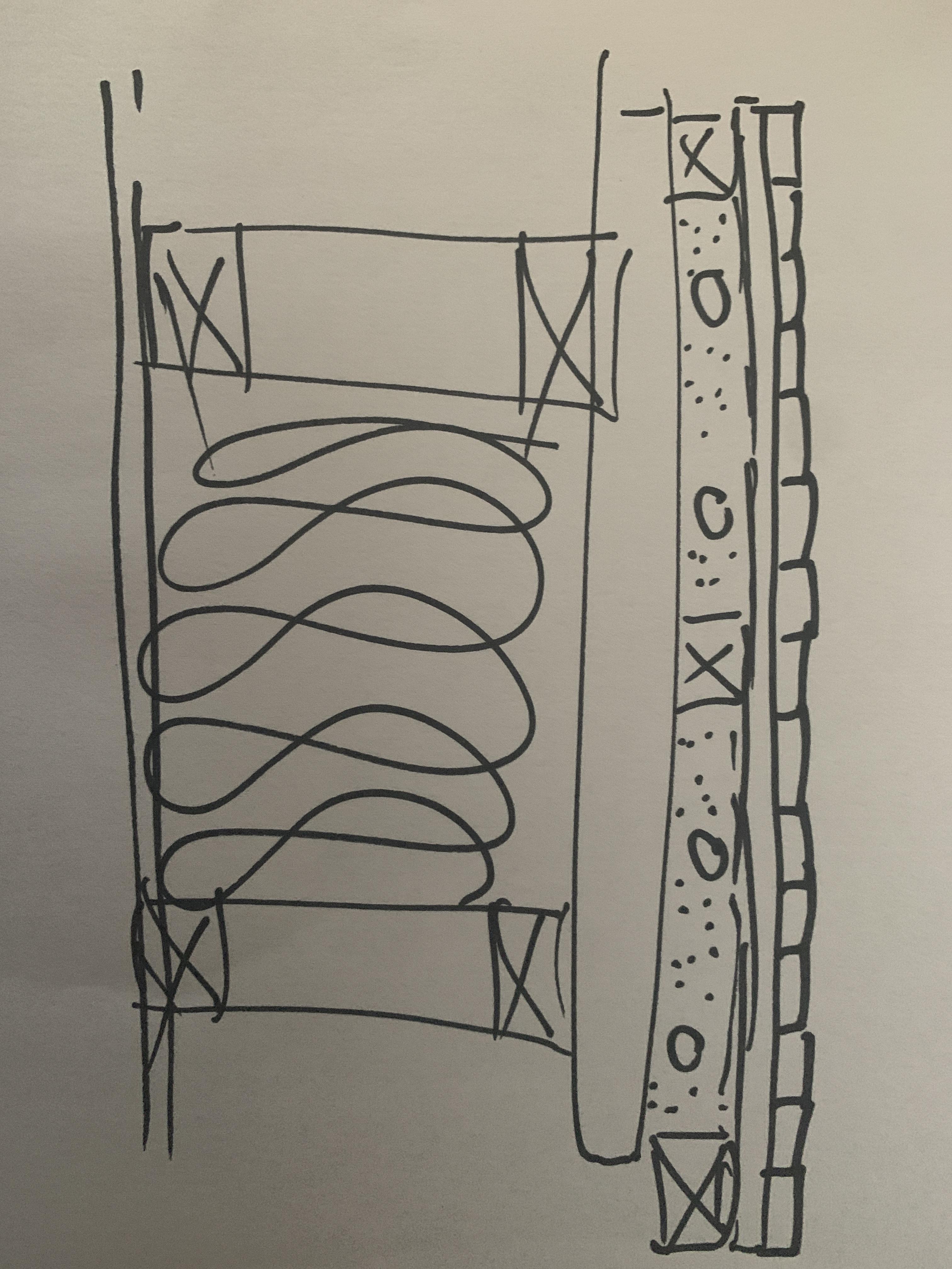

What is the XFLo adding here if this is first floor..??
 I would - assuming joists can support - use 18mm battens at 400 centres with the pipes in between, and fill with a pug mix of 6:1 sand cement. Cap this with 11mm OSB, then your parquet.
That build up of 29mm is less than your Cellecta and it’s rubber flooring and the pug mix adds a decent amount of dampening mass.

I'm not sure how I would do what you are suggesting as surely for pipes to go in between the joists, i would need to drill through the 50mm wooden part of the POSI and I thought the whole point of posi joists is that they can't be drilled or notched and one has to route stuff through the metal webbing.

not at all ..
parquet
OSB
Pug/pipes/batten
22mm Caberdeck
Joists / insulation
Clearer..??
9 minutes ago, PeterW said:
not at all ..
parquet
OSB
Pug/pipes/batten
22mm Caberdeck
Joists / insulation
Clearer..??
That is clearer, thanks. So the UFH still goes above the Chipboard, but rather than in the XFLO, which in my case is 25mm thick, it would go in the pug mix, which you think would dampen down footsteps so no need for the 6mm rubber. It's a small saving in height of 13mm (as 18mm battens with PUG in between instead of 25mm XFLO , and no 6mm rubber layer) but sounds like extra work. Not sure it's worth it for a 13mm saving.

Re acoustics. The addition of the pug will reduce air-born sound, but not impact sound.
The insulation shown between joists will reduce a large proportion of airborne and impact sound.
There remains some sound of impact as there is direct, solid structure from floor to ceiling.
If the 2 floors are both yours then I think this is a decent domestic solution.
