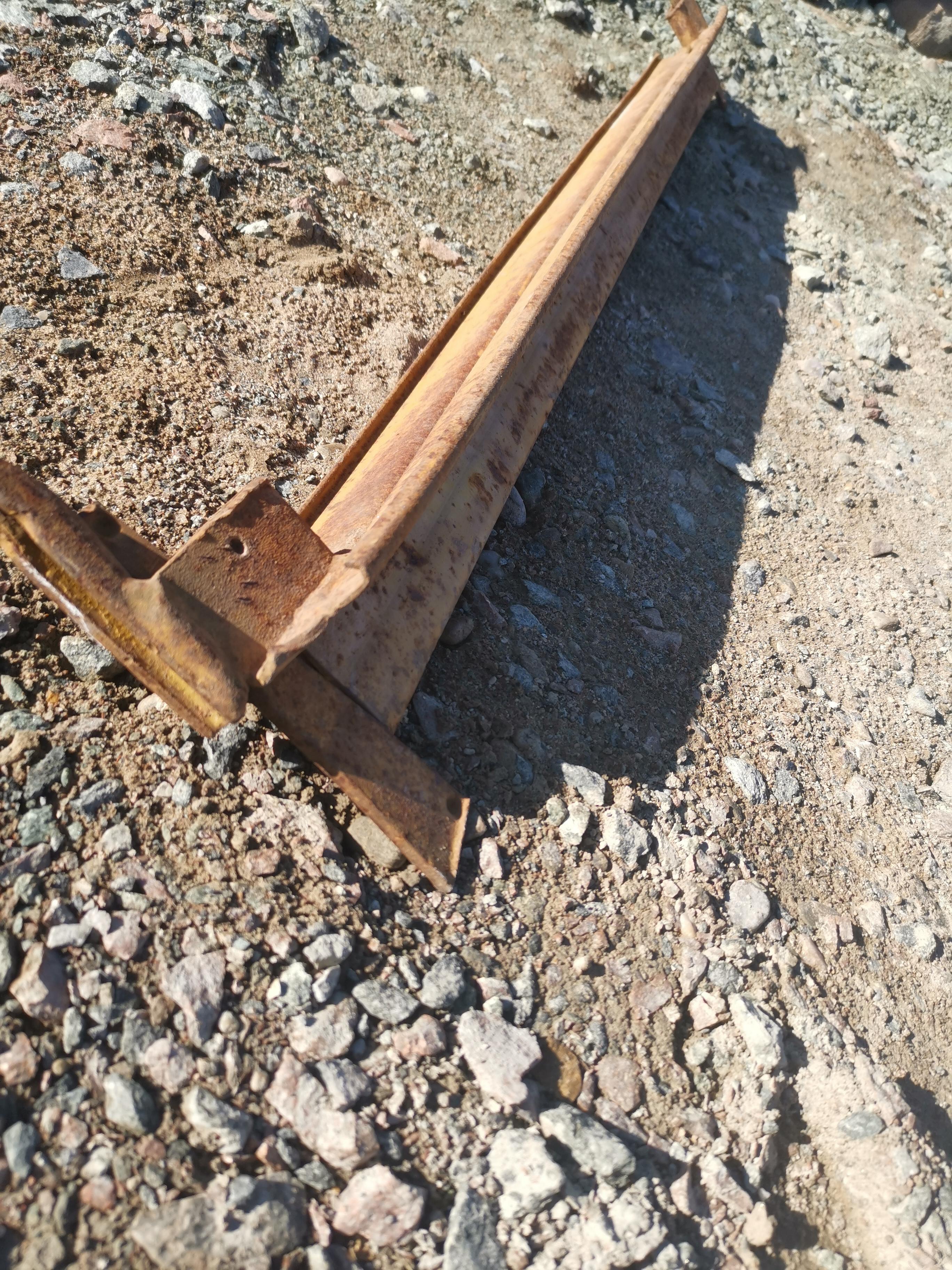

djcdan Posted May 11, 2021 Share Posted May 11, 2021 Can anyone identify this piece. It is a transom, but ever so slightly lipped edges. I ordered some return transoms, but was expecting there to be a more obvious manner of connecting to the perpendicular ledger such as what I'd seen in online demonstration vids. Can anyone advise on this? Link to comment Share on other sites More sharing options...
ProDave Posted May 11, 2021 Share Posted May 11, 2021 There are at least 2 different designs of Kwikstage Transoms, the ones you have pressed out of sheet steel as you have there, and some are made of two steel angle sections and welded together at the ends. I have always viewed them as completely interchangable. I have not seen this "return transom" you mention, do you have a picture? Link to comment Share on other sites More sharing options...
djcdan Posted May 11, 2021 Author Share Posted May 11, 2021 Just now, ProDave said: There are at least 2 different designs of Kwikstage Transoms, the ones you ave pressed out of sheet steel as you have there, and some are made of two steel angle sections and welded together at the ends. I have always viewed them as completely interchangable. I have not seen this "return transom" you mention, do you have a picture? Not so far. 2/3 of the way through unpacking and if these are normal transoms, the return transoms are currently no where to be seen. The majority of the transoms I have are the two pieces welded together as you mention. Link to comment Share on other sites More sharing options...
Vijay Posted May 11, 2021 Share Posted May 11, 2021 (edited) that looks like a normal transom. A return transom has a kind of upside down U that hooks onto the ledger (at 90 degrees) https://www.scaffolding-direct.co.uk/new-kwikstage-4ft-return-transom-2-2.aspx If you Google retrn transom, you'll get loads of images Edited May 11, 2021 by Vijay Link to comment Share on other sites More sharing options...
Declan52 Posted May 11, 2021 Share Posted May 11, 2021 These are the shape. This one can only connect into a standard by putting the long spike at each end into the star on the standard and driving in the pin. All ledger bars are horizontal and connect to the standard the same method. Return trannies arent used that much. Most people just over lap planks to cover the gap when you do a right angle. Link to comment Share on other sites More sharing options...
djcdan Posted May 11, 2021 Author Share Posted May 11, 2021 1 minute ago, Declan52 said: Return trannies arent used that much. Most people just over lap planks to cover the gap when you do a right angle. Maybe this is what the supplier has done. Return transoms were on the invoice however. Link to comment Share on other sites More sharing options...
Declan52 Posted May 11, 2021 Share Posted May 11, 2021 If you have paid for them then you want them to be there. If they are not there then either get a refund or additional bars sent out. 1 Link to comment Share on other sites More sharing options...
Vijay Posted May 11, 2021 Share Posted May 11, 2021 3 minutes ago, Declan52 said: These are the shape. This one can only connect into a standard by putting the long spike at each end into the star on the standard and driving in the pin. All ledger bars are horizontal and connect to the standard the same method. Return trannies arent used that much. Most people just over lap planks to cover the gap when you do a right angle. I used quite a few. I found it tied the scaffold in nicely and no trip hazard Link to comment Share on other sites More sharing options...
ProDave Posted May 11, 2021 Share Posted May 11, 2021 Yes this is a real return transom https://www.scaffolding-direct.co.uk/used-kwikstage-4ft-return-transom.aspx And this is how you use it https://www.avontus.com/blog/how-to-add-a-return-transom-to-a-kwikstage-corner/ 1 Link to comment Share on other sites More sharing options...
