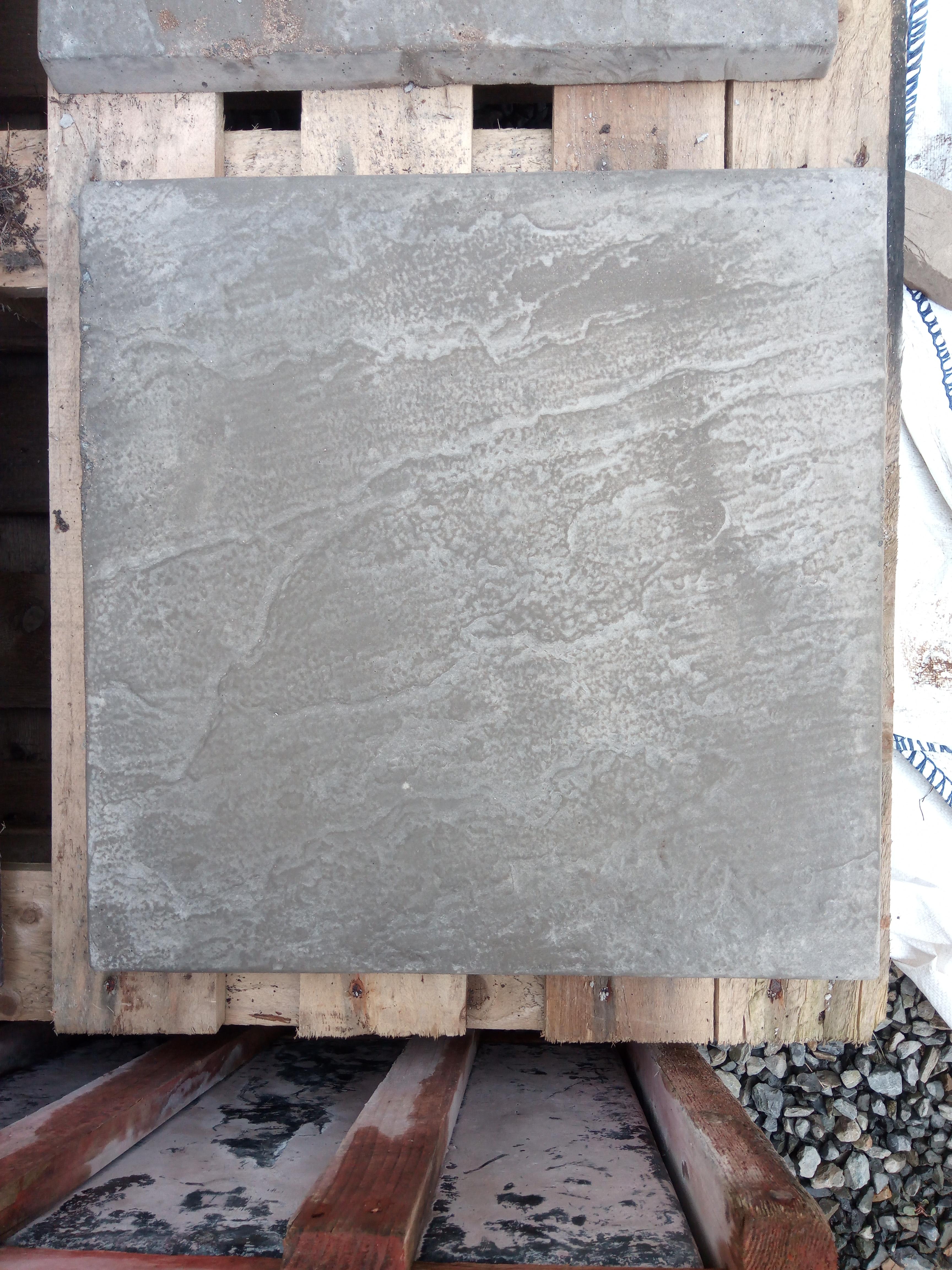

Slab 1, Veg oil used as release agent
Clearly I didn't get it all fully mixed.

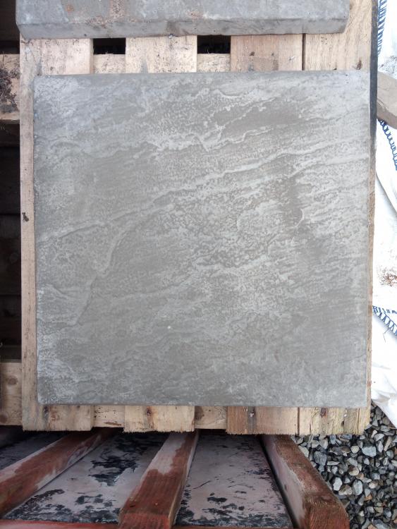

Slab 2, veg oil used as release agent.

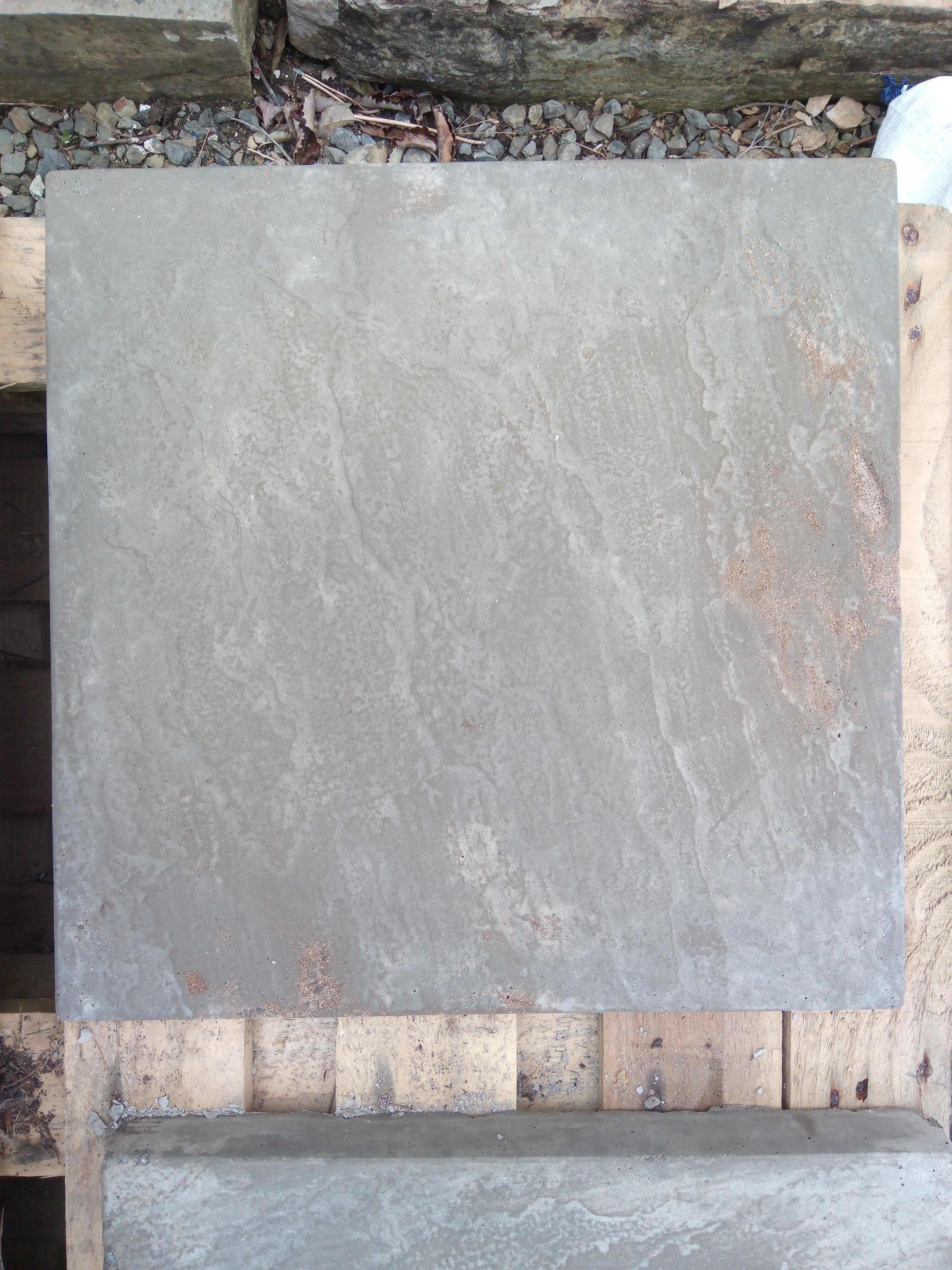

Slab 3, silicone spray used as release agent.

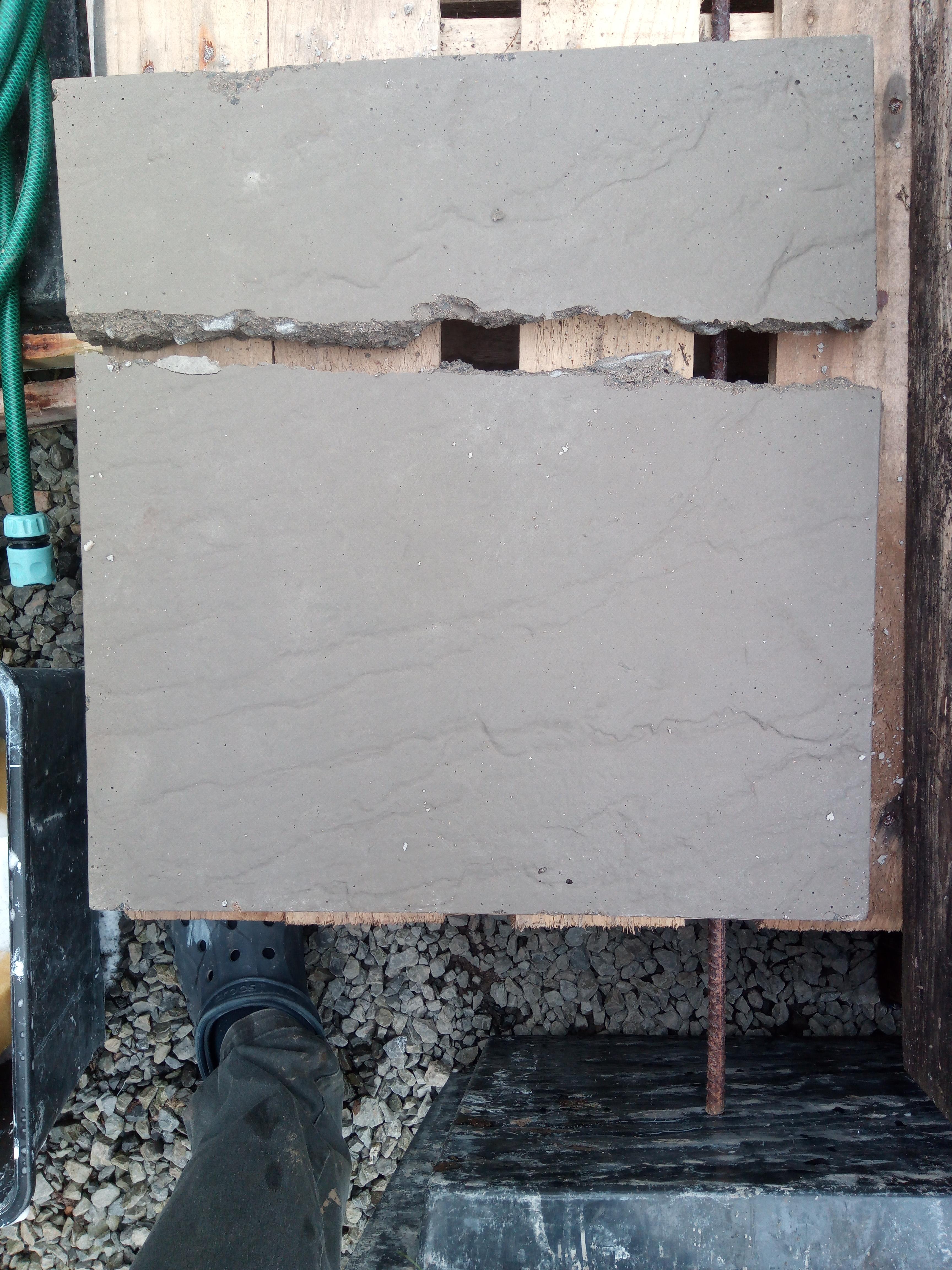

This slab was made with quarry dust as the aggregate, whereas 1 and 2 used Type 1 MOT. It was also a wetter mix which I think is why it broke.

Veg oil as release agent works, as does silicone spray.

72 hours in mould to cure may be better than the 48 I gave them.
Use a concrete mixer to ensure consistency of mix.
