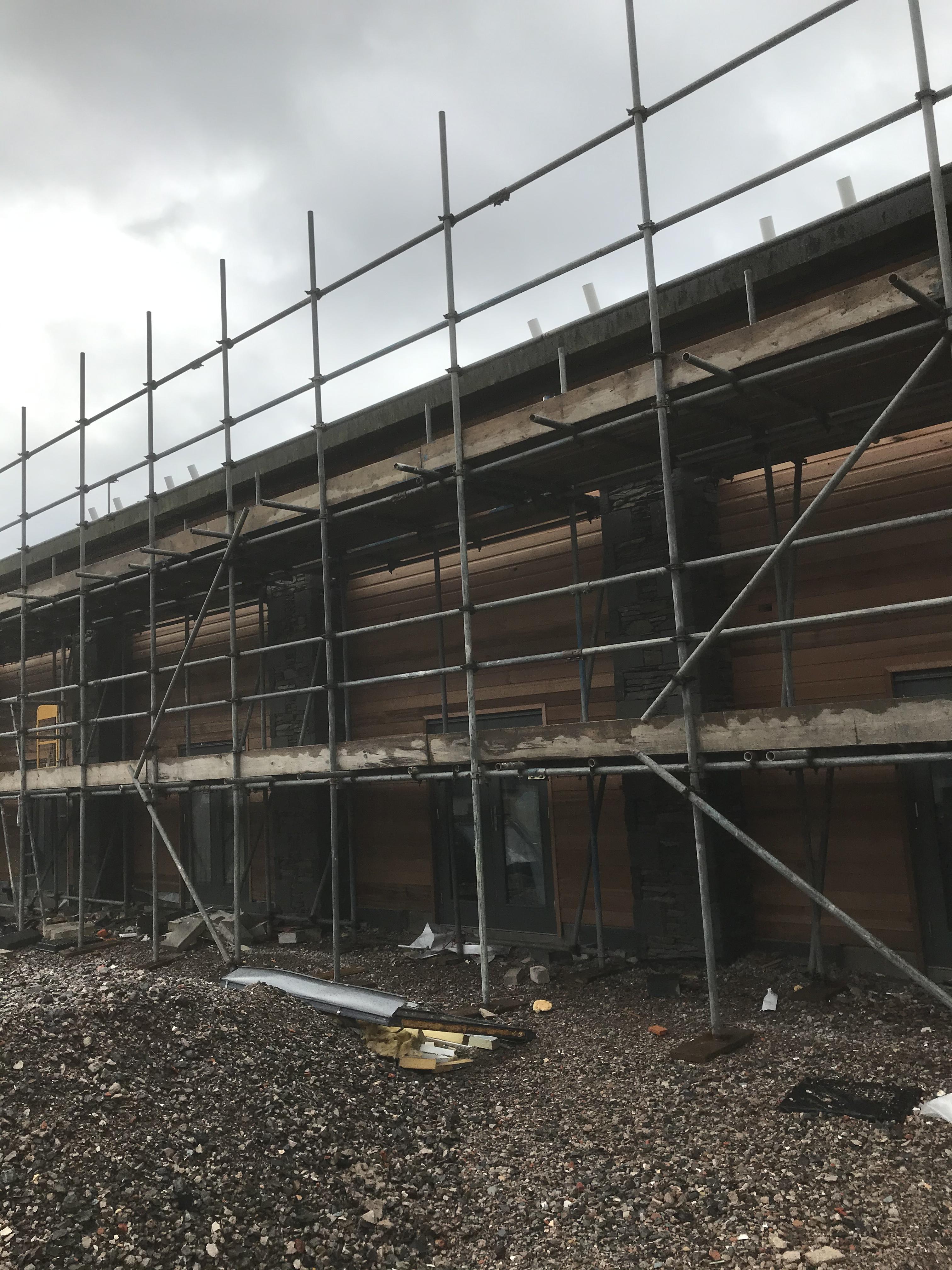

nod Posted May 9, 2021 Share Posted May 9, 2021 Some of the composite cladding looks good and also the cement board cladding Both are unaffected by severe weather I did one last year in Cedar I don’t think I would use it on my own home For the reasons you have highlighted Link to comment Share on other sites More sharing options...

nod Posted May 9, 2021 Share Posted May 9, 2021 One of our jobs has a engineered wood cladding that is fixed with a stainless steel clip system It comes with a 25 year guarantee But at £50 per length Isn’t cheap Link to comment Share on other sites More sharing options...
Homer Posted May 9, 2021 Author Share Posted May 9, 2021 (edited) 13 minutes ago, nod said: One of our jobs has a engineered wood cladding that is fixed with a stainless steel clip system It comes with a 25 year guarantee But at £50 per length Isn’t cheap Sounds good though as long as the wood lasts The stainless steel part def. sounds good...I think it may be worth paying the extra so as to avoid having to replace all the profiles at some point... Do you know the name of the product please? Edited May 9, 2021 by Homer Link to comment Share on other sites More sharing options...
nod Posted May 9, 2021 Share Posted May 9, 2021 10 minutes ago, Homer said: Sounds good though as long as the wood lasts The stainless steel part def. sounds good...I think it may be worth paying the extra so as to avoid having to replace all the profiles at some point... Do you know the name of the product please? I’ve to call on there tomorrow afternoon I’ll have a look 1 Link to comment Share on other sites More sharing options...
