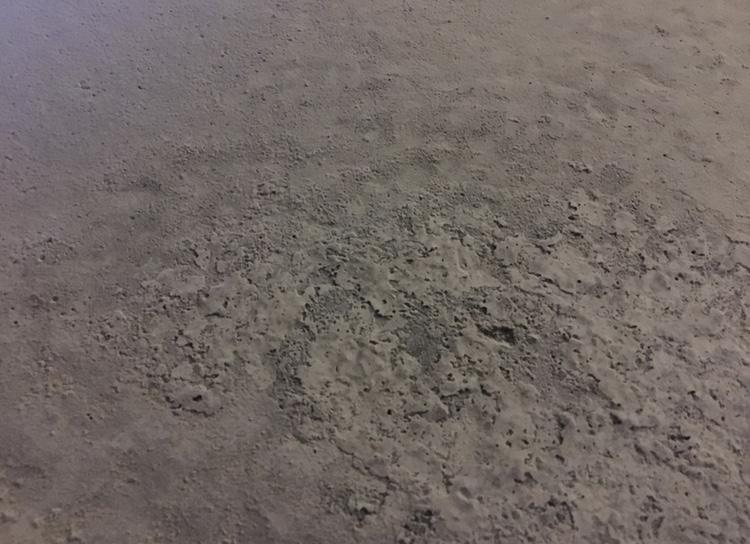

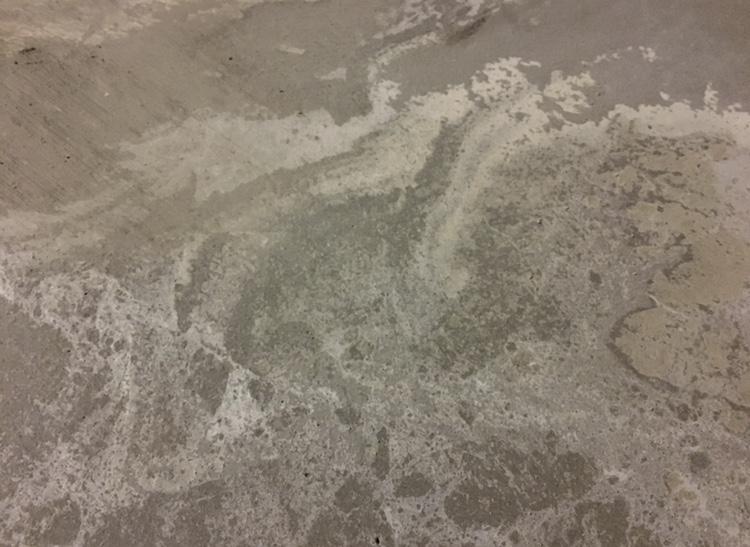

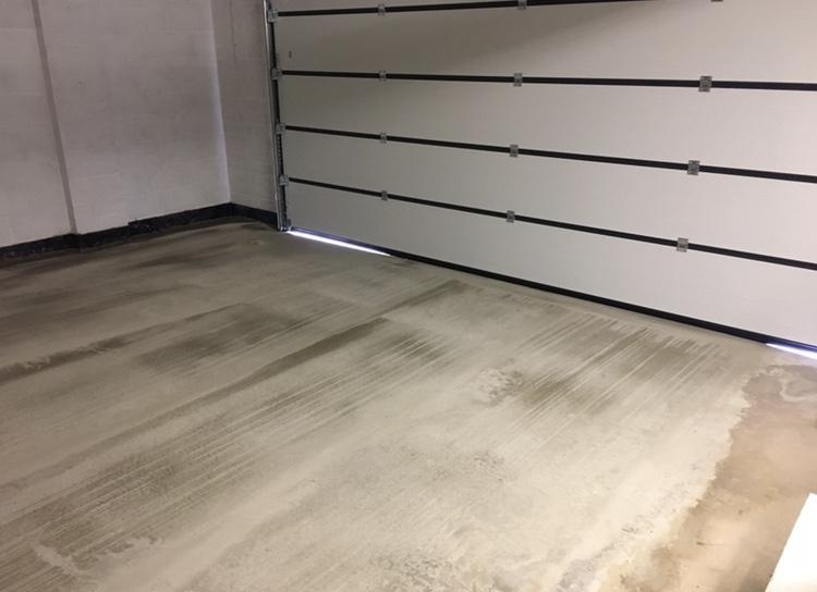

Stuck my head out to see how it’s looking 24h later.
Certainly right about flat vs level. Garage door seal will need some adjustment as it’s slightly higher in the centre. Sunlight makes it look worse than it is, but still frustrating.

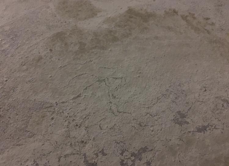

The surface water has dried and left a powdery top layer due to the ‘cream’ I’d assume. Some air bubbles also.
I have brushed some of it off - not sure whether I should wait until it’s cured further to do that or not.
There is one poor area here:
Again not sure whether to do anything with that now or not in terms of damage limitation - is what it is now unfortunately.

Need to let it cure fully now I'm afraid before you look at it .

The powdery top is a surprise. The 'fat' that comes to the top should be very hard after  few days, not loose and powdery This looks to have been a very wet mix.
Builder should at least brush then stone rub this back to hard surface (not yet)
The gap under the door happens a lot, and is a nuisance. I have had scores  of loading doors put in and this is a tricky thing.
My solution was to have the slab on a slope at that point so the water runs away. Too late for that.
option 2. stick some softer rubber under the one supplied, so that it can squeeze to shape.
option 3. fix down a threshold, so the water stops outside, and mastic at the edges...
