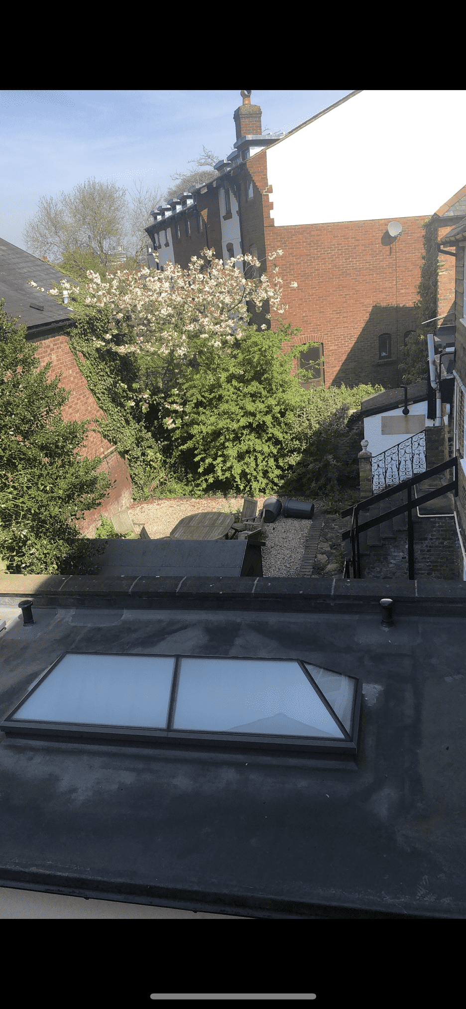

Hi i moved into a renovated property 6 years ago It is a terrace property with building both sides and higher than my flat roof.
The kitchen has a flat roof with 3 sky lights. One large one medium and a small one.
The roof is a GRP roof.
We moved in and after about a year there was a small leak through the roof of the kitchen. We called the roofer out who saw no issue with his roof and we called the skylight people who saw no issue with the skylight.
The roofer re coated the roof and we hoped all was good.
Over the next 2 years it leaked periodically.
We asked third party people to come and inspect the property. They said all the work looks in great order.
I instructed a heating specialist who essentially heated up my kitchen and did some thermal imagine to see where cool spots were internally and externally. Nothing was conclusive but he saw some cool air coming in from a neighbouring property. After inspecting the date the neighbour repaired the whole of his properties timber side.
After a year or so it leaked again.
The leak every time comes in near or around the same corner of the sky light.
We contacted the neighbouring property whose workman inspected his work and he said his work was still in perfect order. My roofer said the same about his work.
The roof light people came again lifted up all roofs and saw no problem or evidence of water coming in. However there was no weathering ( the roof lights we have dont require them according to the company who make them but we had lead flashing fixed as the roofer was concerned all along this was the issue.
After 4 mths its leaking again.
It can rain non stop for 2 weeks and not leak and then another time it can rain lightly. there seems no correlation of wind or weather pattern etc to trigger the leak.

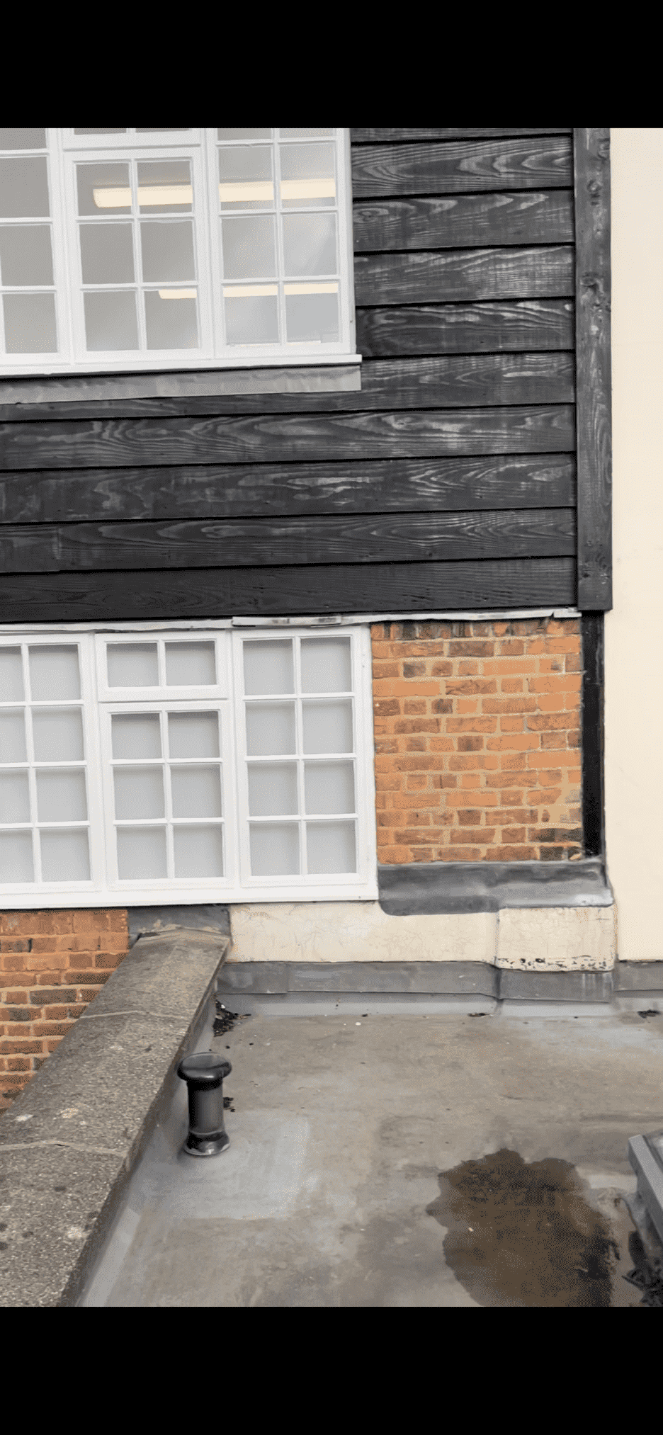

Ive attached some photos. Does anyone have any advice?
Many thanks in advance.

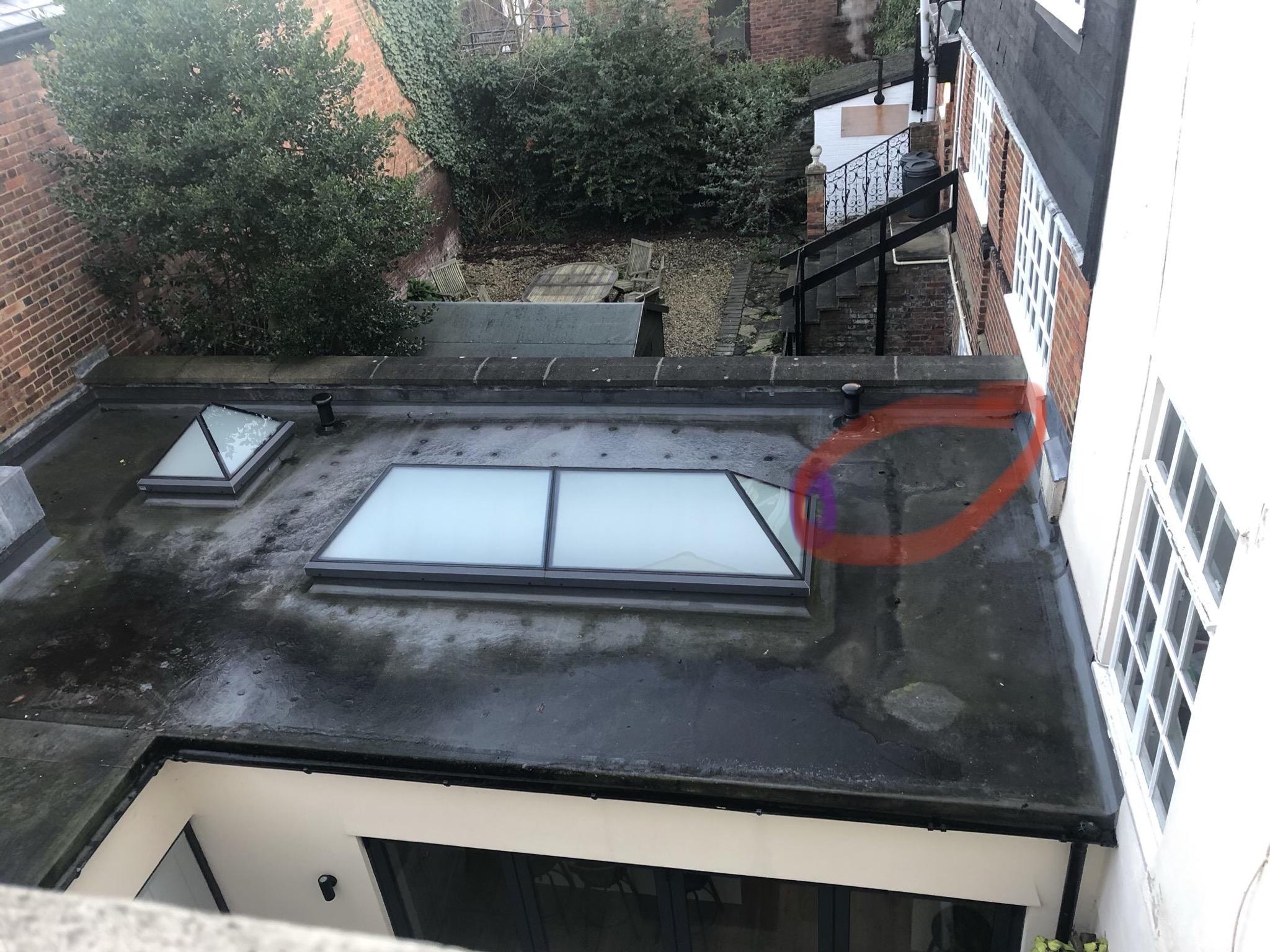

the leak enters the property below the red circle on the first pic.
sorry the leak enters into the kitchen below the purple circle in the first pic. Ie at the corner of the skylight
Problem with GRP is that water can travel through the fibres of the CSM or chopped strand mat so where the leak is showing in the kitchen ceiling may not correlate with where it is getting in above. Is there a gelcoat finish on top of the roof? All gelcoats are permeable unless it is an epoxy based one so finding the leak could be difficult.
It may be worth going up there with a moisture meter on a really dry day and check out the area concerned in an attempt to locate areas of increased moisture.

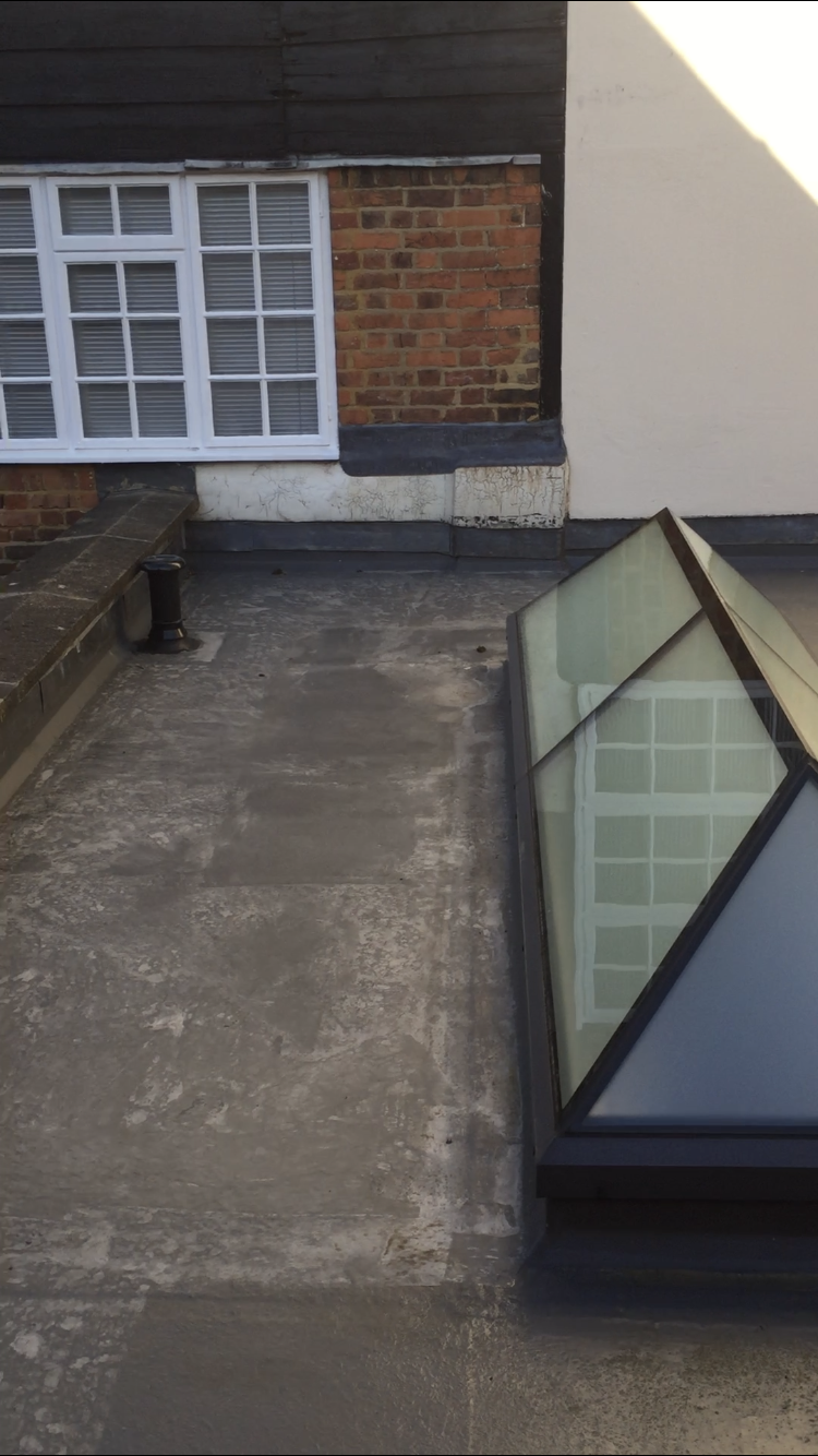

There are a number of reasons that it may be leaking, hard to tell from your picture.
So a number of questions.
Does the roof fall away from the wall/corner where you get the water marks inside?
Does it leak every time there is an good amount of rain, or only sometime?

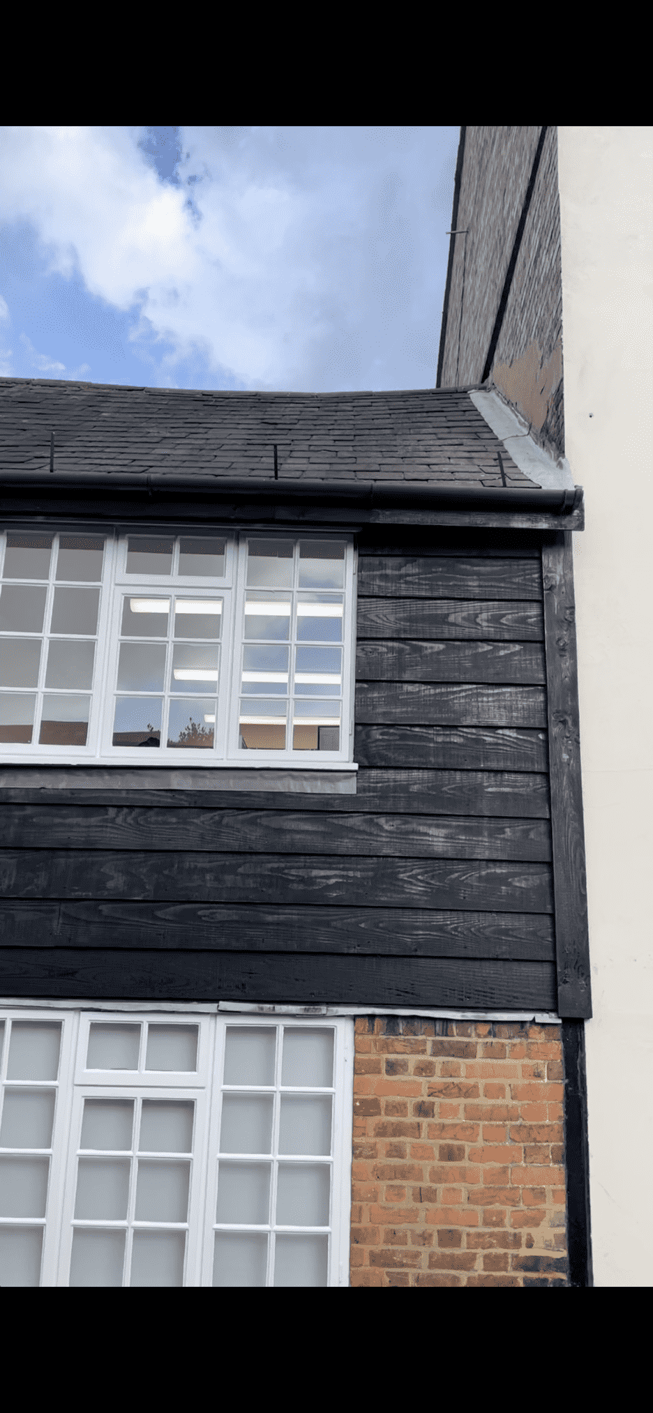

What is above the wall, is the gutter in good condition?
As it is a kitchen below, is that causing condensation?

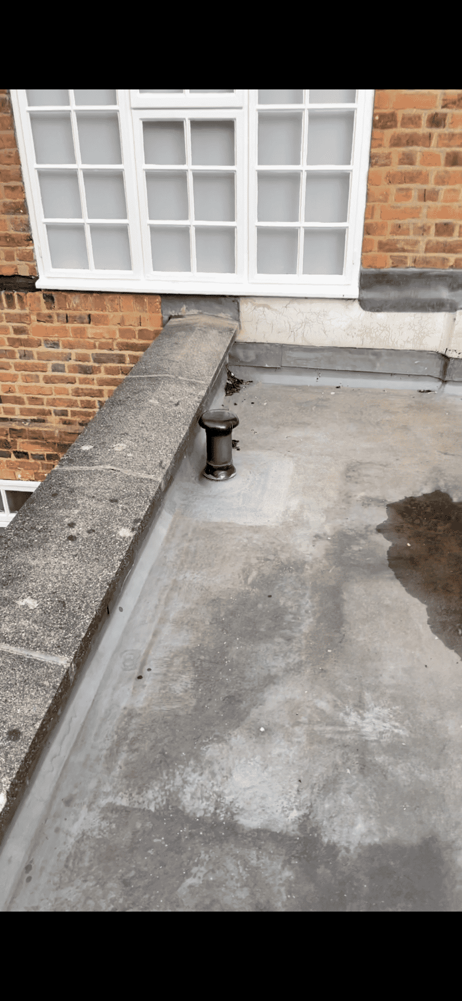

How is that pipe sealed to the roof?
What are all those circles in a line, bolts/screws?
Does the roof fall away from the wall/corner where you get the water marks inside? ESSENTIALLY THE FLAT ROOF POOLS ON THE NEAR SIDE OF THE PICTURE. THERE IS LIMITED SLOPE BUT TO ANSWER YOUR QUESTION YES I THINK IT DOES.
Does it leak every time there is an good amount of rain, or only sometime? ONLY SOMETIME. I WAS CONFIDENT IT WAS WIND RELATED TO START WITH BUT IT CAN BE SUPER WINDY AND NO LEAK AND THEN VICE VERCA
What is above the wall, is the gutter in good condition? THE GUTTER LOOKS IN GOOD CONDITION TO ME. IVE INCLUDED A PIC BELOW
As it is a kitchen below, is that causing condensation? NO THERE IS NO CONDENSATION ON THE SKYLIGHT OR IN THE CONDITION
How is that pipe sealed to the roof? THE PIPE IS SEALED AS IN PICTURE BELOW
What are all those circles in a line, bolts/screws? I AM NOT SURE THE PICTURE I HAVE SHOWN WAS ON A COLD DAY I WILL INCLUDE ONE ON A NORMAL DAY BELOW> I WILL ASK MY ROOFER TOMORROW THOUGH.
Sorry for caps but felt the best way to respond to distinguish my response from your question
cheers

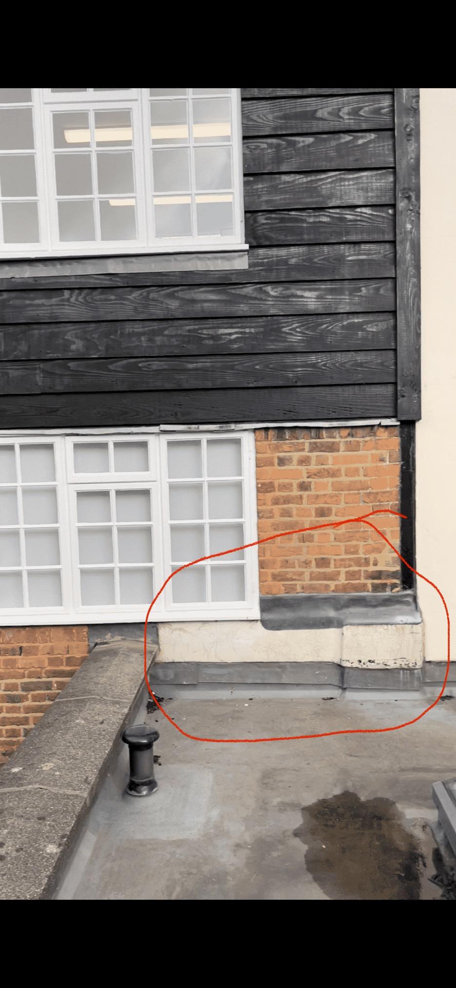

Really dont envy you trying to find the source of your water ingress, so many possibilities - all those mentioned previously plus it could be getting in via the window/cill then down behind the render (presume that is a rendered patch) and under the roof material that way
Hi MarkC when you say render do you mean the bit I’ve circled?
ive never liked that part but every respective person that has gone up there dismisses that area as an issue.
But I don’t like the look of it.

Wind direction may be important.  If rain is hitting the wall and getting between the wall and the flashing, it may be getting in and then finding a path.
I had an ongoing leak in a downstairs window, took me two years to find out that it was cracked render 3 metres away.  It was the wind direction that gave the game away.  It only happened when a proper SW hoolie was a blowing.
