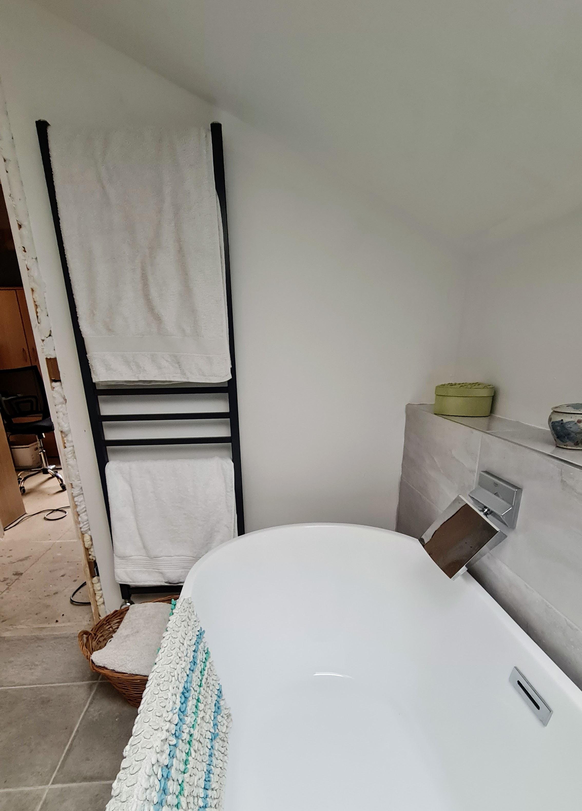

TryC Posted May 4, 2021 Share Posted May 4, 2021 Hi All, Does anyone know if you can you fit a towel warmer/towel radiator over a bath tub? is it safe to do so? Not over where the shower goes or the taps, but on the opposite end/walll. Thanks in advance! Link to comment Share on other sites More sharing options...
Marvin Posted May 4, 2021 Share Posted May 4, 2021 Well I assume this is electric? Check this info: https://www.drench.co.uk/blog/how-to-guides/what-are-bathroom-electrical-zones Link to comment Share on other sites More sharing options...
Bitpipe Posted May 4, 2021 Share Posted May 4, 2021 Assuming you mean electric and not wet? We have a full length wet towel rad that sits inside the curve of the bath (freestanding style) but wet so no electrical issues. However for electric, assuming it has the necessary IP rating then it should not be an issue? Link to comment Share on other sites More sharing options...

ToughButterCup Posted May 4, 2021 Share Posted May 4, 2021 29 minutes ago, TryC said: ... can you fit a towel warmer/towel radiator over a bath tub?... Not over where the shower goes or the taps, but on the opposite end/walll. ... Yes: https://www.geyser.co.uk/electric-towel-rails Easy to fit - even I can do it FGS.... Link to comment Share on other sites More sharing options...
