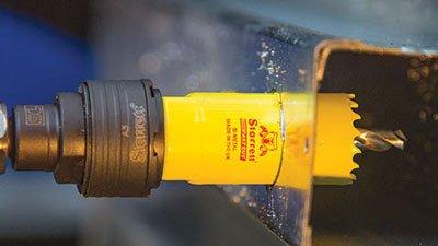

Onoff Posted May 2, 2021 Share Posted May 2, 2021 Skirting was traditionally affixed with bfo iron clasp nails. If you "rip" the skirting off you can end up taking bits of the wall with it and areas of plaster. I have a few times managed to identify where the clout nails are and drilled them out using a 14mm Starrett hole saw with the pilot drill removed. You just sort of jam the teeth over the nail head and drill. Just be careful ref hidden pipes/cables. Another alternative is over skirting. https://mdfskirtingworld.co.uk/skirting-boards/scotia-mdf-skirting-board-cover/ Tbh you can make this up from taller, ordinary skirting and a batten panel pinned to it. Guaranteed you'll have a gap to the wall in places. Use flexible decorating caulk in a mastic gun. I used to brush it in with a wet paintbrush then square off with an old credit card. Link to comment Share on other sites More sharing options...
