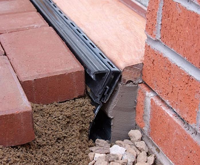

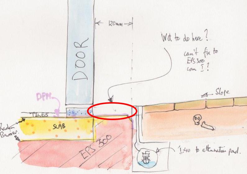

ToughButterCup Posted April 29, 2021 Share Posted April 29, 2021 Digging out the drain ( threshold drain) for the footpath to our front door made me look again at an issue that I should have thought about years ago: since there's an EPS300 block keeping the side of the slab warm, what am I going to put in the gap between the threshold drain and the front door? Have a look; The red elipse is the area that concerns me: its 120mm wide. It concerns me because I can't fix anything to it can I? Or can I ? Ideally, I'd like something like this, but as the image shows, there's a nice hardwood threshold which - presumably is fixed to summat underneath. I note that the wooden threshold has a drip channel which is more suited to woodlice in search of a good night's sleep ... but thats not the issue. (image stolen fair and square from Wavin https://www.externalworksindex.co.uk/entry/34545/Wavin/Threshold-drains/ ) What I need is a cunning plan. Have you got one? Link to comment Share on other sites More sharing options...
markc Posted April 29, 2021 Share Posted April 29, 2021 what are you using as a floor finish? It would look so much neater if the floor finish continued over the EPS to door 1 Link to comment Share on other sites More sharing options...
ToughButterCup Posted April 29, 2021 Author Share Posted April 29, 2021 Tiles: and luckily they are suitable for outdoor use. ( We will be using them outside in our Winter Garden) What a bloody good idea. I suppose the tiler would know how tiles could be fixed to the EPS300? Link to comment Share on other sites More sharing options...
markc Posted April 29, 2021 Share Posted April 29, 2021 Yes the tiler should have a good idea, just needs to be a tough but remains elastic construction adhesive. Link to comment Share on other sites More sharing options...
ToughButterCup Posted April 29, 2021 Author Share Posted April 29, 2021 Good 'ol CT1 then.... Link to comment Share on other sites More sharing options...

Conor Posted April 29, 2021 Share Posted April 29, 2021 I'm in exactly the same position. Architect suggested extended door sill all the way out... But I don't think the EPS will take the abuse. I'm thinking of losing 100mm of the EPS and filling with concrete down. It's not a major cold bridge... 1 Link to comment Share on other sites More sharing options...

Conor Posted April 29, 2021 Share Posted April 29, 2021 6 minutes ago, ToughButterCup said: Ahhhhh no, don't do it, the Cold Bridge Police will nab you. Doesn't building to a high standard really change your perspectives? Instead of 250mm thick insulation along a 1200mm strip, I'd have a mere 150mm. Unnaceptable!!! 1 1 Link to comment Share on other sites More sharing options...

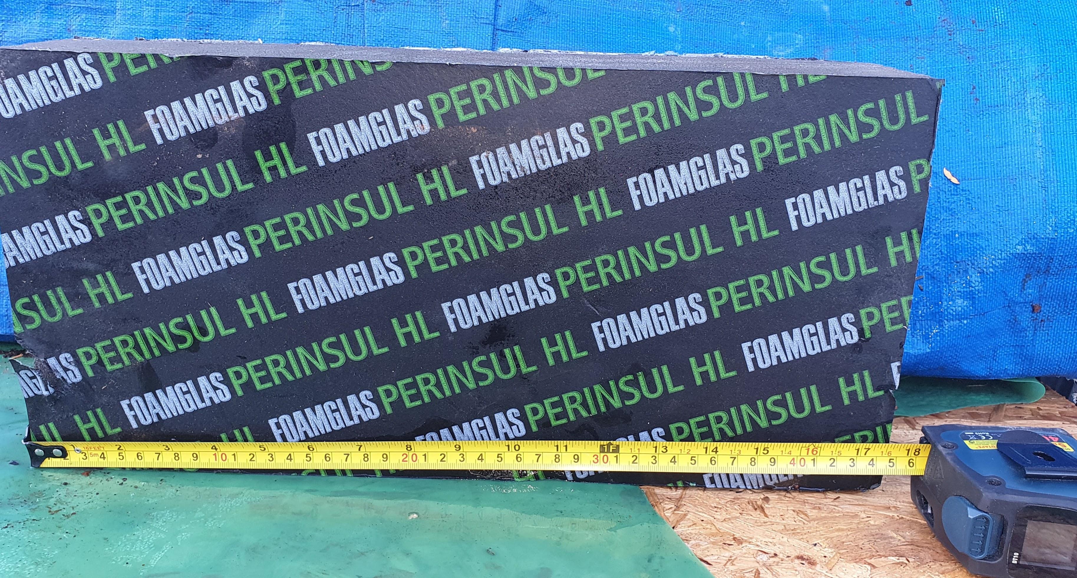

ToughButterCup Posted April 30, 2021 Author Share Posted April 30, 2021 18 hours ago, Conor said: .... I'm thinking of losing 100mm of the EPS and filling with concrete down. It's not a major cold bridge... About 3:00am. this morning, bright awake, bolt upright and grinning, the significance of @Conor's post finally got through my sludgy psyche. Thank you @Conor! I still have some of these bad boys on the stillage: we had to order them in cases of 12 - so some are left over. @Conor suggests digging out the EPS and sticking concrete in instead to support the threshold finish (tiles / wood / plastic / metal) . Well, how about dropping these Perinsul blocks in as a foundation for the threshold? I suppose I'll have to encase those in concrete to hold them in place, though ...... ? I'll have to design it in such a way that the blocks are held firmly in place, and then top those off with something that will allow me to fix the tiles in place. Or is it possible to fix (say a sheet of marine ply or similar) directly into the Perinsul blocks? Link to comment Share on other sites More sharing options...
IanR Posted April 30, 2021 Share Posted April 30, 2021 Is it too late to get the Door frame over the EPS upstand, and aligned with the insulation? We used a 9.5mm thick GRP L Section (www.steponsafety.co.uk), sitting on top of the EPS upstand to support the door and window frames. Ours was put in before the slab pour, but they could be fitted after. This threshold is within a covered porch, so we went without the drain, but did tip the outside surface away from the opening by 1°. 1 Link to comment Share on other sites More sharing options...
