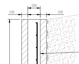

For the retaining walls on site the design is a 200mm filled cavity block work wall as below.
I need to get the wall ties for this construction, which need to be 325mm to be embedded a min 50mm within each leaf.
I am looking for a cost effective tie to buy which doesn't need to be special as they are going to be embedded in the concrete fill.
They only need to hold the leaves together of the pressure when the concrete is poured. The ancon ST1 comes in 325mm but are expensive, and given the use in the filled wall they seem over kill.
Any ideas?

The SE spec says embedded a min 50mm into leaves, and its a 200mm cavity. So a 300mm tie would meet the spec and are available at a much more palatable price (£64 for 250)

As they are embedded in concrete i would be using good quality stainless ties. The interface between concrete and blocks is a prime corrosion point. Re-bar is ok unprotected because it is fully encased in concrete at all times. The ties will still be holding the inner and outer block work together long after the concrete has set.

Normally you'd build the RC wall first with formwork and use stainless steel frame cramp type ties into the concrete.
Are you intending to use the brick/block as a permanent formwork? You will need to support the wall as the lateral force from the concrete would potentially burst the wall.
I think you need to go back tot he designer and ask them how they intended for this to be constructed.

What you have looks like a reinforced masonry retaining wall. I assume you are using dense concrete blocks not aerated.
Nice to see them being used, a bit like timber flitch beams which seemed to go out of fashion for a bit, like bell bottom / flared trousers.
Yes 325mm ties to allow for construction tolerance so you get your min 50mm embedment.
Peter has suggested (I think) using A142 on the flat to create the wall ties. I would maybe give this a swerve as the blockwork is more porous to moisture and air than well compacted concrete. I think this risks corrosion of the A142 in the blockwork courses. The issue here would be that when steel corrodes it expands and can exert a huge expansive force on the masonry which could damage it. This effect can be seen on historic buildings where iron straps, cramps etc have been built into the stonework resulting in disappointment.
I'm curious as the cavity fill is quite thick.. I wonder if the wall is fairly high for a reinforced masonry wall or if you have a clay soil that has a low shear strength. By that I mean a clay soil say that is pretty soft thus exerts a fair bit of lateral pressure on the wall. I can see that the ground slopes up from the wall so this tends to add lateral load to the wall too. I would be interested to see the detail of the rebar at the base of the wall and how the base is working.

Moonshine..One key thing is that you need to make sure that you keep the inside of the blocks clean, no chucking the washout from the mixer down the cavity, letting soil fall into it. Also make sure the brickie does not butter up the inside of the cavity as you want the inner face of the blocks as rough and clean as you can to make all work. Keep the blocks moist when pouring the concrete as you don't want them to suck the water out the concrete on a hot summers day which will encourage the concrete to debond from the blocks.
