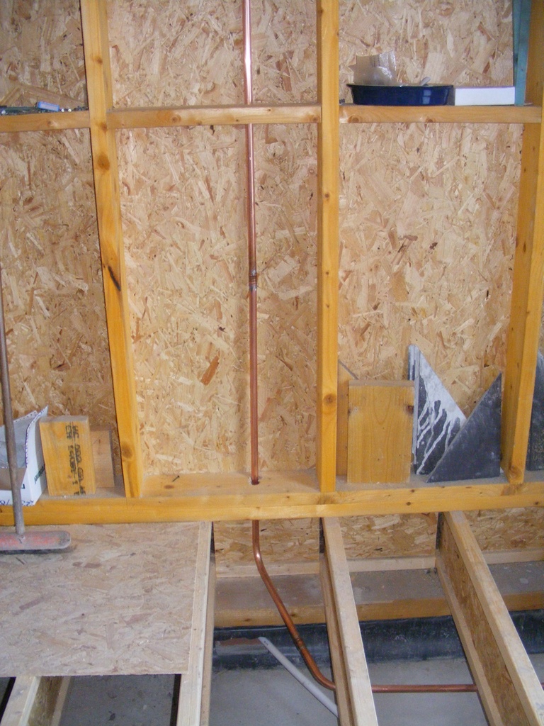

ProDave Posted February 24, 2017 Author Share Posted February 24, 2017 It will be pretty much straight down vertically 3 metres from the tundish (VERY slight set then opposite set in the pipe to kick it out from the wall very slightly so I am ignoring that) then 90 degree bend, 0.5 meter horizontal * , 90 degree bend 1.5 metre horizontal out through wall, 90 degree compression elbow (as I am not trying to solder there) * All "horizontal" runs will be set to a slight fall. All bends apart from the last elbow formed in the Hilmor. The final horizontal / slight fall section is just to ensure the pipe comes up through the floor in front of where the cylinder will go. I could shorten that if I had to and have the pipe rise up closer to the front wall and come up alongside, rather than in front of the cylinder. Link to comment Share on other sites More sharing options...
Nickfromwales Posted February 24, 2017 Share Posted February 24, 2017 22mm will be ample if there's no immediate invert. They're what cause the problems. ? Link to comment Share on other sites More sharing options...

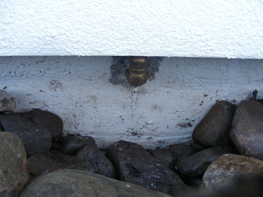

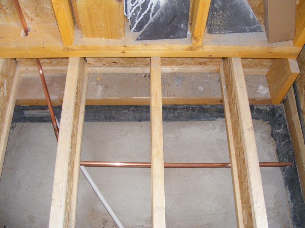

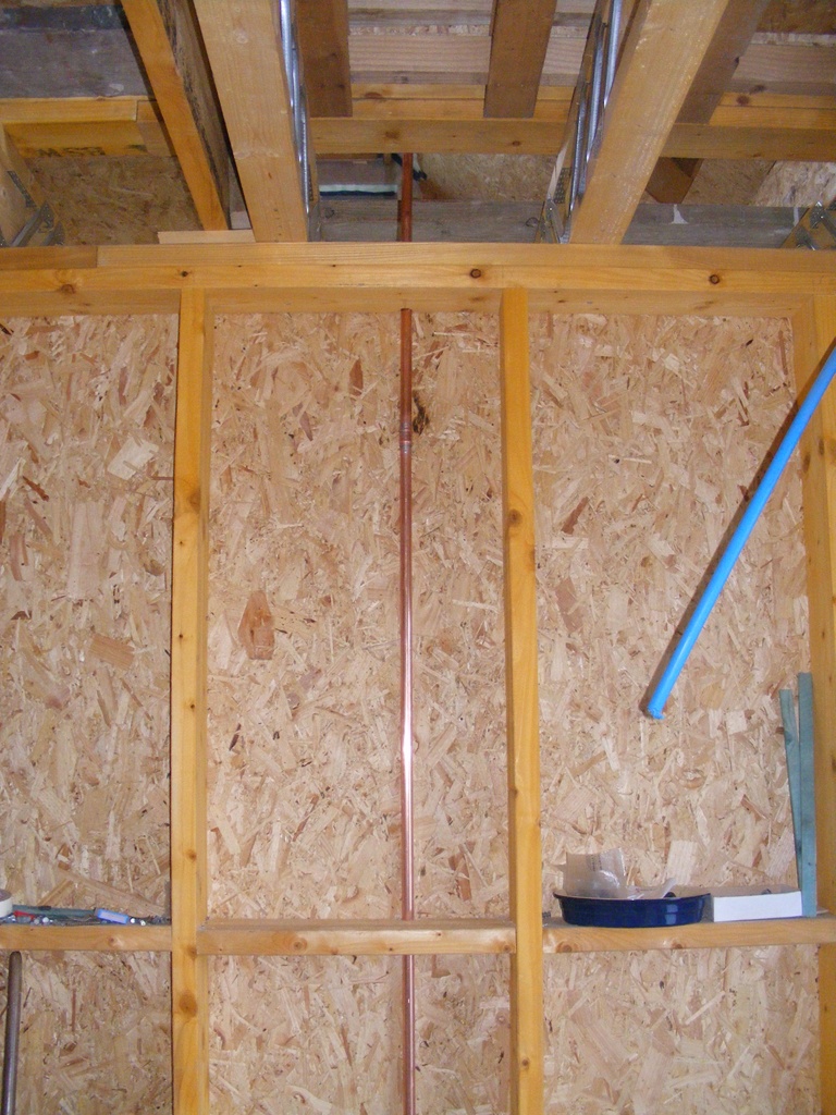

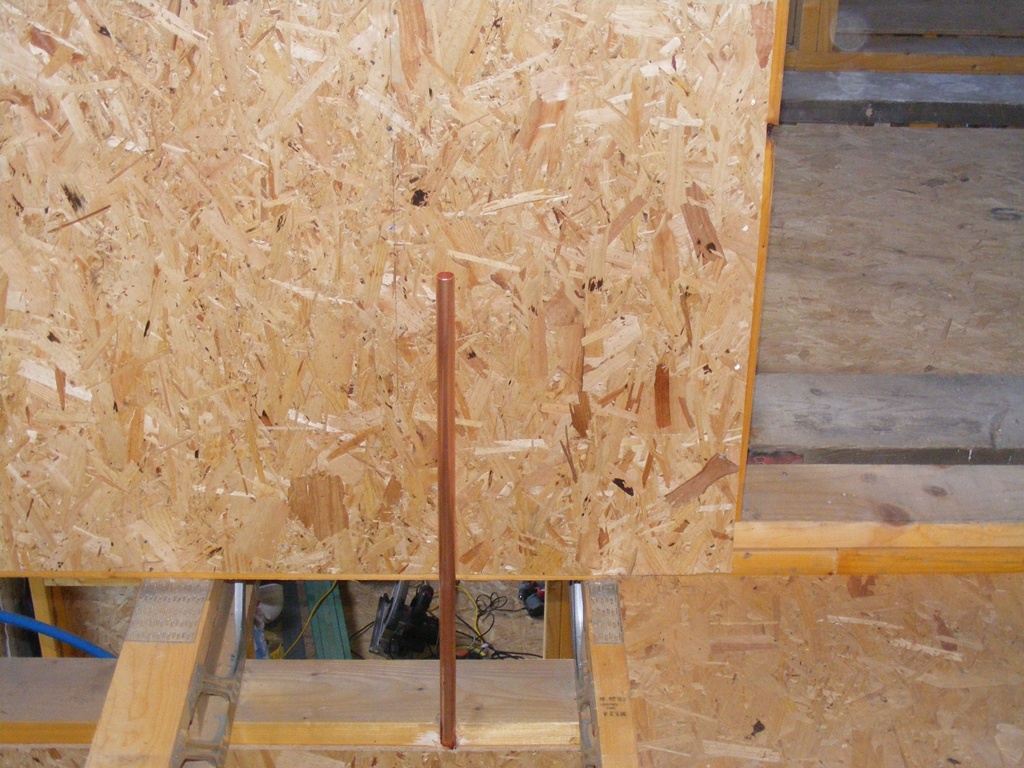

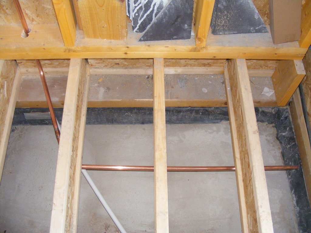

ProDave Posted February 25, 2017 Author Share Posted February 25, 2017 Here you go: The pipe starts in what will be the airing cupboard, 400mm above the floor. I expect the tundish to fit straight onto this. Then it runs down inside an internal wall Then under the floor and out through the wall just under the sole plate Where it discharges into the French drain around the house with a short discharge pipe down into the stones so you can't put your finger under it. All under the overhang of the EWI I have ran the hose into it and it runs free without backing up and discharges with a satisfying gurgle into the French drain. 5.5 metres of pipe, 3 bends @ 0.8M per bend = 7.9 metres. Even if you counted the very slight set to kick it out from the wall as another "bend" it would still just be okay at 8.7 metres. Link to comment Share on other sites More sharing options...
Nickfromwales Posted February 25, 2017 Share Posted February 25, 2017 Eeeep. Its 'supposed' to terminate 100mm above ground level so damp leaf litter etc can't surround it and freeze. I'll understand if you don't speak to me ever again. Regs should have clearly stated that the discharge should be clearly visible ( as it would be discharging potable water ) as it would be with the overflow from a CWS. I'll get my coat and hat. Link to comment Share on other sites More sharing options...
ProDave Posted February 25, 2017 Author Share Posted February 25, 2017 I thought it said it MUST discharge below ground level so nobody could put a finger under any potentially scalding hot water running out of it. it mentions discharging below the grid of a gulley, or onto a pavement IF a wire cage was fitted around it to prevent anyone touching it. I could locally reduce the ground level there by lowering the height of stones in the French drain so the pipe is exiting 100mm above the "ground". I could install a gulley with a grid with a hole in it if it would look the part better. What I cannot do is raise the point of exit any higher up the wall. Re reading the document I linked in my original post it says "Downward discharge at low level but no less than 100mm above external surfaces and having a wire cage or suitable guard to prevent contact" So if I shorten the pipe out of the bottom of the elbow to almost nothing, lower the level of stones so the pipe is 100mm above the stones, and fit a wiore cage it should comply? I better not start putting the floor down yet...... Link to comment Share on other sites More sharing options...
Nickfromwales Posted February 26, 2017 Share Posted February 26, 2017 If it's not too tight, just remove the elbow and solder on an M&F bend so you have your down turn with near zero length. It allows termination below the grid of a gulley because it's assumed that the water level will still always be lower. I personally don't like that option as there is, IMO, more chance of blockages by leaf litter / other causing freezing issues. The end of the pipe getting blocked is the number one concearn. Link to comment Share on other sites More sharing options...

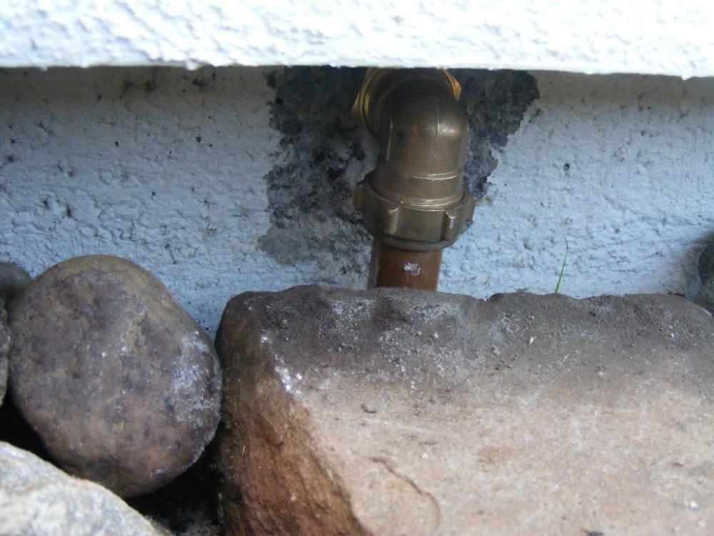

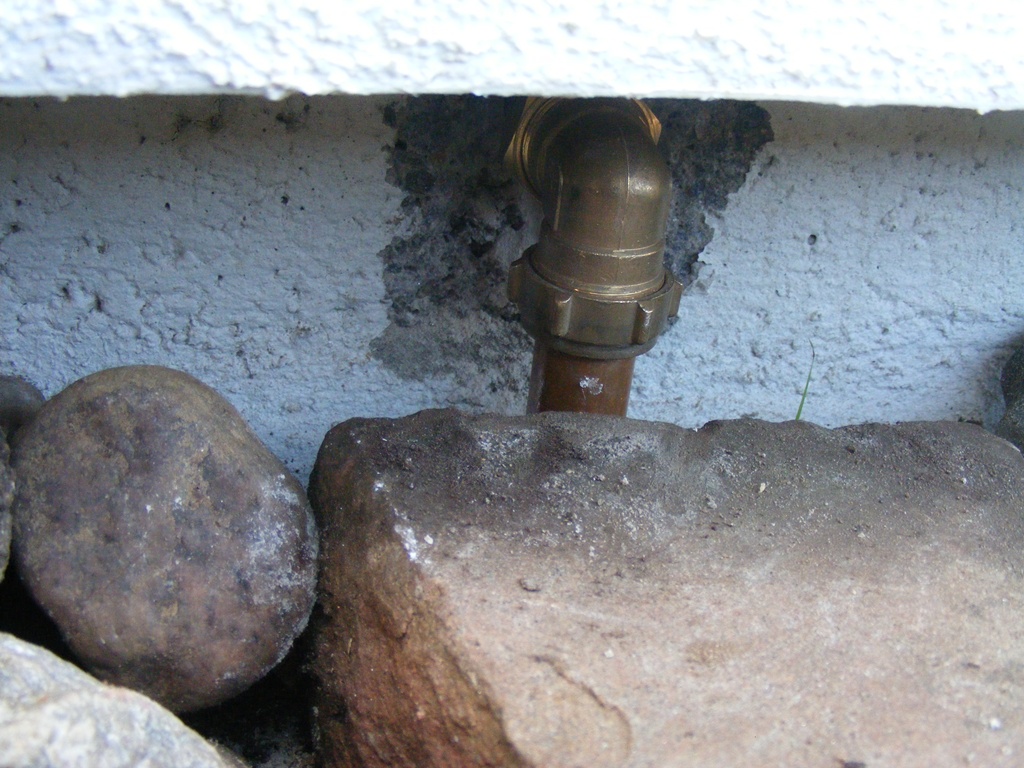

ProDave Posted February 26, 2017 Author Share Posted February 26, 2017 Here we go, take 2. A very short pipe out of the elbow (too tight to solder in there with the overhanging EWI on a plastic support bracket). Ground level lowered so there's more than 100mm gap. All I need now is a wire cage to go round it. Any ideas where I can buy one? I was originally thinking of the hepvo and into the stack, but it would have been a long run to get to the stack and very congested to get yet another pipe into it, so I changed to a copper D2 pipe but wanted it hidden, unlike the present house where it runs down the outside wall of the house. Yes I know it's a compromise to the air tightness, but an almost unavoidable one. Link to comment Share on other sites More sharing options...
Nickfromwales Posted February 26, 2017 Share Posted February 26, 2017 One of these ? Cant find a small basket, and the flue ones are much bigger ( way too deep ). Maybe get some mesh from b&q and make one yourself? They sell small pieces btw, save you buying a big sheet. Link to comment Share on other sites More sharing options...

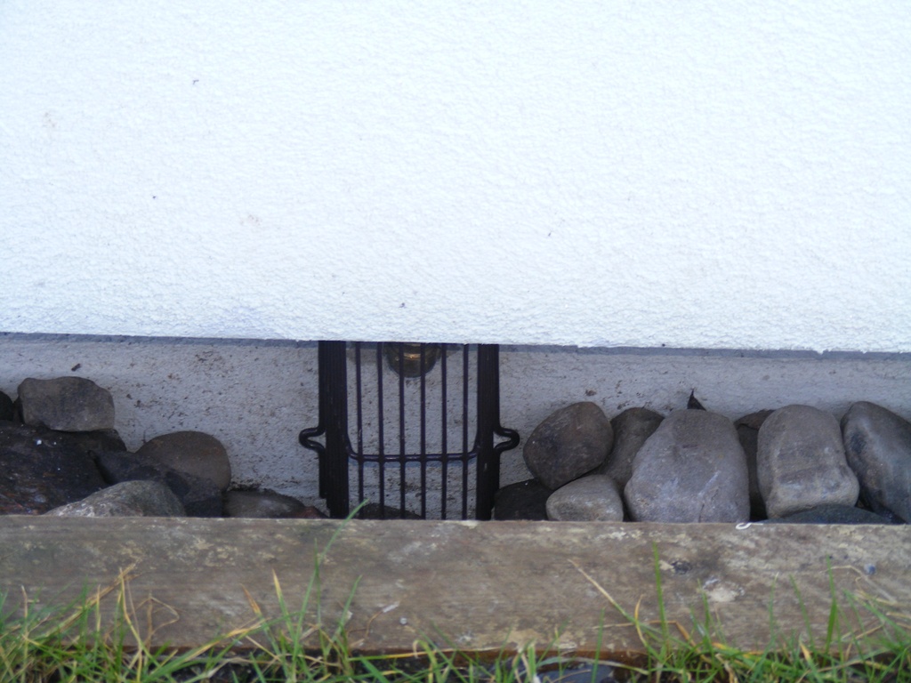

ProDave Posted February 26, 2017 Author Share Posted February 26, 2017 This cover should do the job http://www.ebay.co.uk/itm/Plastic-Coated-Overflow-Discharge-Terminal-Guard-Boiler-Relief-Outlet-Cover-Cage-/381591128473?hash=item58d89a8999:g:iSkAAOSwsN9XAktq Link to comment Share on other sites More sharing options...

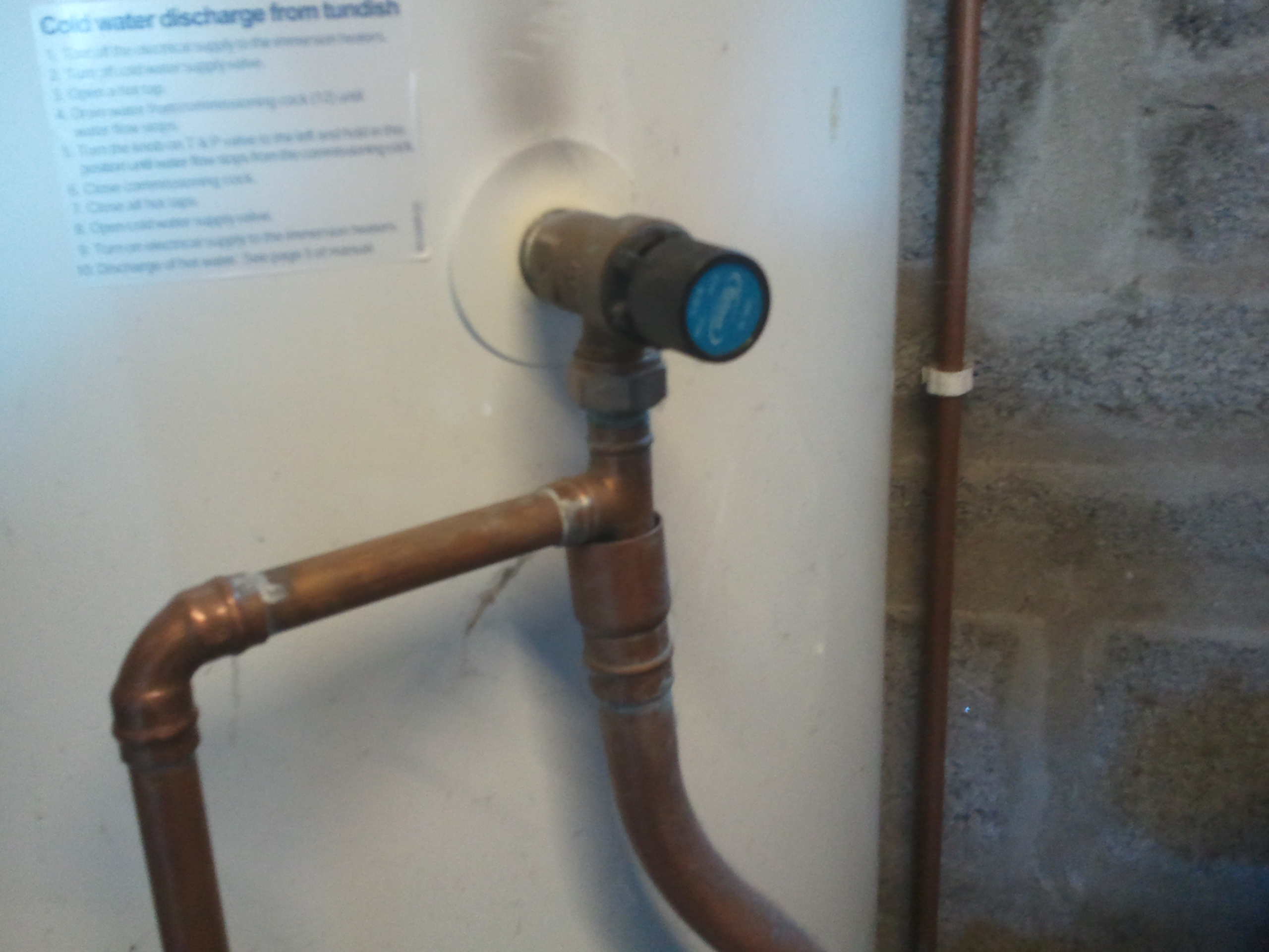

ProDave Posted February 28, 2017 Author Share Posted February 28, 2017 On the subject of who follows the rules...... I found this home made "tundish" on a job today the D2 pipe went down to the ground then along the floor with no discernible fall before exiting at garage floor level. Part way along the discharge from the boiler expansion vessel joined it with no tundish. Re my vent pipe being a chimney. I have long thought it should be possible to encase the tundish in something transparent and sealed to both inlet and outlet pipe. That would not impede the flow of water and it would still be visible, but would stop air leakage up the vent pipe. Plastic bottle or similar perhaps? Link to comment Share on other sites More sharing options...

Nickfromwales Posted March 1, 2017 Share Posted March 1, 2017 15 hours ago, ProDave said: On the subject of who follows the rules...... I found this home made "tundish" on a job today the D2 pipe went down to the ground then along the floor with no discernible fall before exiting at garage floor level. Part way along the discharge from the boiler expansion vessel joined it with no tundish. Re my vent pipe being a chimney. I have long thought it should be possible to encase the tundish in something transparent and sealed to both inlet and outlet pipe. That would not impede the flow of water and it would still be visible, but would stop air leakage up the vent pipe. Plastic bottle or similar perhaps? The pipe that rises before meeting the tee is my variation bit. Not quite a vertical fall on that bit of D1! Link to comment Share on other sites More sharing options...

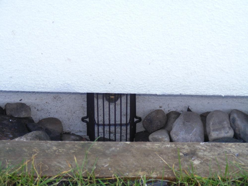

ProDave Posted March 3, 2017 Author Share Posted March 3, 2017 That wire cage from ebay fits well. Just need to screw it to the wall. Link to comment Share on other sites More sharing options...
Nickfromwales Posted March 3, 2017 Share Posted March 3, 2017 Patch the render and paint the 90 white first ? . Link to comment Share on other sites More sharing options...
