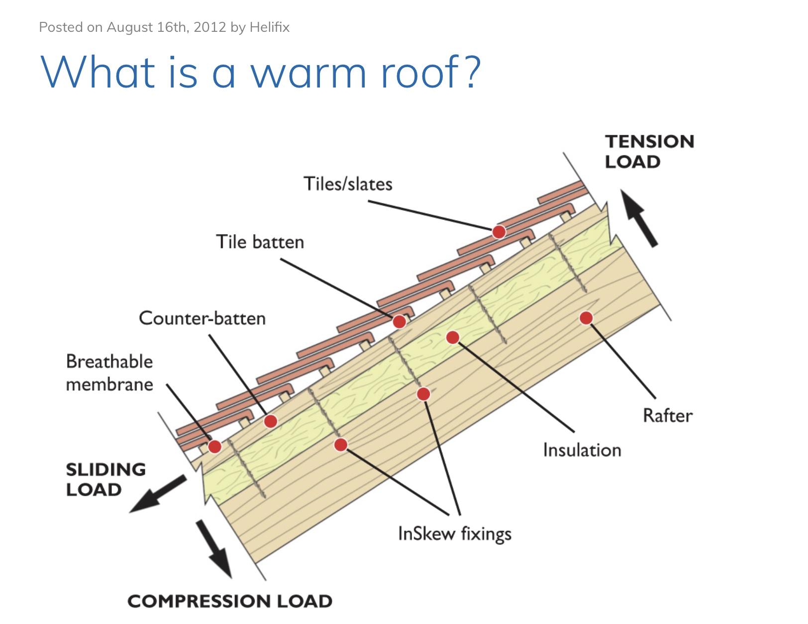

Cpd Posted April 13, 2021 Share Posted April 13, 2021 Sorry i may be operating with a dull brain today..... I interpreted your question as - you have a nice 45 degree pitched roof with exposed oak rafters and you were wondering how best to insulate the roof..., my quick response was to go external insulation.... but what I should have said was - look at external insulation for the walls and link it into a warm roof design so that all your oak can be on display. Still not sure if I have got the wrong end of the stick..... I think I just need to sleep..... https://www.helifix.co.uk/blog/warm-roof Link to comment Share on other sites More sharing options...
Lee66 Posted April 14, 2021 Author Share Posted April 14, 2021 11 hours ago, Cpd said: Sorry i may be operating with a dull brain today..... I interpreted your question as - you have a nice 45 degree pitched roof with exposed oak rafters and you were wondering how best to insulate the roof..., my quick response was to go external insulation.... but what I should have said was - look at external insulation for the walls and link it into a warm roof design so that all your oak can be on display. Still not sure if I have got the wrong end of the stick..... I think I just need to sleep..... https://www.helifix.co.uk/blog/warm-roof Thanks, not heard of this before, wasnt sure if there was some fancy insulated tile or something i had missed. I will certainly bare this in mind. Only just getting my head around the potential issues of vaulted ceilings with heat loss through timbers! Would never have thought of that in a million years. Link to comment Share on other sites More sharing options...

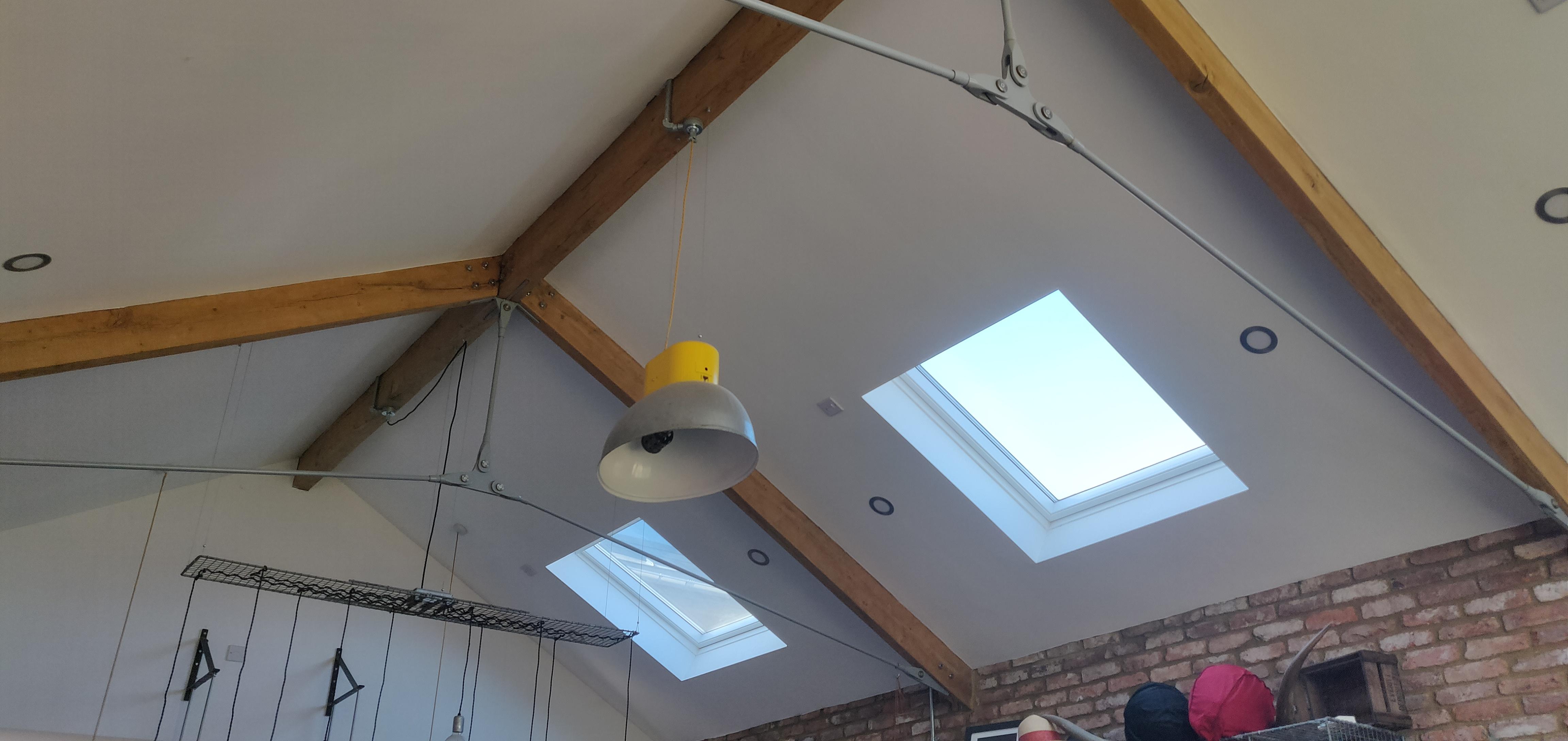

GaryM Posted April 17, 2021 Share Posted April 17, 2021 It's not quite the same, the oak and steel is structural, but above is rafters with 150mm of insulation 1 Link to comment Share on other sites More sharing options...
SimonD Posted April 17, 2021 Share Posted April 17, 2021 3 minutes ago, GaryM said: It's not quite the same, the oak and steel is structural, but above is rafters with 150mm of insulation Nice, I've always really liked oak trusses with those steel ties. 1 Link to comment Share on other sites More sharing options...
