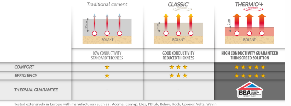

MortarThePoint Posted April 7, 2021 Share Posted April 7, 2021 The next big step for me is installing UFH and screed. For the ground floor (GF) we have used 375mm Thermobeam which has a 50mm concrete deck over 325mm of EPS. For the first floor (FF) we have used 150mm hollow core planks. We'll be using an ASHP to heat wet UFH. We had to cut blocks to establish a good coursing on the GF as the Thermobeam height control wasn't very good and so that has pinched 10-30 mm in places. Consequently, and because we have 50mm of concrete as the next layer down, I want to use a thinner screed. I have been looking at Thermio+ which supports screed depths down to around 40mm (20mm above pipes). I think I am sold on Ahydrite liquid screed over the more traditional type, though am open to persuasion. The first floor HCF is much more level, but it makes sense to use the same screed throughout. I had wondered about forgoing underfloor heating on the FF, but we are interested in using the attic space so having two floors without significant heating seems a stretch. Again this would be around 40mm thick. On thing I was wondering was about stud partitions. Should these be established (or at least their sole plates fitted) before applying screed or is it best done afterwards on top of screed? Link to comment Share on other sites More sharing options...
