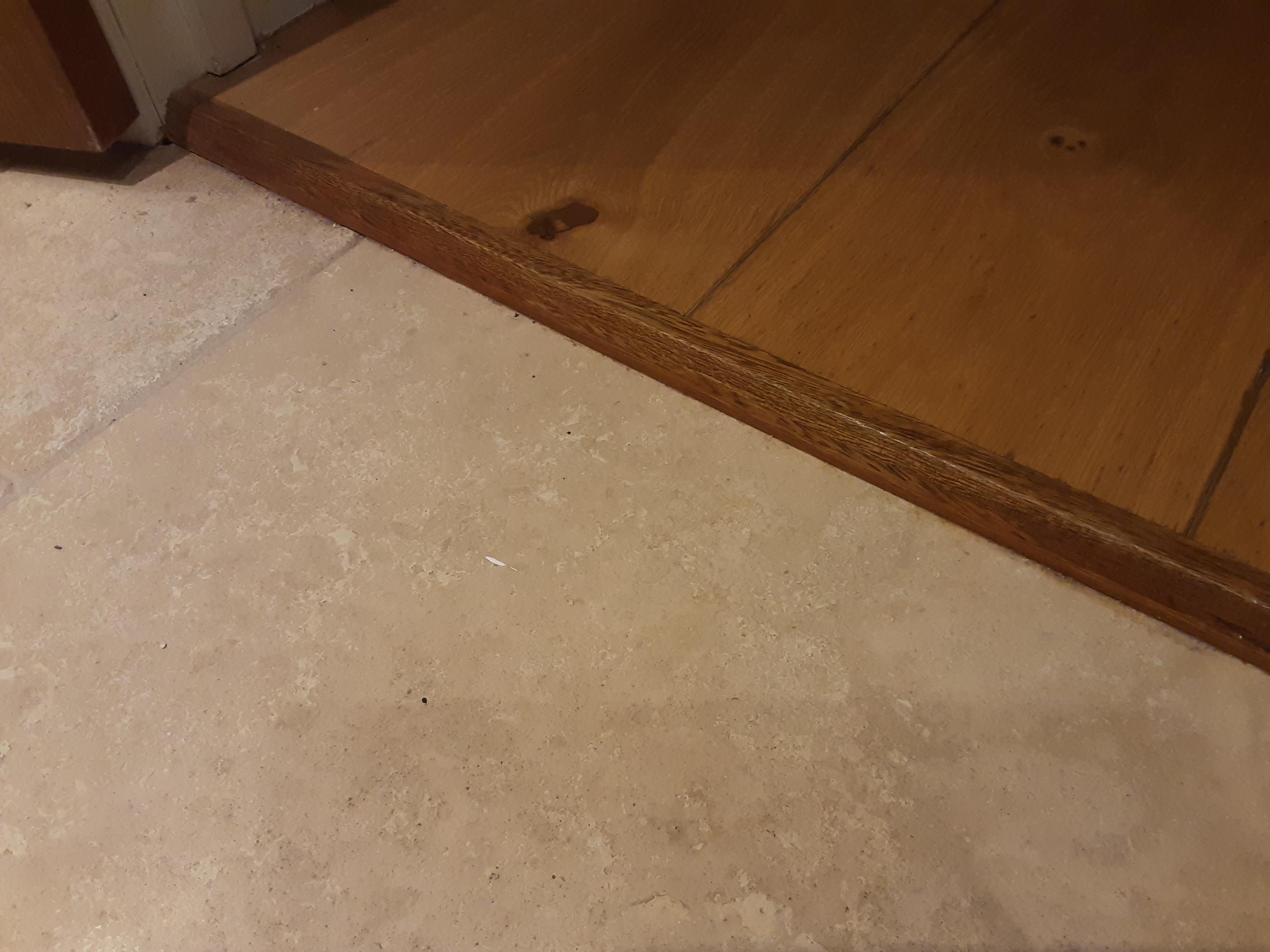

Temp Posted April 26, 2021 Share Posted April 26, 2021 Due to an error we have a 12mm step down from engineered wood on the landing to the stone floor in our bathroom. We fitted a strip of wood with a small bevel to cover the exposed edge. Works well. Dont think anyone has ever tripped on it.. Link to comment Share on other sites More sharing options...
