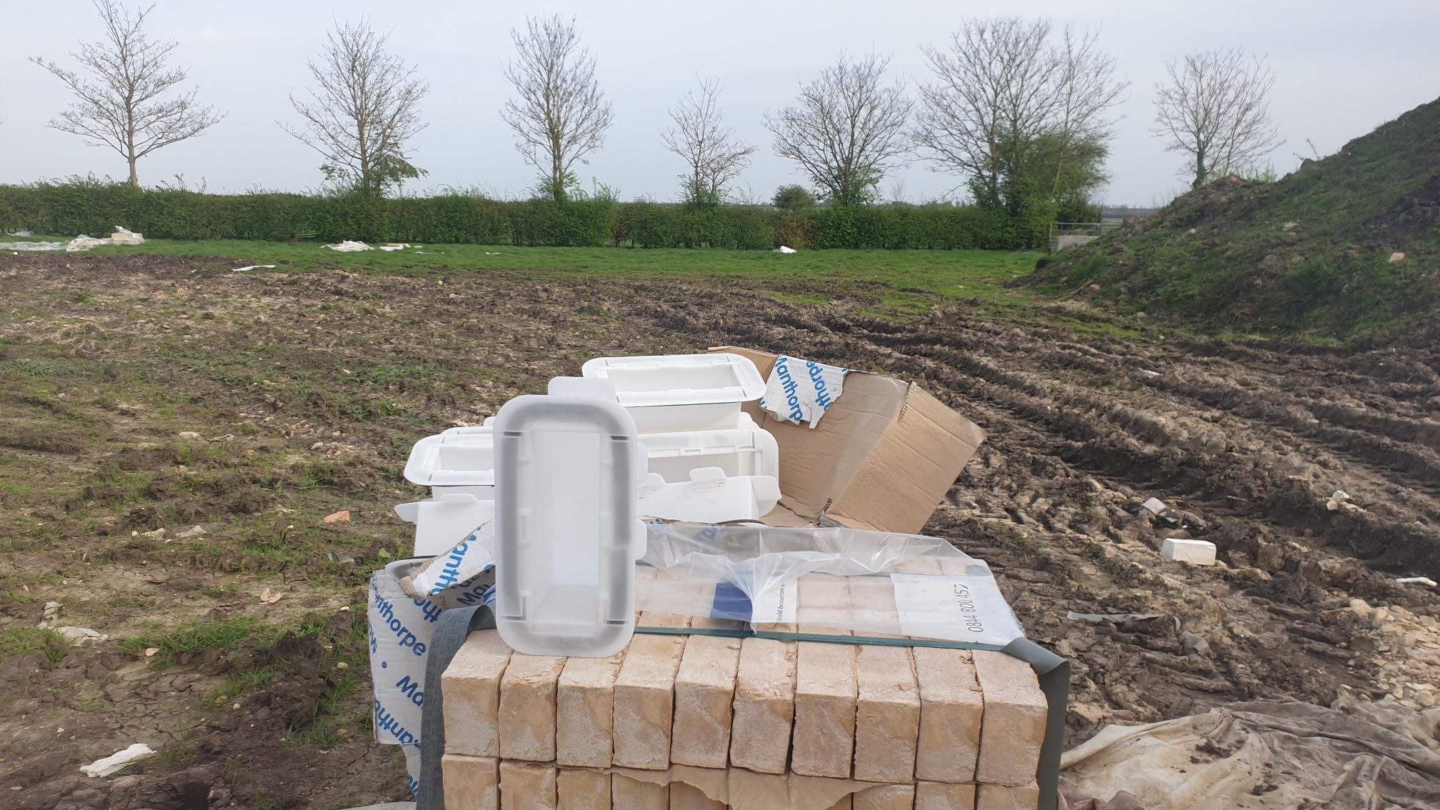

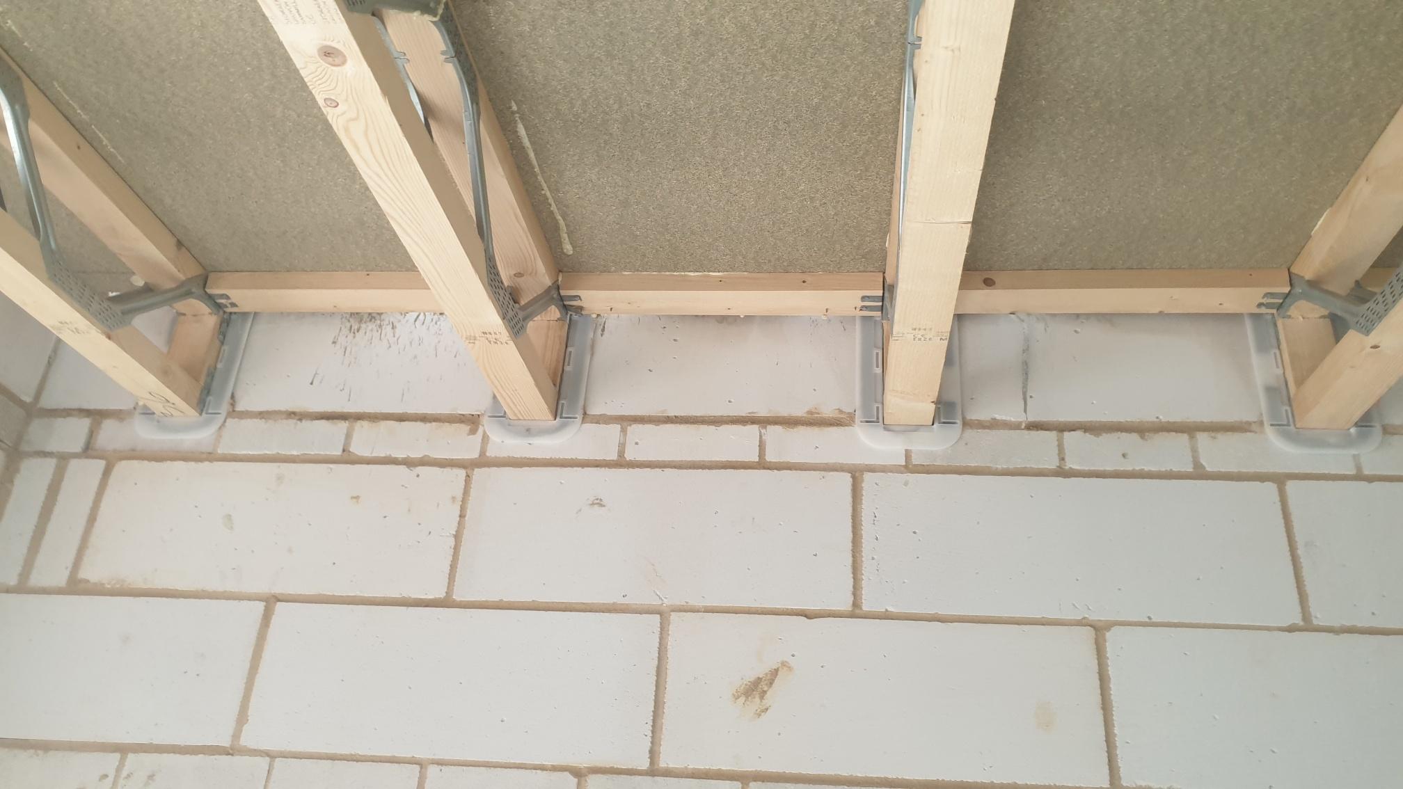

Faz Posted March 30, 2021 Posted March 30, 2021 You can use joist end caps - only cost £4/5 each depending on size. I have used them on mine and can grab some photos when back to site tomorrow if you want? These allow for the timber shrinkage and have a foam airtight seal facing the block. 1

Johnny Jekyll Posted March 30, 2021 Author Posted March 30, 2021 4 hours ago, Faz said: You can use joist end caps - only cost £4/5 each depending on size. I have used them on mine and can grab some photos when back to site tomorrow if you want? These allow for the timber shrinkage and have a foam airtight seal facing the block. Yes please photos and a website link if possible to where I can see them would be great. Thanks.

Faz Posted March 31, 2021 Posted March 31, 2021 20 hours ago, Johnny Jekyll said: Yes please photos and a website link if possible to where I can see them would be great. Thanks. Here you go mate. As you can see from the box they came from Manthorpe - the merch will be able to source them for you. The sudden summer makes life hard on site when it comes out of nowhere btw! 2
Johnny Jekyll Posted March 31, 2021 Author Posted March 31, 2021 4 hours ago, Faz said: Here you go mate. As you can see from the box they came from Manthorpe - the merch will be able to source them for you. The sudden summer makes life hard on site when it comes out of nowhere btw! Thanks very much Faz.
