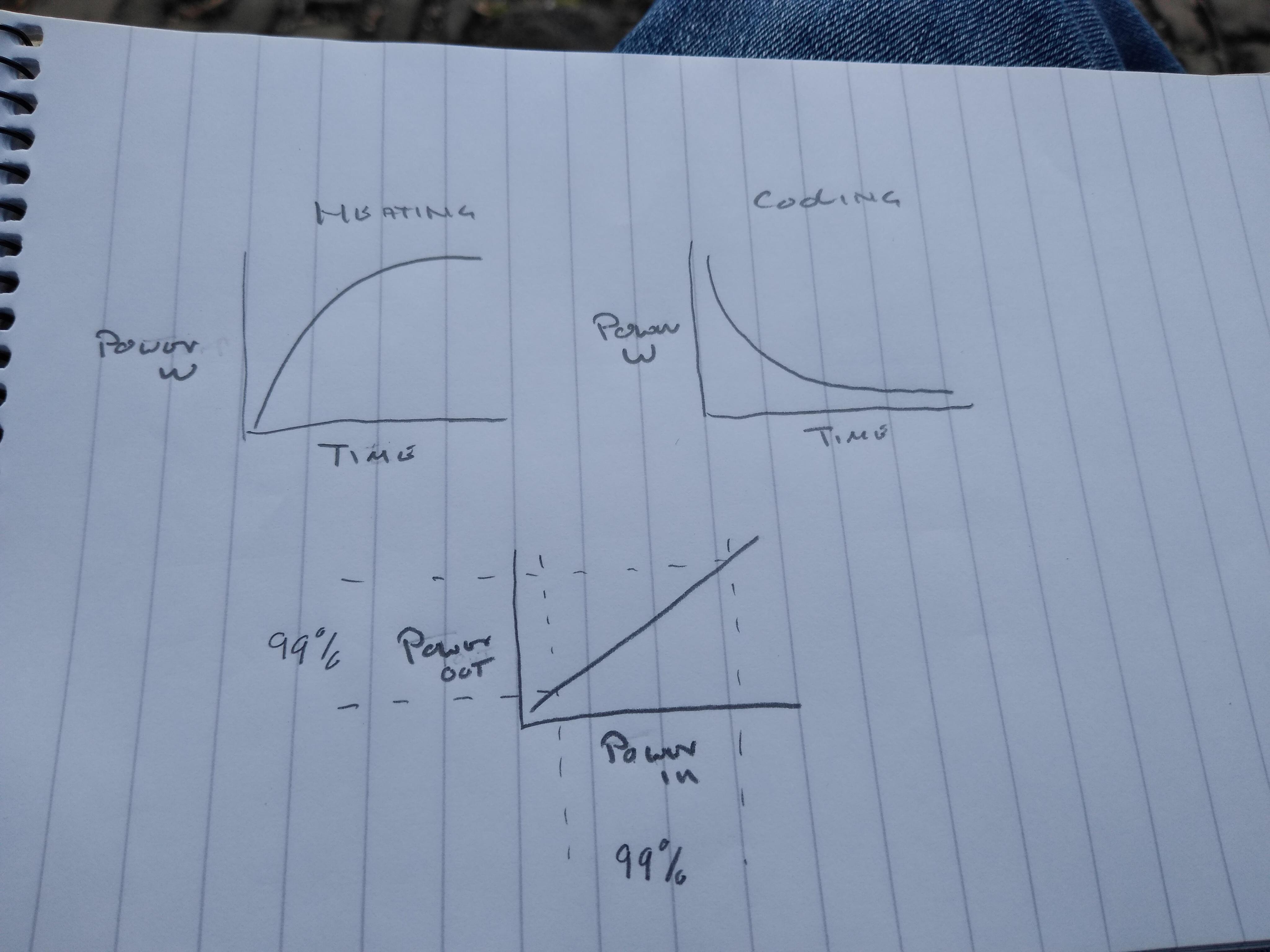

SteamyTea Posted March 31, 2021 Posted March 31, 2021 (edited) On 31/03/2021 at 06:37, Spoogster said: if you hated maths at school you might struggle Expand It is arithmetic, not mathematics. Arithmetic is pretty boring really, and easy to make a mistake, but we have speadsheets. Always remember that temperature, power and energy are not the same thing. Ideally a system would respond to external stimuli, so if the house only needed 500W to keep it at the desired temperature, the HP would modulate down to this, but when it needs 4 kW, it would deliver it, all be at a lower overall efficiency. Trouble is, life is not like that and a HP needs to run between fixed parameters of temperature and power. This is why a buffer is fitted, it allows absorption of a higher power (either though higher temperature or larger delivery volume) before it is needed. A buffer needs to be insulated just like any storage system, and it does not need to have storage at maximum temperature all the time (can't change the volume so temperature is the only variable). Microbore is the Devil's Vas Difference or Urethra, it gets blocked, and we don't want that. Edited March 31, 2021 by SteamyTea
Spoogster Posted March 31, 2021 Author Posted March 31, 2021 On 31/03/2021 at 07:48, SteamyTea said: It is arithmetic, not mathematics. Arithmetic is pretty boring really, and easy to make a mistake, but we have speadsheets. Always remember that temperature, power and energy are not the same thing. Ideally a system would respond to external stimuli, so if the house only needed 500W to keep it at the desired temperature, the HP would modulate down to this, but when it needs 4 kW, it would deliver it, all be at a lower overall efficiency. Trouble is, life is not like that and a HP needs to run between fixed parameters of temperature and power. This is why a buffer is fitted, it allows absorption of a higher power (either though higher temperature or larger delivery volume) before it is needed. A buffer needs to be insulated just like any storage system, and it does not need to have storage at maximum temperature all the time (can't change the volume so temperature is the only variable). Microbore is the Devil's Vas Difference or Urethra, it gets blocked, and we don't want that. Expand I’m so out of my depth!!!!
SteamyTea Posted March 31, 2021 Posted March 31, 2021 On 31/03/2021 at 08:44, Spoogster said: I’m so out of my depth!!!! Expand Reduce it to basics. You have a hot end, and a cold end [T]. The energy [J] travels from the hot to the cold. The shorter time it takes to do it, the more power is delivered [W]. Now you have all the units needed in thermodynamics. J is energy, W is power, s is time in seconds and T is temperature. A W is a J/s. All the rest is just metres [m] and mass [kg] to complete the system. Thinking about buffers, I suspect that there is a simple way to work out the volume [m³] from the ratio of power in and power out. Will ponder that as I stroll along the promenade to Newlyn and beyond.

SteamyTea Posted March 31, 2021 Posted March 31, 2021 @PeterW Can a buffer be sized on the difference between power in and power out. That way you can decide how long the heat source is running for. You obviously need to know the performance 'curves' of the the source and sink in different weather regimes, but these are generally matched curves, do can be converted to a linear plot quite easily I think. Then it is just a case of deciding a range in the middle of the new chart to cover 99% of the expected conditions. Shall try a sketch what I mean later. Thinking a bit more about it, may need to break convention and put time on the y axis and plot heating time against cooling time.
PeterW Posted March 31, 2021 Posted March 31, 2021 Possibly ... if you know the minimum input an ASHP can modulate down to, ignore the heat curve based on external temperatures, then you could model something. One of the issues normally is the binary response of thermostats and their hysteresis. It may be worth implementing a hi/lo type setting that only cuts in when the buffer goes below a fixed temperature and then off when it hits the high with a 10-12°C variation. That should stop short cycling but will increase temperature fluctuation in the rad flows.
Spoogster Posted March 31, 2021 Author Posted March 31, 2021 On 31/03/2021 at 10:26, PeterW said: Possibly ... if you know the minimum input an ASHP can modulate down to, ignore the heat curve based on external temperatures, then you could model something. One of the issues normally is the binary response of thermostats and their hysteresis. It may be worth implementing a hi/lo type setting that only cuts in when the buffer goes below a fixed temperature and then off when it hits the high with a 10-12°C variation. That should stop short cycling but will increase temperature fluctuation in the rad flows. Expand Just called the Daikin tech team who have been very helpful. looks like a buffer or low loss header is definitely the way forward. I am going to have to insist on one I think. The problem is that the installers on this OVO scheme appear to be budget capped so any increase in specification is coming off their margin, which isn’t ideal for them. I do know that at least one installer on the scheme has asked a customer to pay a £2k contribution as their install came to £15k. I’ve had £10.5k allowed so I’m unsure if a 7kw monoblock 410a and 250litre cylinder and install would leave any slack for a buffer and extra pump/circuit to be included. im torn here as I would like the trial to be a success and for heat pumps to be supported by the government going forward, but I get the horrible feeling installers are less concerned and could be throwing any old system in with little regard for outcome just to cash in (which in this case is like turkeys voting for Christmas). It is surely in everyone’s interest for the trial to go well....
