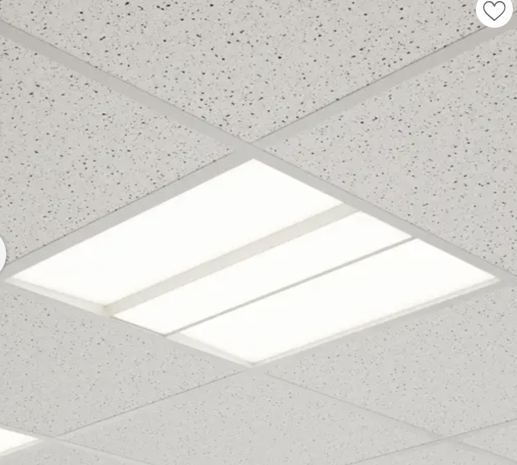

Clever hidden-but-accessible ceilings?
Especially with "Smart Homes", there are a bunch of things I'd prefer to be IN the ceiling rather than ON the ceiling.
Air quality detectors, Wifi access points, motion detectors, temperature and so on. I'd prefer them to be hidden for obvious reasons (maybe not always a great idea, can't have an air sensor be enclosed in a ceiling, but you get the idea)
But, if they break... what do - redo the entire ceiling? Not ok, I'm afraid.
Instead, of course 'office ceilings' could work but are ugly
1561908801_Screenshot2021-03-24at11_44_36.thumb.png.b654498de4c6b9a2297b8c3c4ed8d2b2.png
Are there non-ugly office ceilings?

5 minutes ago, nod said:
I do a lot of these Grid ceilings
Mainly commercial
Yup, I don't think residential owners will accept them. Even though objectively they might look 'okay' people associate them too much with stark offices so I don't think I would want this.
If instead there is some elegant near-seamless solution that does roughly the same thing, we can talk ;)

Where possible hide the stuff in the ceilings in more utility like areas (cloakrooms, utility rooms, back corridors etc) and use oversized light fittings in those areas
https://www.ledkia.com/uk/buy-placas-downlight-led/400-round-24w-ultraslim-led-panel.html
https://www.wholesaleledlights.co.uk/600x600-40w-led-panel-light.html
If you need to access the stuff in the ceilings there, you can pull the light out and get good access. I've already found the ones in our utility room useful for this on a number of occasions.
As a variation, I've nominally thought to retrofit panels like that, or basic access panels, in any locations we do have to do future maintenance in, rather than re-plasterboard the entire ceiling.
Warning: those cheap panel LED lights are not safe to connection/disconnection while powered up (at least, mine weren't). I had a pack of 10 of them, and my contractor blew up 7 before realising the issue. (The constant current drivers were over capable, and whack out a really high voltage when disconnected that fries the panel on contact)
In fancier areas, I reckon something can be done with dropped coffer/pelmets concealing some access, but we didn't manage to work that in.
Ceiling and wall speakers can also provide improvised access hatches. (Nominally my stud wall installed subwoofer doubles as access to the main bathroom soil stack, but I'd have to bust through the back box of the speaker to do that so reluctant to, but would in a pinch. It was only a cheap sub, so it'd double up as an upgrade opportunity)
