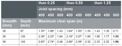

MortarThePoint Posted April 9, 2023 Posted April 9, 2023 On 07/04/2023 at 09:24, MortarThePoint said: My intuition is telling me that the moment and stress ends up along the lines of considering a joist with length equivalent to the horizontal projection (L_joist=L_stringer/COS[angle]=h_stair/TAN[angle]) of the stair and joist height equivalent to the vertical depth of the stringer (so h_joist=h_stringer/COS[angle]). Is that correct? Expand Thinking about it again, that wouldn't be right. The Joist dimensions would be the same as the stringer dimensions, but the load would be reduced by COS[angle]. So if 47x250 the span can happily be 4.47m span @600mm spacing and live load of 1.5kN/m2 / COS[30] = 1.73kN/m2. Point loading mid span two joists -> 1.73kN/m2 * (2*0.6*4.47) / 2 = 4.6kN load capacity. Very similar. 38x145 the span can happily be 2.85m span @400mm spacing and live load of 1.5kN/m2 / COS[57] = 2.75kN/m2. Scale for width 2.75kN/m2 * (27/38) = 1.96kN/m2. Point loading mid span two joists -> 1.96kN/m2 * (2*0.4*2.85) / 2 = 2.2kN load capacity. Very similar.
