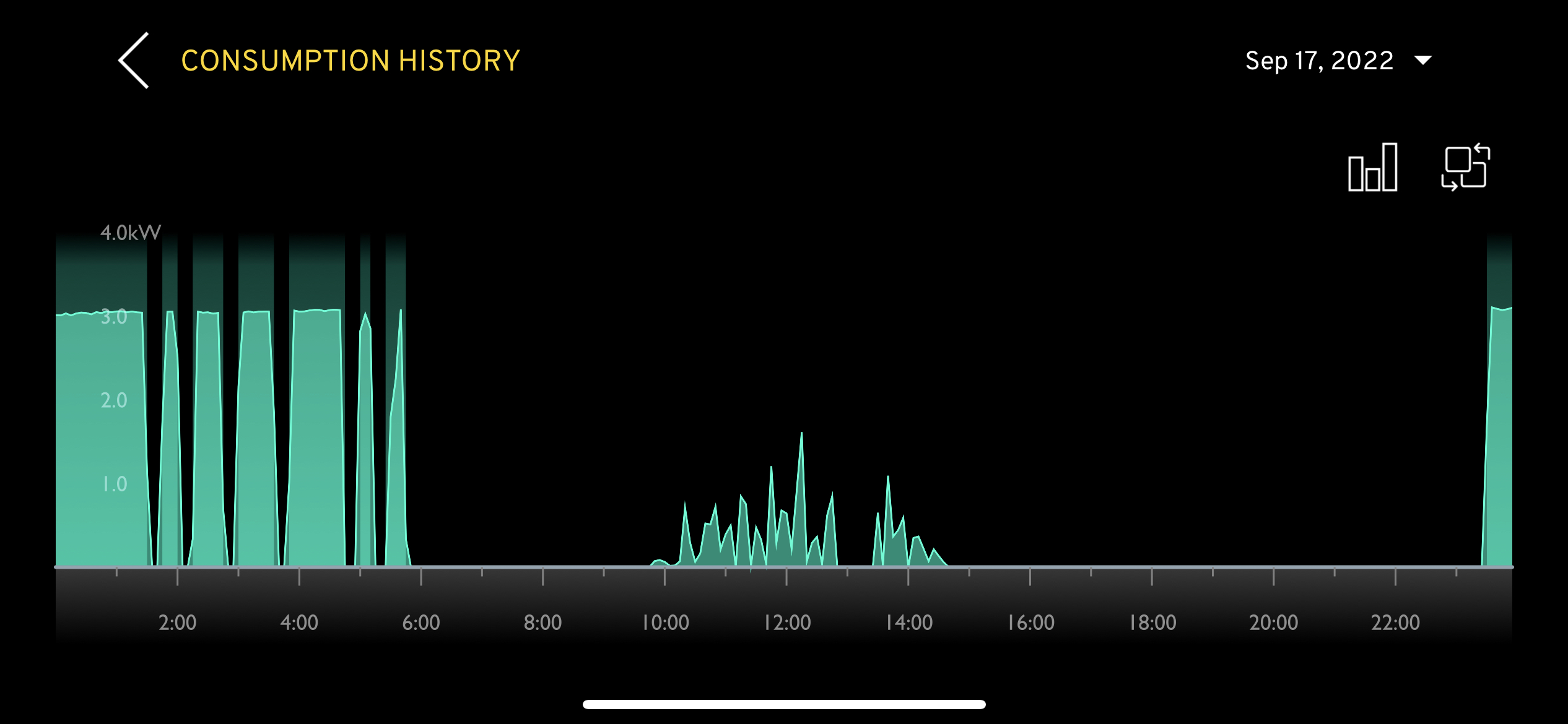

AliG Posted December 18, 2022 Share Posted December 18, 2022 Yes, this is not a practical solution. You would need 3kW spare and to be available to switch it off and on. Leaving it on for just a small amount of extra time could offset any savings. The output of solar panels is extremely variable. I picked a random day in September to display the chart from my Eddi (I only installed it in early September). I agree it is expensive, but it seems work very well. As we have Octopus at 7.5p, we also use it to heat water with the immersion during the night. Link to comment Share on other sites More sharing options...
