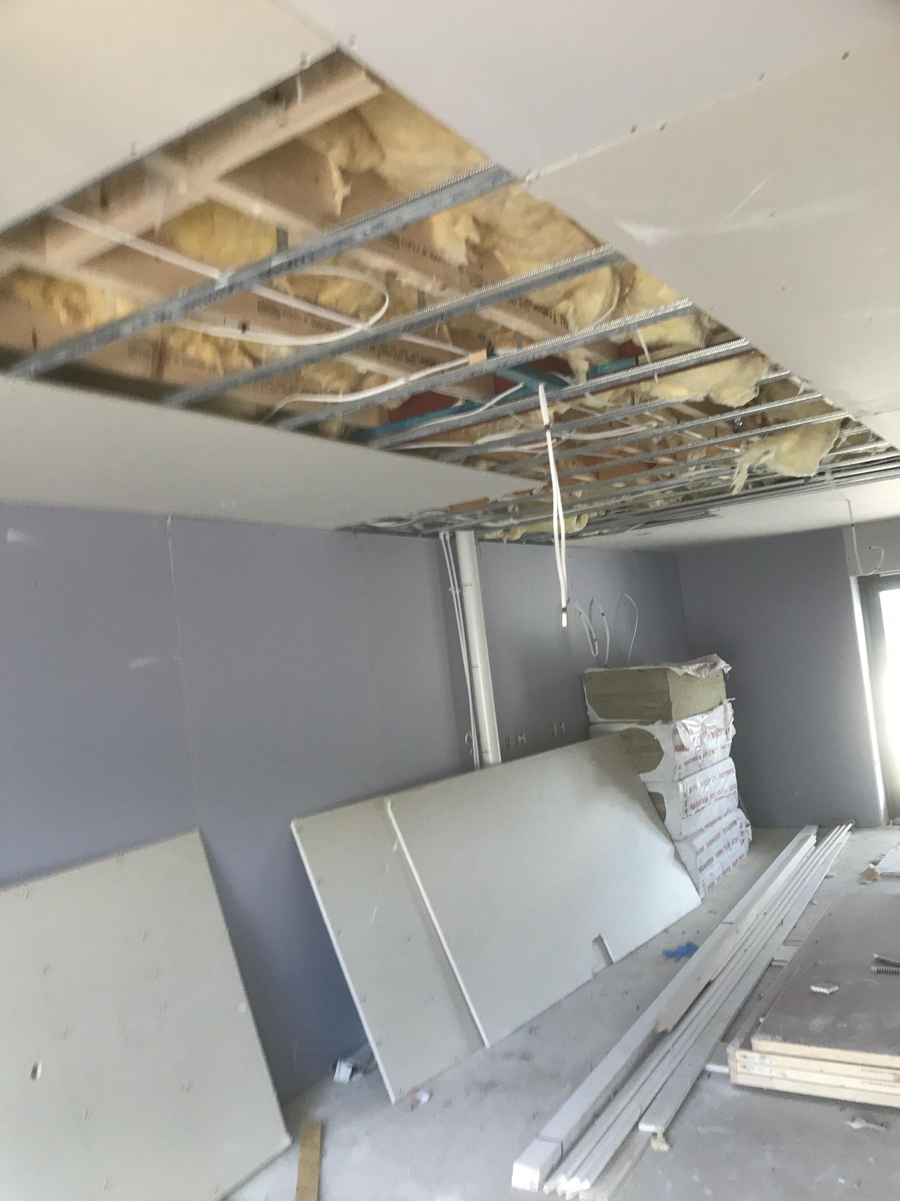

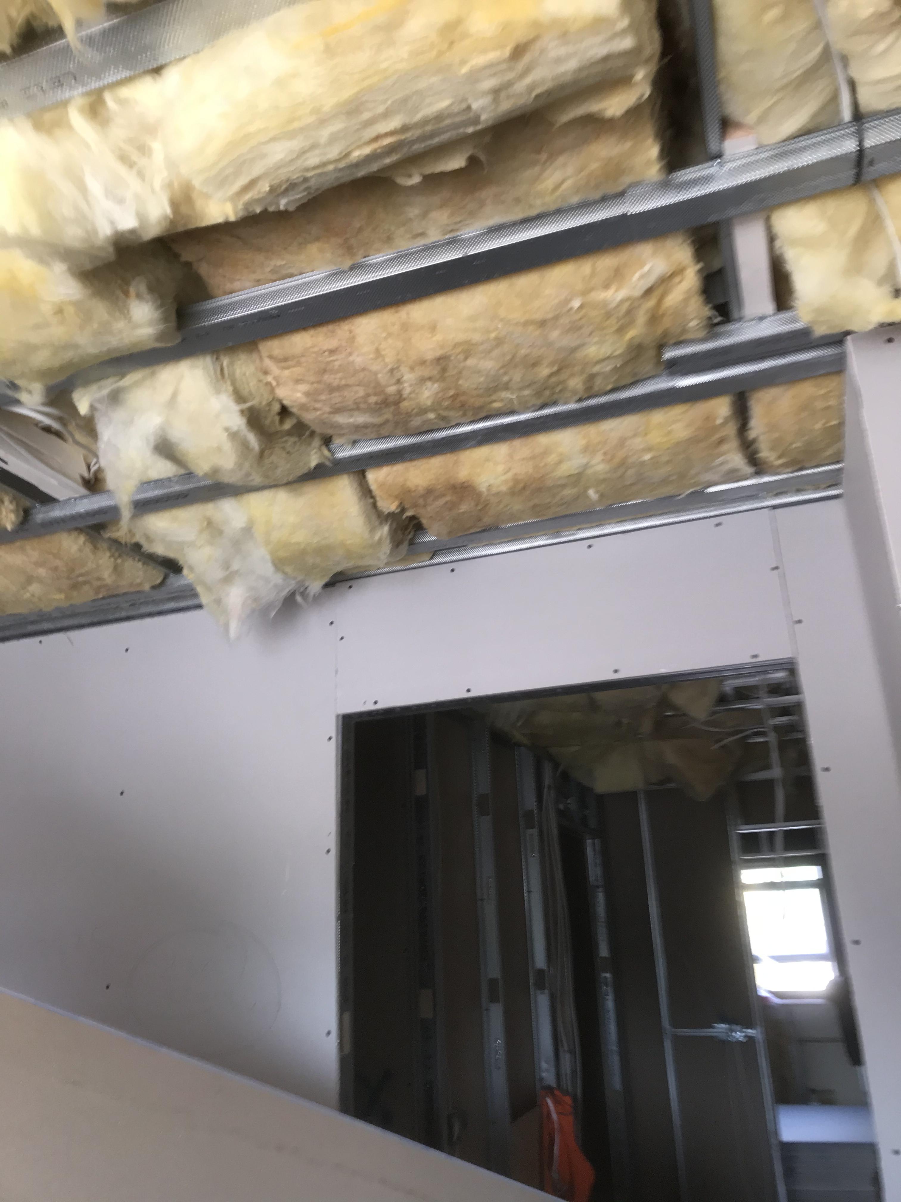

If you have looked at commercial Forget grid and tile They won’t benefit you A top hat and plasterboard can fitted loosing you125 minimum
A gyp click ceiling can be fitted loosing minimum of 60 mil
Just depends how tight for space you are

It’s a gypliner system with a clip bracket
I will see if I’ve a box knocking about and give you the code
