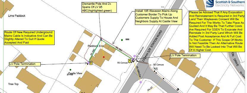

a_badger Posted March 6, 2021 Share Posted March 6, 2021 Sorry if posting in the wrong place. I am currently speaking to the wayleave dept at SSE. Short story is I have an overheard cable routed over 2 x poles on my property. Ive ownen the property for 6 months and wish to begin some development work. I wish to serve notice one just one of the poles (rear pole situated in back garden) as this pole does not benefit me, it’s sole purpose is to enable the cable to route across my garden to provide my neighbours supply. my property can quite easily be supplied via overhead cable using the pole in the corner of my driveway at the front. I started by 1st of all getting an extortionate quote for 10k to underground the cable and remove the poles. So this not being something I’m prepared to stump up for, I then began communication with wayleave (they have not been able to provide a legacy wayleave document which mentions the poles) So I have explained the situation to the assigned wayleave officer. I’ve told him I’m happy to keep the front pole in order to maintain the supply to my property but I would like the pole to the rear removed. He has informed me I can only serve noice on all equipment and not just the pole at the rear. Also he is trying to scare me off by suggesting once I serve notice my own supply will be affected and I will have to fund a new connection. can anyone confirm if this is correct? Am I only able to serve notice on all equipment hosted on my property? This really reminds me of a spoilt brat at the park running off with his football so others can’t play with it if he decides he doesn’t want to play!!! would be really grateful if anyone with similar experience can advise. cheers all! Link to comment Share on other sites More sharing options...

Bozza Posted March 6, 2021 Share Posted March 6, 2021 So my experience with SSE was excellent. Like Peter I had oversailing cables & two poles. These only supplied my property, not a third party, and to have one pole removed and the overhead supply converted to underground from the second pole. This sounds like what you needed and it cost me a nominal sum less than 2k most of which was refunded because I pulled down & disposed of the unwanted pole myself. Your main problem though is the third party supply/pole(s). Not something that I experienced but I do recall from my own research some utility suppliers do have some legal rights to place equipment, and keep equipment on private land, and lawful processes via Wayleaves. But also landowners do have some rights to have equipment removed. My research was via Telecommuncations Act as it related to getting Openreach to remove third party phone lines from said electricity poles. I expect the electricity suppliers (DNOs) will have relevant legislation in terms what they can and cannot do. You won’t need a solicitor to identify your rights (or lack of) it will be detailed in the relevant legislation which you need to research. The Wayleaves officer will tell you which Acts apply in your case. Bottom line is that they (and you) will have to follow the legislative process, whatever that is. If the Wayleaves officer is claiming you cannot be specific in which equipment you wish removed ask him to highlight the relevant section that says that. Something also sticks in my mind (but I’m not certain) that the regulators require utility companies have to have fixed prices for work eg per metre to run a line etc. To prevent overcharging. I seem to recall seeing a price list but that may have been Openreach as opposed to SSE. I would imagine your first option of paying them to reroute underground is probably them doing the trenching. If you do the trench yourself you will save a lot off their quote. A lot. If you post a copy of the SSE quotation siteplan this may assist us in providing advice, Link to comment Share on other sites More sharing options...

a_badger Posted March 7, 2021 Author Share Posted March 7, 2021 17 hours ago, Bozza said: So my experience with SSE was excellent. Like Peter I had oversailing cables & two poles. These only supplied my property, not a third party, and to have one pole removed and the overhead supply converted to underground from the second pole. This sounds like what you needed and it cost me a nominal sum less than 2k most of which was refunded because I pulled down & disposed of the unwanted pole myself. Your main problem though is the third party supply/pole(s). Not something that I experienced but I do recall from my own research some utility suppliers do have some legal rights to place equipment, and keep equipment on private land, and lawful processes via Wayleaves. But also landowners do have some rights to have equipment removed. My research was via Telecommuncations Act as it related to getting Openreach to remove third party phone lines from said electricity poles. I expect the electricity suppliers (DNOs) will have relevant legislation in terms what they can and cannot do. You won’t need a solicitor to identify your rights (or lack of) it will be detailed in the relevant legislation which you need to research. The Wayleaves officer will tell you which Acts apply in your case. Bottom line is that they (and you) will have to follow the legislative process, whatever that is. If the Wayleaves officer is claiming you cannot be specific in which equipment you wish removed ask him to highlight the relevant section that says that. Something also sticks in my mind (but I’m not certain) that the regulators require utility companies have to have fixed prices for work eg per metre to run a line etc. To prevent overcharging. I seem to recall seeing a price list but that may have been Openreach as opposed to SSE. I would imagine your first option of paying them to reroute underground is probably them doing the trenching. If you do the trench yourself you will save a lot off their quote. A lot. If you post a copy of the SSE quotation siteplan this may assist us in providing advice, Hi Bozza Thanks for the reply. I've attached a plan of the proposed redirection work. the scale is 1:500 so I calculate the work to involve 40m of underground cable. As you can see from the plan, I can quite easily take a supply to the front of my property. Leaving the rear cable for the sole purpose of supplying the neighboring property. Which is why I assumed I am able to simply serve notice on the equipment to the rear. The quote I have received is 10k and this is on the basis of excavation and reinstatement works being carried out by myself. I have also applied to the connections department to quote me on a brand new connection. So my thinking is that if this comes in significantly lower than the underground diversion quote I have some leverage over them. I can simply serve notice on all of the equipment (which I am within my rights to do and they must comply with) which I would hope, will prompt them into negotiating with me on the original underground diversion quote? Link to comment Share on other sites More sharing options...

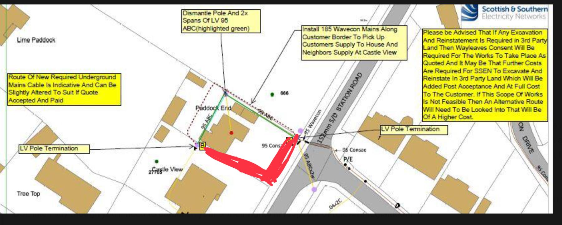

Bozza Posted March 7, 2021 Share Posted March 7, 2021 Would it be possible for you to dig a trench where I’ve marked in red. And supply conduit etc. that would involve SSE having to run the two supplies down pole A and through your trench to pole B (on neighbours land). To keep neighbour connected. Then take your supply in from that point. So your suppling a route fir your supply and a route for neighbours. as such SSE quote would be for a couple of engineers for a day and the price of the new cable runs. To do the trench conduit is cheap, as is sand. Mini digger & driver few hundred quid. Then you could approve a wayleave for SSE running neighbours supply underground along east & south perimeter of your land through your trench. Thing is regardless whether you can legally tell them to remove their equipment as far as I can see this option would give everyone what they need and fir you at a much lower cost. Link to comment Share on other sites More sharing options...
a_badger Posted March 7, 2021 Author Share Posted March 7, 2021 4 hours ago, Bozza said: Would it be possible for you to dig a trench where I’ve marked in red. And supply conduit etc. that would involve SSE having to run the two supplies down pole A and through your trench to pole B (on neighbours land). To keep neighbour connected. Then take your supply in from that point. So your suppling a route fir your supply and a route for neighbours. as such SSE quote would be for a couple of engineers for a day and the price of the new cable runs. To do the trench conduit is cheap, as is sand. Mini digger & driver few hundred quid. Then you could approve a wayleave for SSE running neighbours supply underground along east & south perimeter of your land through your trench. Thing is regardless whether you can legally tell them to remove their equipment as far as I can see this option would give everyone what they need and fir you at a much lower cost. Yes this is exactly what I proposed to be the best solution, but as mentioned in my previous post. The 10k I have been quoted is based upon me digging the trench! So all they are doing is providing the cable and removing the poles. Seems way over the top to me. Link to comment Share on other sites More sharing options...
Bozza Posted March 7, 2021 Share Posted March 7, 2021 Ok so that’s definitely expensive. Link to comment Share on other sites More sharing options...
