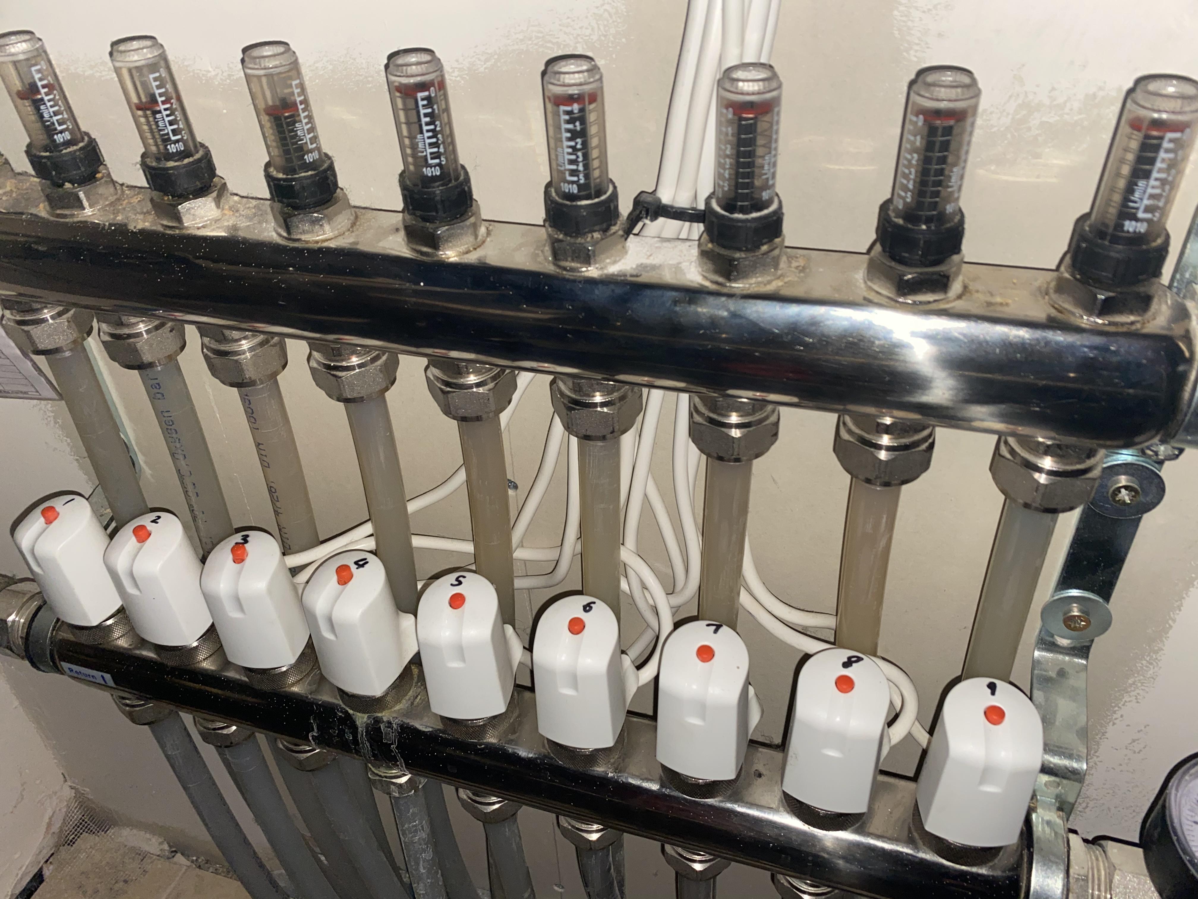

Post a picture of your under floor heating manifold and any gauges it has on or near it.
A7C4D90E-3D9C-4897-B457-2DF003D3AAB2.thumb.jpeg.1117a3dfae5ae9c3e4c60ce6236ab367.jpegSry what do you mean by crud?
I’ve had the heating engineer round and they have checked the system from that side all seems fine.

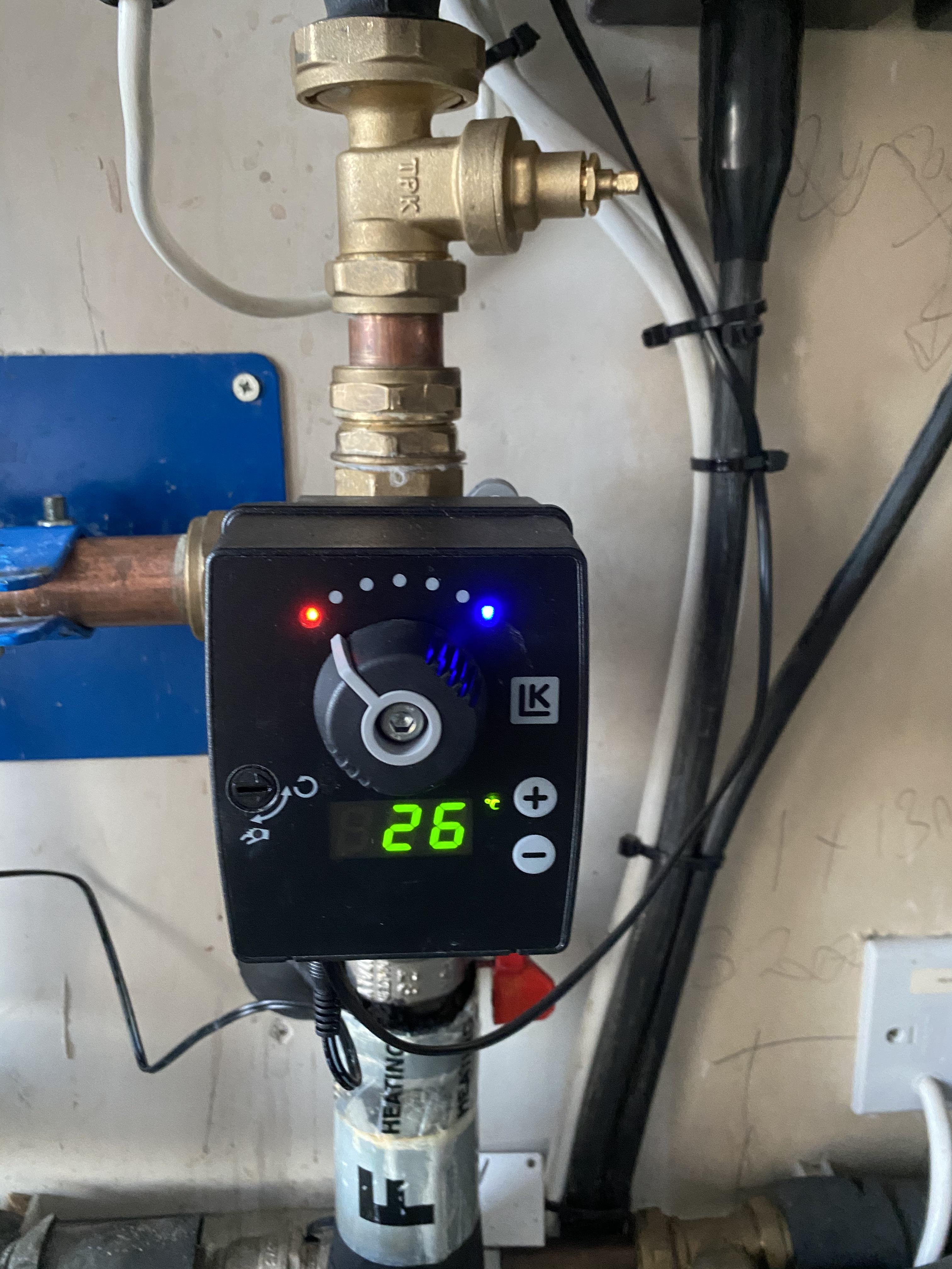

8 minutes ago, Dcc said:
Hot water is up to 50 degrees and no problem it’s just getting the temp into the UFH which is about high 20’s not the 45 it’s set to.
That points to the blending valve being at fault. Heat pump is getting to temperature.
What did they replace when you say mixing valve ..? I’ve seen them installed upside down before ...!

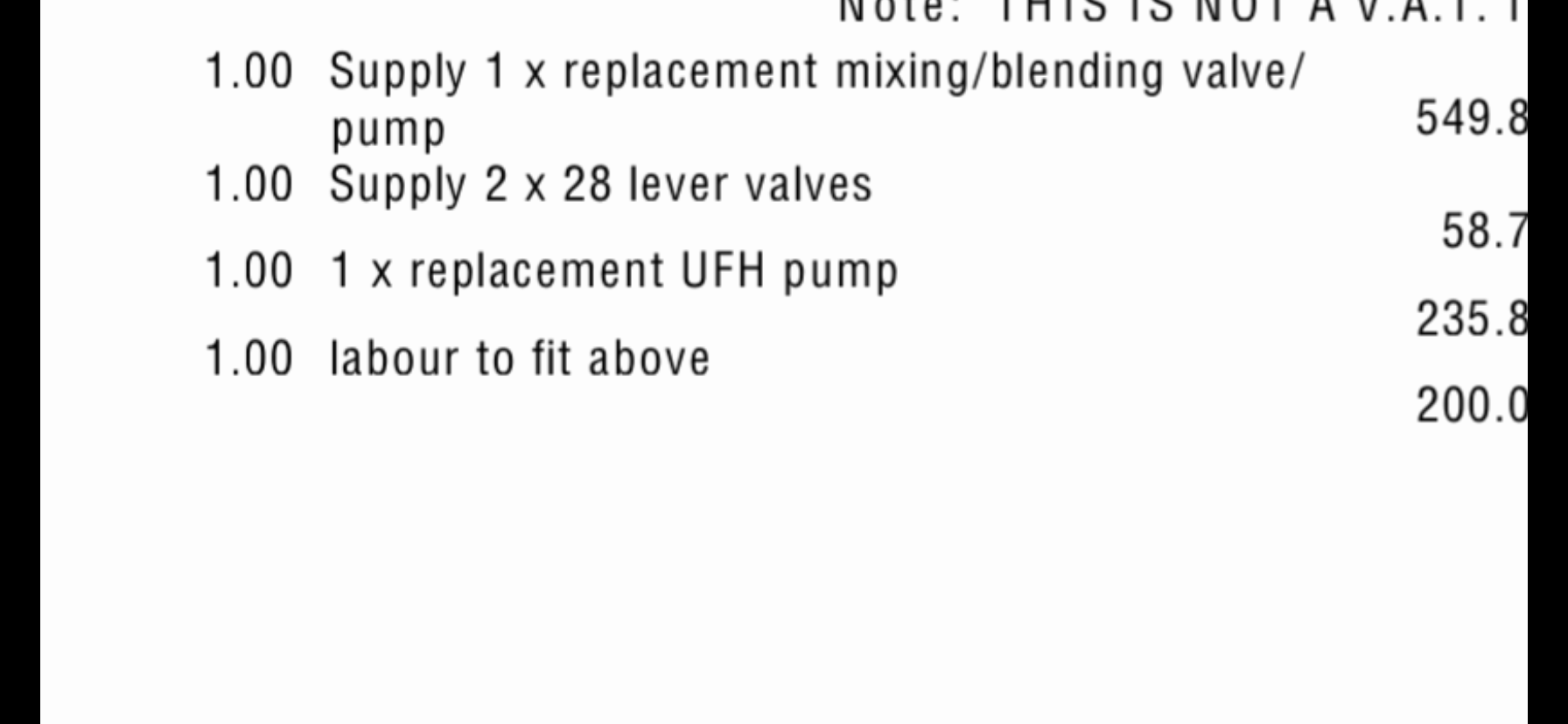

A week after the service to the outside unit they replaced the following
so the lk unit thermostat as well as the valve
Edited by Dcc
Remove pic
Are they all gold plated ..??!!! That’s eye watering prices ..!! I would be getting them back as that definitely is not working correctly.

The new thermostat/valve gets up to the 45 (temp its set to) degrees but then just drops off to low 20s (even when it’s not heating the water)
