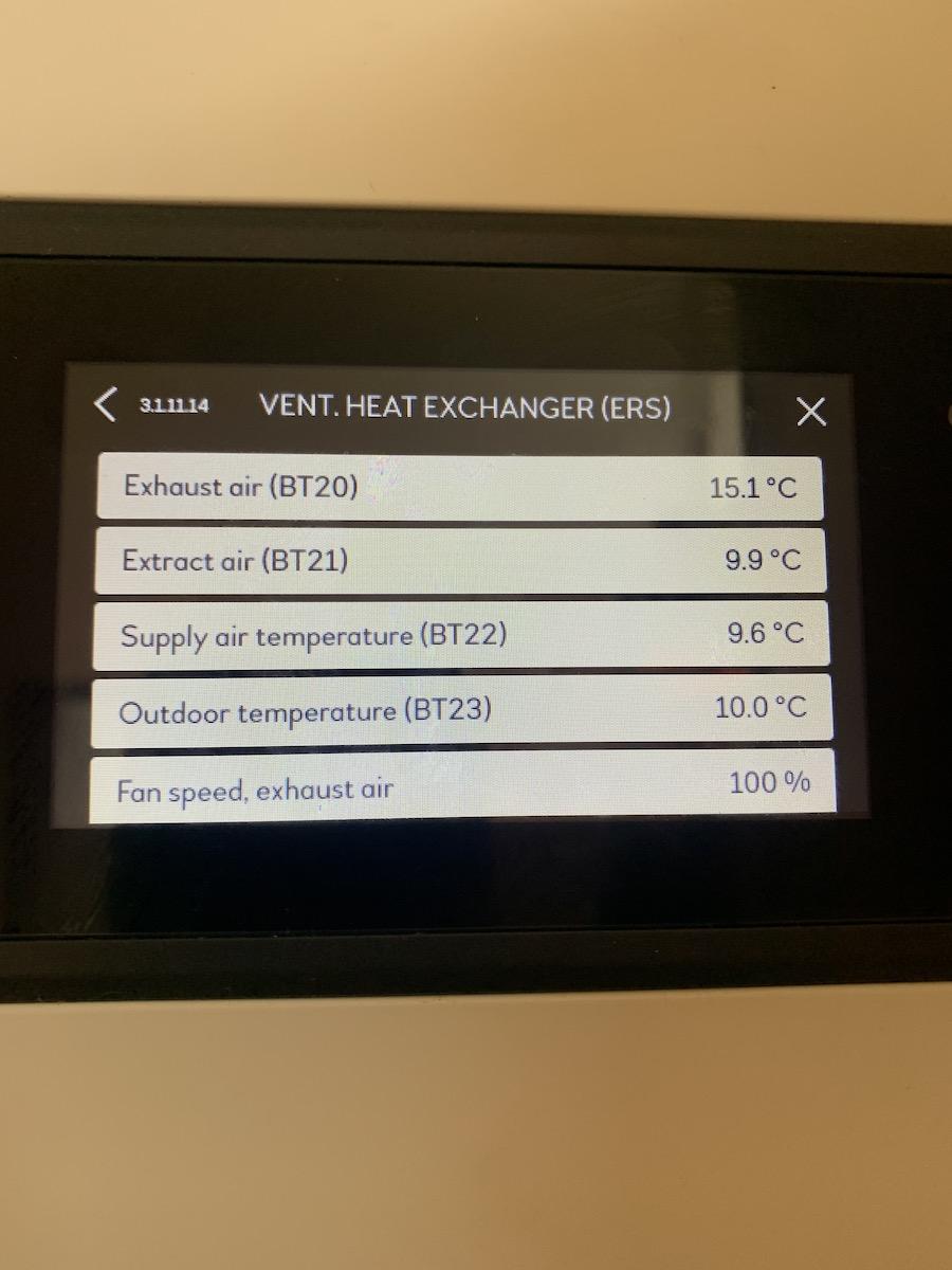

gc100 Posted February 22, 2021 Posted February 22, 2021 I'm not sure my MVHR is right. I just been running the fan speed at 100%. When I put my hand over the Exhaust vent outside I feel a good strong air flow. However when I put my hand over the supply vent outside I feel no air going in - putting a tissue is front it appears not to be pulling any air in. However when putting my hand over the supply vents inside the house I feel a good flow. So this is the first odd thing. The next thing I notice is the air coming in the supply vents within the house is really quite cold. Looking at the temp information on the MVHR unit I see this: Now according to this document http://www.cres.gr/greenbuilding/PDF/prend/set4/WI_25_Pre-FV_version_prEN_13779_Ventilation_for_non-resitential_buildings.pdf Exhaust air is the air going to outside whereas the extract air is the air coming from the rooms. It seems to be that the temporatures are back to front? and also given the supply temp is also low. Shouldn't it be : Exhaust air : 9 oC Extract air: 15.1 oC Supply 15 oC back into the house?
Mr Punter Posted February 22, 2021 Posted February 22, 2021 Something wrong there. If the system is balance the intake and exhaust air flows should be about the same. Is the building occupied and up to temperature with the heating on?

Ultima357 Posted February 22, 2021 Posted February 22, 2021 Those figures are complete nonsense or it indicates something seriously wrong with the unit/installation. Extract air temperature should be roughly the temperature of your wet rooms , say 21 to 22 deg. Exhaust air should be lower, and how low depends on the external incoming air or outdoor reading in your display. Supply temperature should be only a degree or two under your room temperature as the heat exchanger does its business to warm up the outside supplied air temp which in turn cools the exhaust temperature. My Brink at 10 deg outside is currently supplying 21.7 fresh air. House is running at 22 generally but 23 in ensuite and kitchen warm after evening cooking. The Brink gives volume flow rates for both fans so I can see what is happening.
