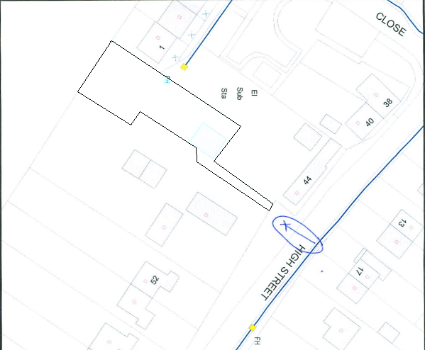

swisscheese Posted February 10, 2017 Posted February 10, 2017 I have had the initial contact with our water supplier and the quote for service connection has been supplied. This has been allegedly based on a site location visit, though neither I nor my wife were informed. Anyway, the map below has been supplied, I have added our plot to give an idea of where we are. The Service provider indicated the we need to attach to a main, OK. So they have provide the location map with the amended pen and cross to indicate where they want to make the connection, this is across a <7m wide road so will require closue/excavation/signage and over 30m worth or service pipe. My question back to them, so far without reply, is why can't we connect to to the main at the top of our site outside number 1, this would be no more than 10m away from our Kitchen and no road crossing. Any ideas?
Jeremy Harris Posted February 10, 2017 Posted February 10, 2017 (edited) What's the official classification of that pipe at the top? I'll bet the water co have classified it as a communication pipe, feeding several properties. They do this semi-deliberately, in my view, as they are not allowed to connect a new supply to an existing communication pipe, it has to be connected to a main. We had a long debate with our water co over this, but they have the law on their side (something in the Water Act, IIRC). We have a pipe running down the front of our house, in the middle of a narrow lane and 2m from our boundary, that feeds one house. It has plenty of capacity, as when we dug across the lane to put a drain in we found it, and it's a 1 1/2" cast iron pipe, running down hill, from the main around 30m higher up. The house it feeds has a massive water pressure, so much so that they've had to fit a pressure reducing valve. Still, the water co wanted us to dig up 140m of lane, parallel to that pipe, and install a new pipe from the main to our house.................... Edited February 10, 2017 by JSHarris

swisscheese Posted February 14, 2017 Author Posted February 14, 2017 OK - what the Water Co. appear to be saying via email is: "From the information I have, supplying your property from the main in great close would involve laying the service pipe through 3rd party land, this is something we try to avoid as it can cause disputes and access issues if the pipe were to leak or any future alterations that may be needed to the supply." So it is a main, so connection could be possible, and I note the caveat "From the information I have", obviously I'm not sure where the main ends, but the Water Co seems to think a service pipe to our property would need to cross a 3rd party piece of land, I will have to go out and investigate, just seems ridiculous that we are unable to connect to the nearest Main, and instead have to cross a road and lay in excess of 40m of service pipe.
Jeremy Harris Posted February 14, 2017 Posted February 14, 2017 What they seem to be saying is that although they already have way leaves in place for the properties under which that other pipe runs, they would rather not negotiate one with the owner of "number 1" in your plan. There's nothing to stop you doing this though. If the owner of "number 1" is agreeable, then you can get a way leave agreement drawn up and connect to that main. As the connection to your plot would then be a communication pipe, it would become the responsibility of the water co once in service, and they would need to make the connections at either end. Well worth having a chat to the owner of "number 1" and seeing if they are agreeable. The water company seem to be implying that they would be unwilling to use their statutory powers to cross that land, but there's nothing at all to stop you coming to an agreement with the land owner. The way leave would need to be granted to the water co, but I can't see a major issue there, they do this all the time. It's usual under these circumstances to offer a one-off inconvenience payment to the owner of the land you want to dig up, but frankly I can't see that being massive, unless that neighbour is particularly opposed to your development.
swisscheese Posted February 14, 2017 Author Posted February 14, 2017 Thanks, the owner of the land is the Local district council as the properties in Great Close are mostly still Council properties (sheltered accommodation bungalows, mostly elderly) and number 1 certainly still is. I can try and speak to Number 1 but they have been quite "sensitive" about the works. Is there a method to go through the district council, with regard to way leaves on council properties.
Jeremy Harris Posted February 14, 2017 Posted February 14, 2017 The council should have a point of contact for whoever looks after those properties, so a dig around on their website and a few phone calls is probably the best way forward. They can refuse permission, but it can't hurt to ask, as it doesn't look from the plan as if it would be very disruptive. If you can ask the resident of the property if you can look in the garden of that house, to locate the stop cock marked, and take a few photos and measurements then you'd be better armed if you end up talking to a council jobsworth, perhaps. The council should be well-acquainted with way leaves and should understand that the water co will have responsibility for the pipe, anyway, so I can't see any major problems, other than the council wanting to charge you a disproportionate fee, perhaps.
