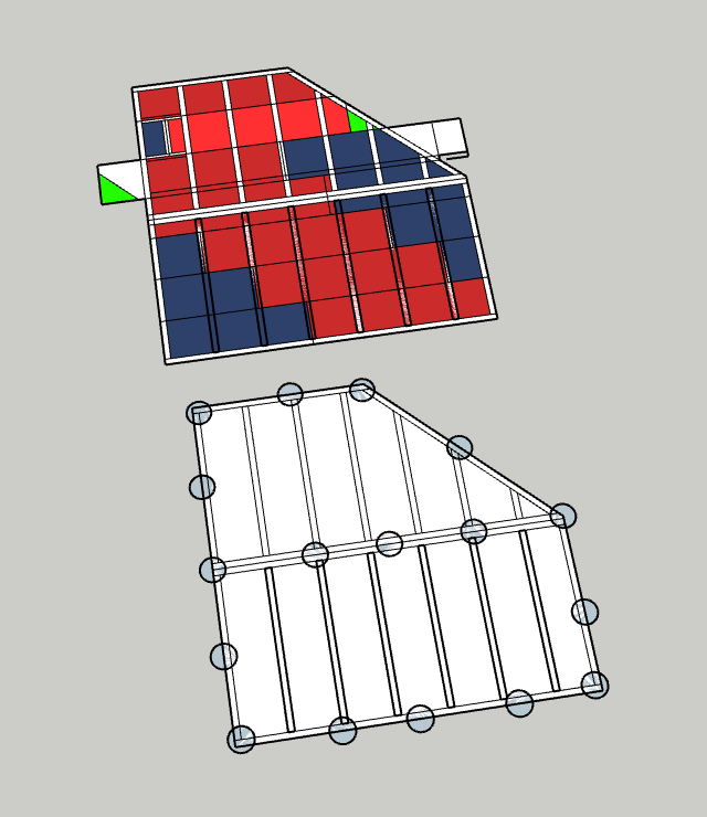

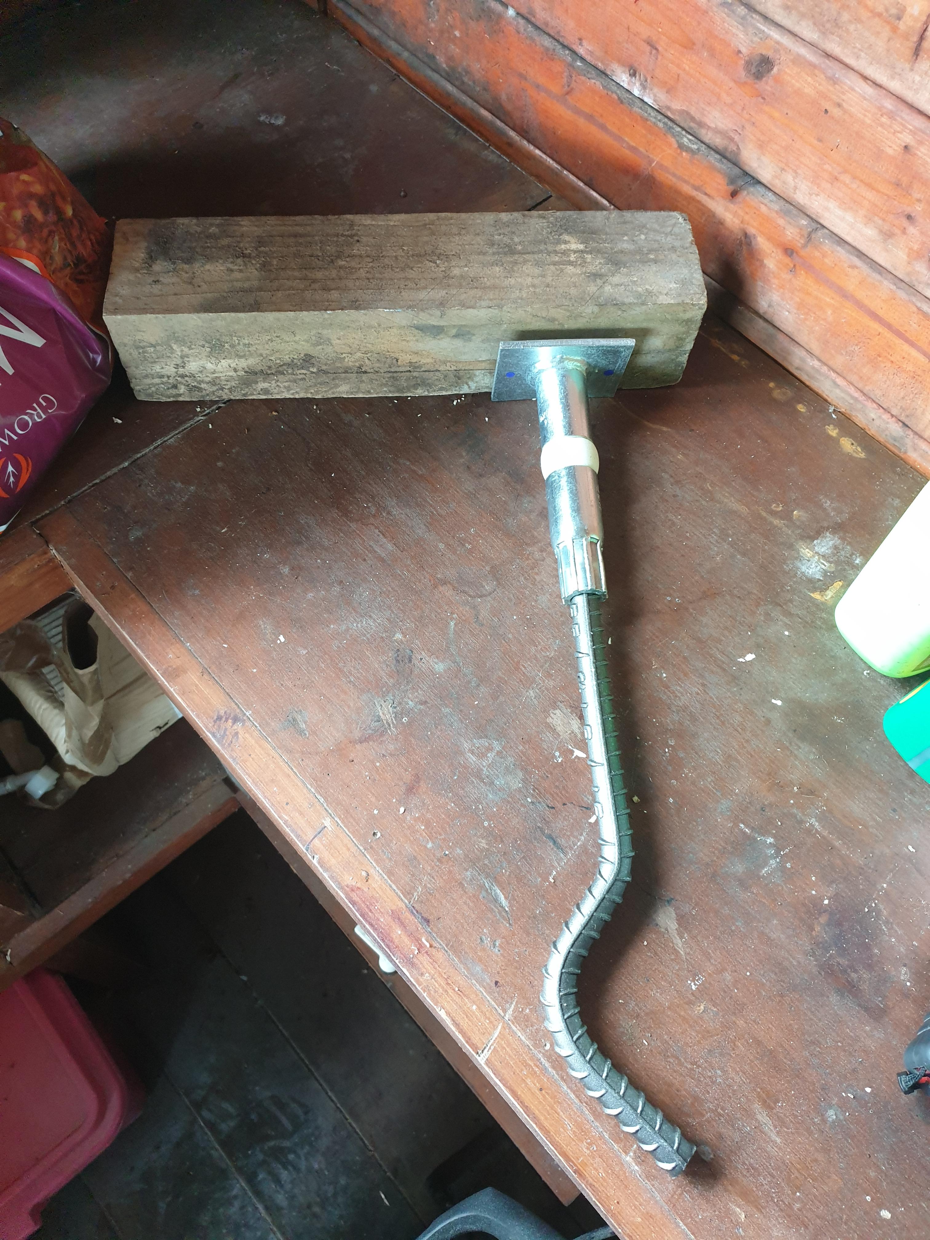

iSelfBuild Posted February 20, 2021 Posted February 20, 2021 (edited) I'm building a 4.5m x 4.5m corner garden office soon and inspired by a Youtube channel - I fancy using a variation of their DIY foundation pile system. Instead of using 24mm bar, setting level in concrete, chopping down, making brackets, lots of cutting etc I have chosen some precast concrete anchors (used to supply these in my old job) They are very good value anchors, The plan is to dig 23 number - 500mm deep by 200mm wide holes with a post hole digger and set them in concrete - rebar anchor flush with the top then the thread between and flat plate giving 100mm above ground to the timber. The crimped rebar anchor and flat socket is rated at 7500kg destructive load. Both have 24mm female thread. I plan to put 150mm of 24mm thread between the two. I've worked out each 180* turn gives me 1mm of adjustment so the advantage of my system is that they are permanently adjustable forever. I will dig the holes - then fix the assembled anchors to the timber - I'm thinking two 6mm coach screws in each support - just concerned these could shear with wind loads? Base frame will be 4 x 3" timber. Plan is to fill all the holes up with concrete, wiggle all the anchors in one go fixed to the timber and set them all level using breezeblocks/packers. Let it set then fine tune the anchors by winding up or down. Crazy or good idea? Edited February 20, 2021 by iSelfBuild

iSelfBuild Posted February 20, 2021 Author Posted February 20, 2021 (edited) All the steel anchors etc have been given to me for free. I designed them all in china and got them CE approved and handled conformance 3 years ago so my old boss has done me a very kind favour and supplied them FOC. Only reason for long term adjustability is because I like the idea of being able to fix it if a certain pile sunk and settled - so just tried to improve on the design of the one in the video... never keep things simple and my inner inventor usually runs away with itself haha. Edited February 20, 2021 by iSelfBuild
