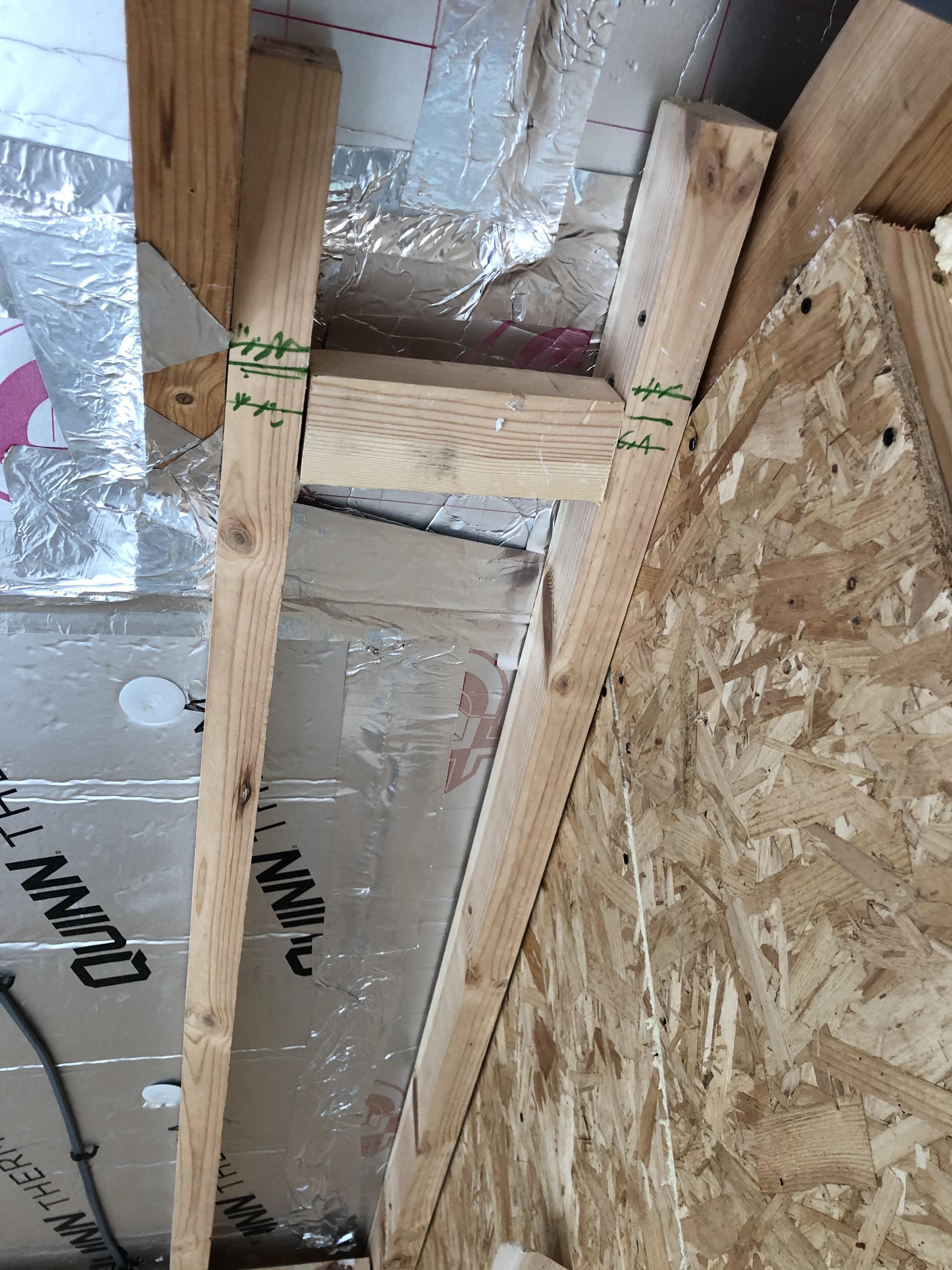

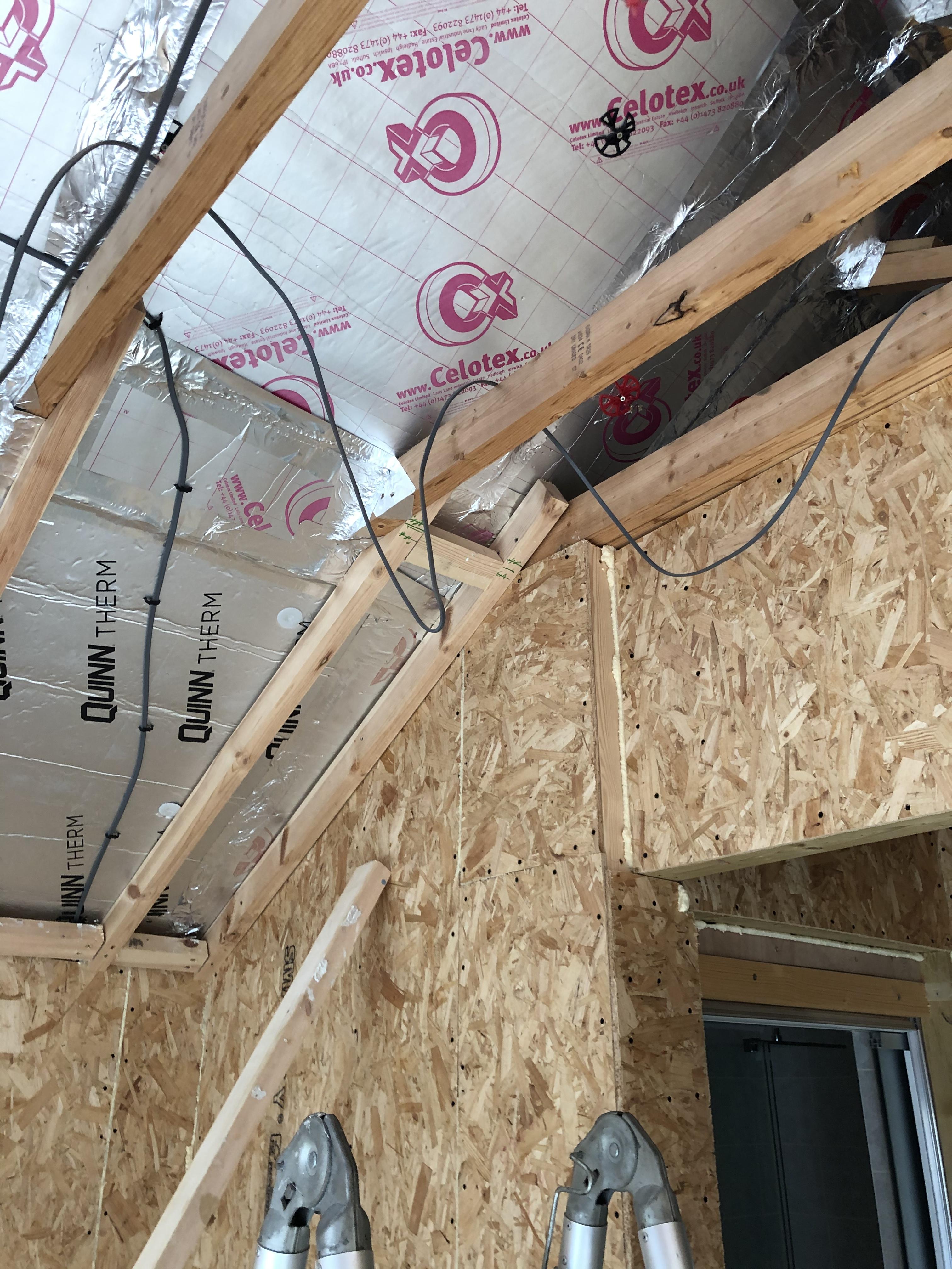

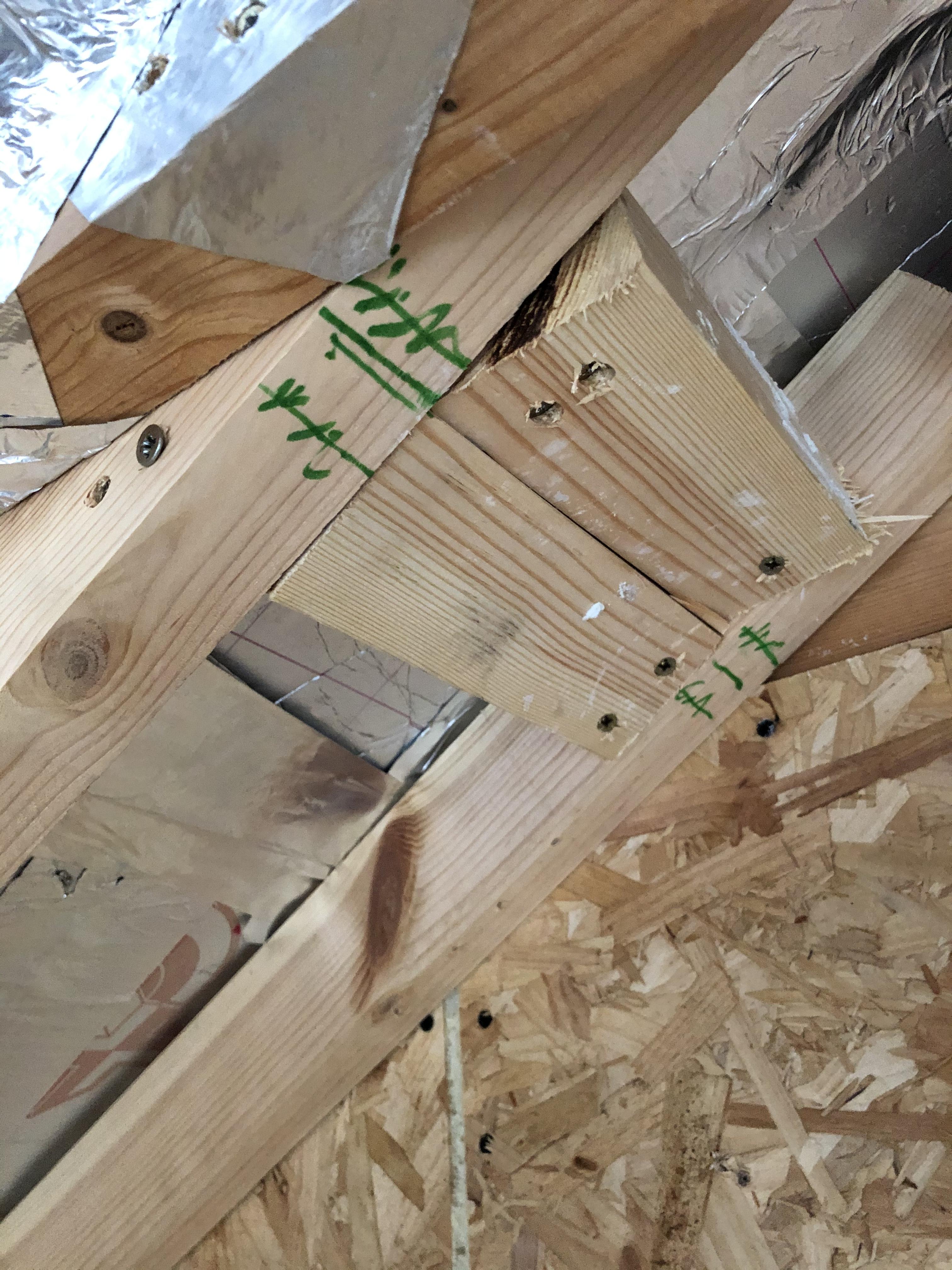

Pocster Posted February 17, 2021 Posted February 17, 2021 (edited) I’m putting in noggins ready for the plasterboard ceiling . What should I do where sloped plasterboard meets horizontal ceiling ? A noggin at the top ( and bottom ) for the slope . Another noggin at the top for the ceiling ? . Just seems wasteful and awkward - or is it simply the way ? Edited February 17, 2021 by pocster
Pocster Posted February 17, 2021 Author Posted February 17, 2021 2 minutes ago, Onoff said: The edges of each board need support imho. Yeah that’s what I thought . I’ll use more noggins and put the ceiling pb up first . Then at least the sloped pb will offer some support at the joint ( ceiling to slope ) . Probably over thinking it as it avoids doing the work ?

nod Posted February 17, 2021 Posted February 17, 2021 15 mil and above don’t need the edges to be supported Even at 600 mil
Onoff Posted February 17, 2021 Posted February 17, 2021 13 minutes ago, nod said: 15 mil and above don’t need the edges to be supported Even at 600 mil Wasn't there a thread about this very issue a little while ago? Tbh I thought it had been said they needed support... Do you just tape the joint then?
Pocster Posted February 17, 2021 Author Posted February 17, 2021 Pb for ceiling is 12.5mm Collated screws 45mm Will support all ends !
Pocster Posted February 17, 2021 Author Posted February 17, 2021 Just means doing things like this to support the pb both ways 1

nod Posted February 17, 2021 Posted February 17, 2021 3 hours ago, pocster said: Pb for ceiling is 12.5mm Collated screws 45mm Will support all ends ! The PB on the.ceiling should always be 15 mil on 600 centers
nod Posted February 17, 2021 Posted February 17, 2021 3 hours ago, Onoff said: Wasn't there a thread about this very issue a little while ago? Tbh I thought it had been said they needed support... Do you just tape the joint then? No 15 mil will carry over 600 Nearly all trusses are counter battened with 75x25 at 600
Onoff Posted February 17, 2021 Posted February 17, 2021 15 minutes ago, nod said: The PB on the.ceiling should always be 15 mil on 600 centers My bathroom walls and ceiling are 12.5mm moisture resistant on 400mm centres. Will it fall down? ? The upstairs 4 rooms in the dormer are 9.5mm pb on walls AND ceiling. The proverbial plasterboard tent. 1

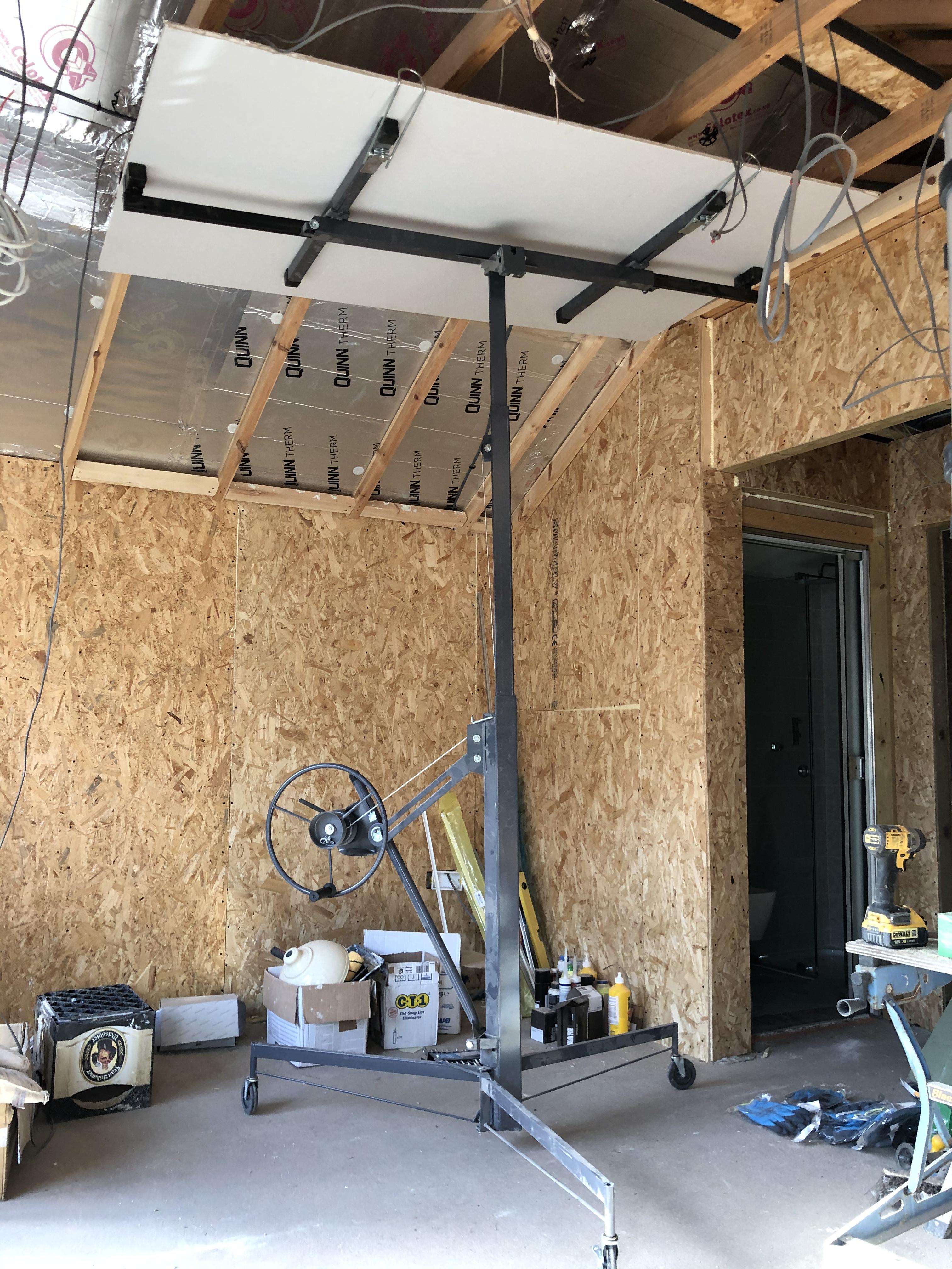

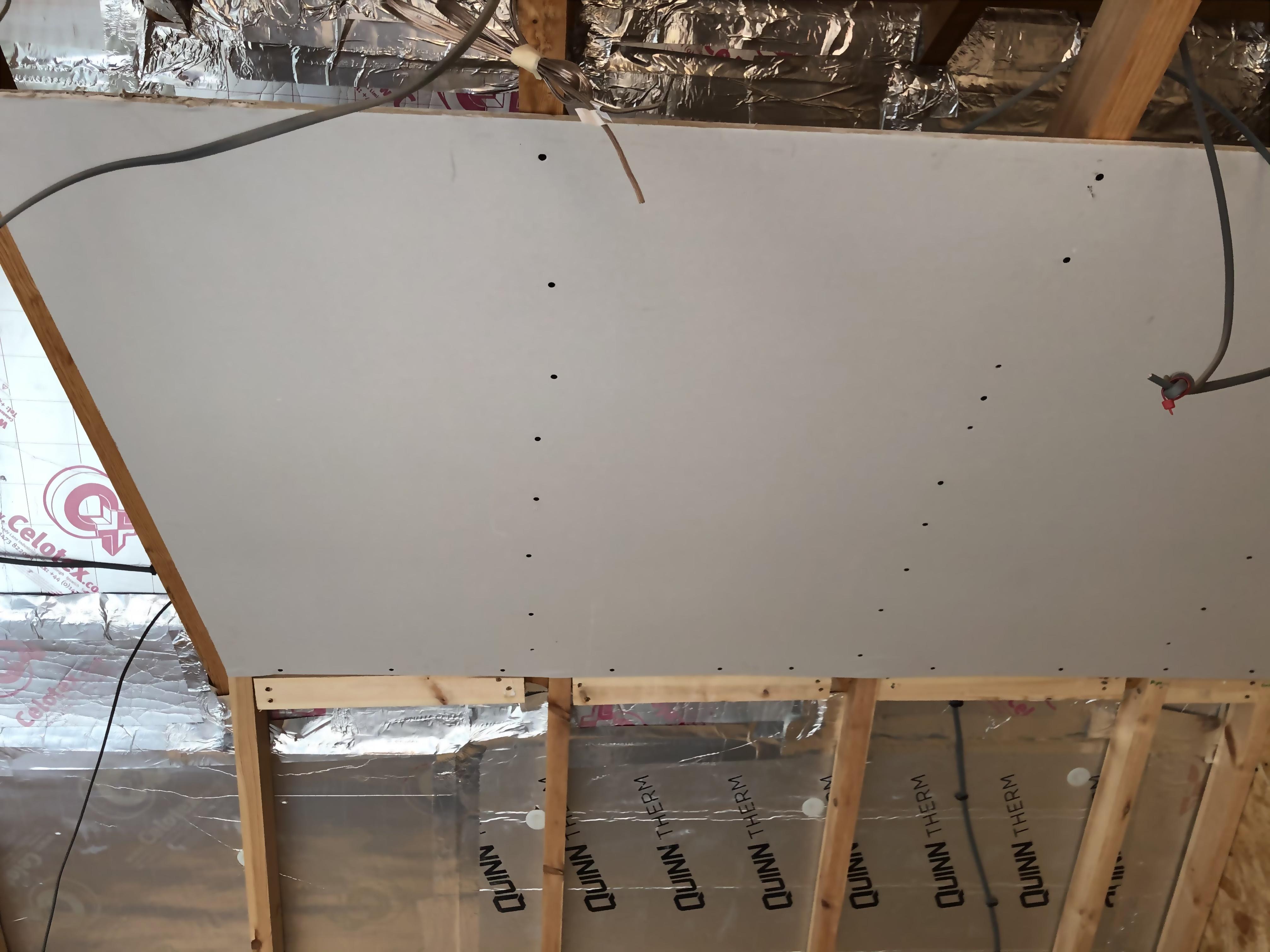

Pocster Posted February 18, 2021 Author Posted February 18, 2021 First almost whole sheet up . Will add noggins to ends . Cut it to short ! Typical , I always think things are longer than they actually are !! 1

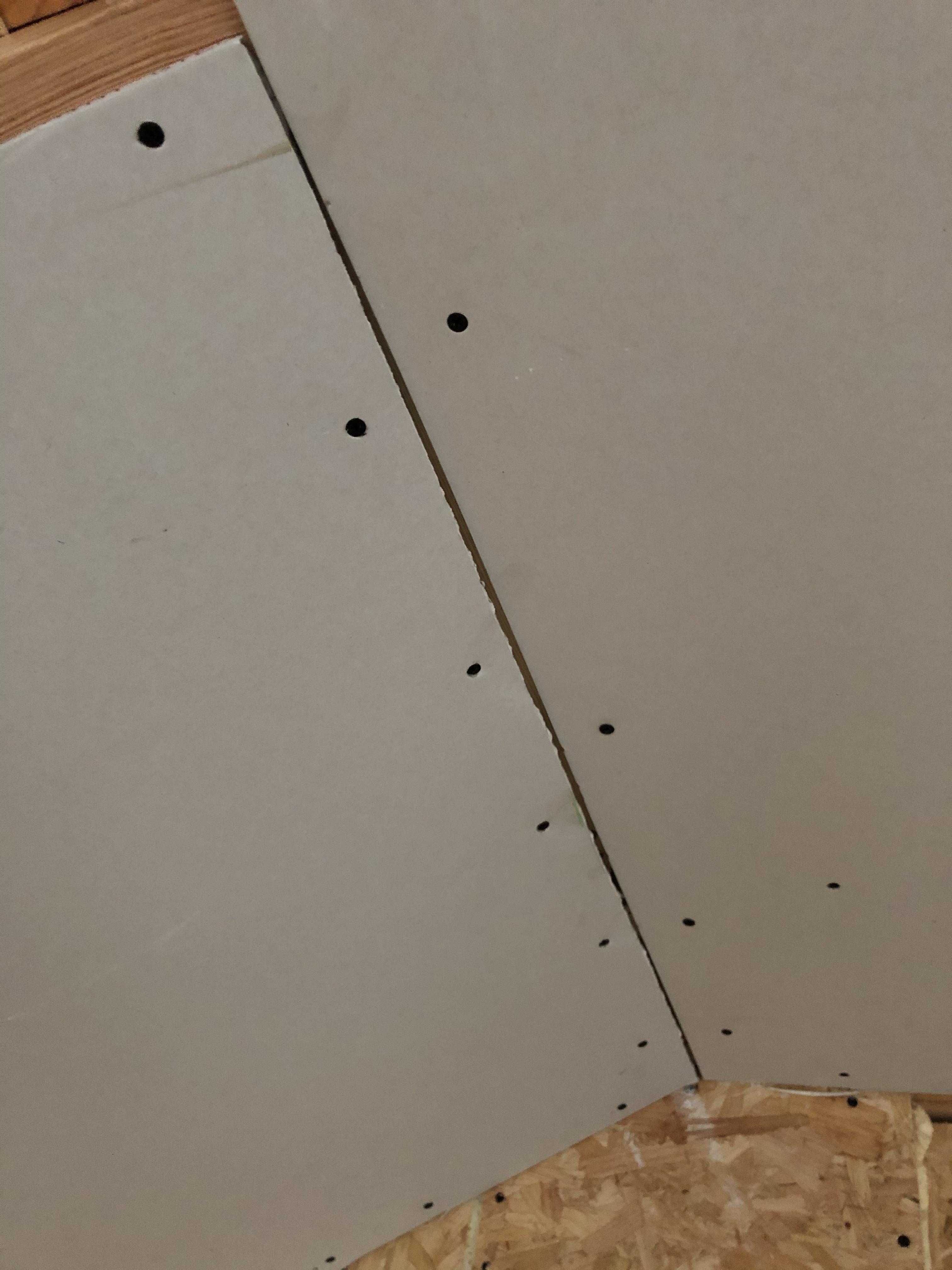

Pocster Posted February 18, 2021 Author Posted February 18, 2021 A few screw ‘misses’ but removed them ; otherwise plasterer will whine

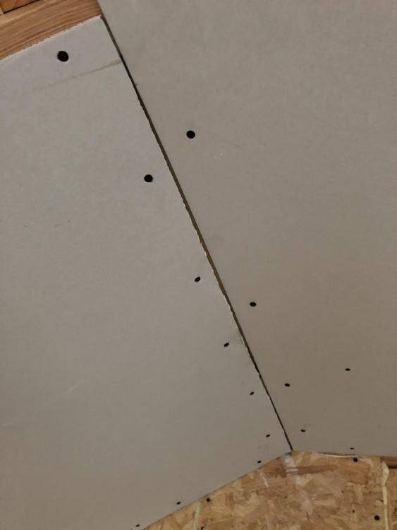

Pocster Posted February 19, 2021 Author Posted February 19, 2021 Assume the gap between the 2 boards I leave for the plasterer to sort rather than me balls it up ?
Pocster Posted February 19, 2021 Author Posted February 19, 2021 2 minutes ago, TonyT said: Yes he will tape and plaster over. I shall leave for him to complain at ?
