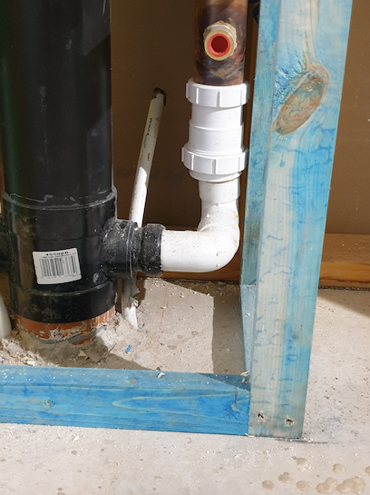

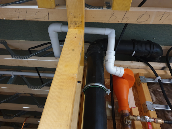

- They've connected 50mm pipe from the shower trap to the top of the showersave with what looks like some 40mm pipe and elbows.
- They've connected bottom of showersave to SVP, again, with what looks like 40mm pipe and elbows.
Will the 40mm not have any real impact if it's only these connections? Or, will they negate the use of 50mm pipe from shower, or even worse create a bottleneck of some sort?

So why use that crap 40mm solvent weld where 50mm is already fitted ..??
That first elbow will collect crud as the stopper shouldn’t be fitted horizontal as it creates a lip in the elbow. Also, they should all be swept elbows and not 90 degree elbows.
I would have done that with 45 degree bends - smooth and fast into the heat recovery unit.
Just looks like they used what was on the van
Exactly!  The solvent weld stuff in itself isn't bad is it?   Rather,  it's just the way they've reduced to 40mm and the 90deg bends, right?
