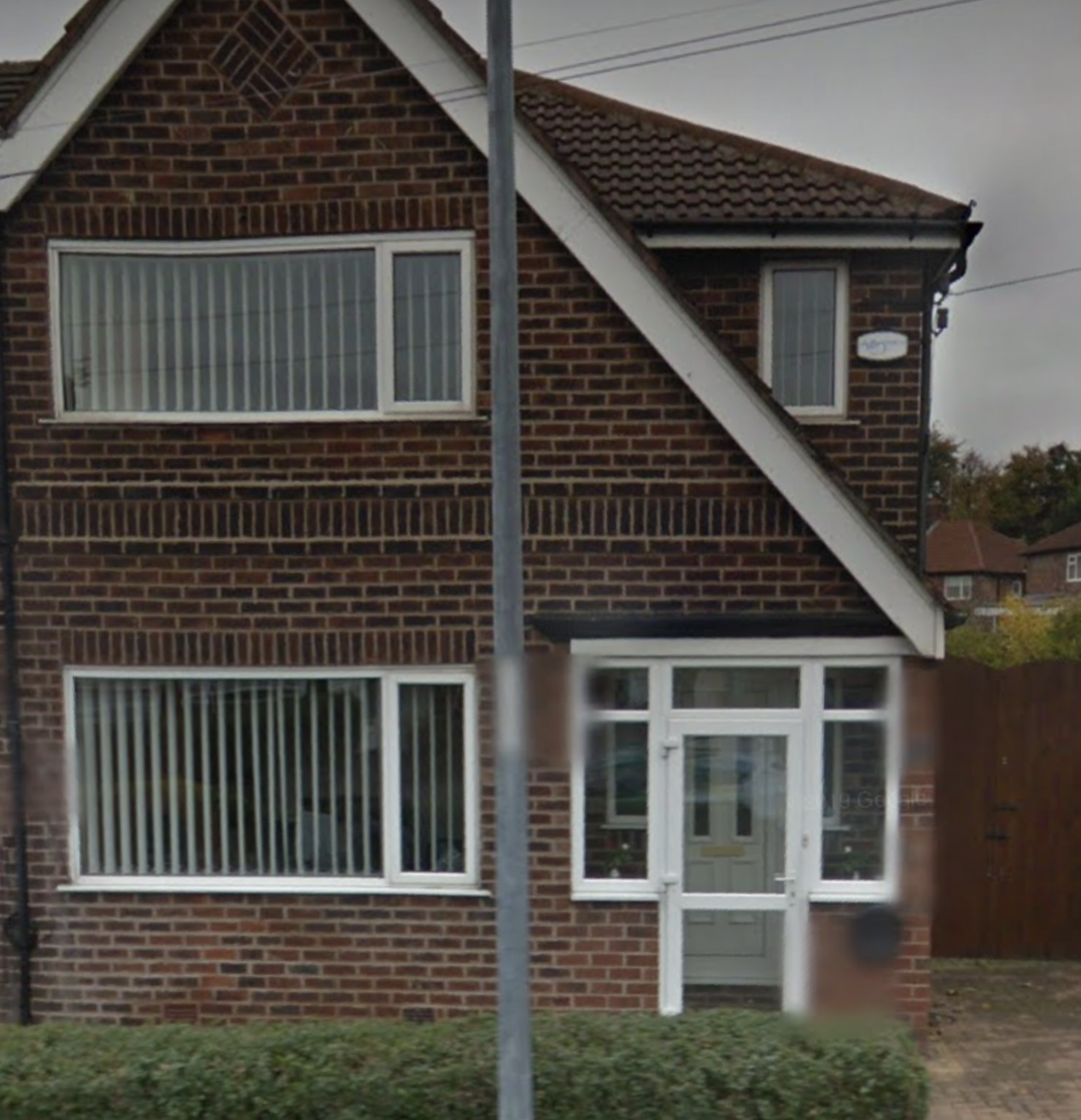

Diana C Posted February 8, 2021 Share Posted February 8, 2021 Hi, I would like to rebuild and extend existing porch. The idea is to make it usable space for shoes and coats rather than a 'wind catcher'. It already is 3m² but it's within the house wall boundaries so I am unsure if it is considered a porch if it's not outside the house walls. Can I extend it ? Link to comment Share on other sites More sharing options...
PeterW Posted February 8, 2021 Share Posted February 8, 2021 I would say that’s part of the main house structure as it is under the main roof so the planning rules on adding a front porch to that would apply. @DevilDamo..?? 1 Link to comment Share on other sites More sharing options...
Diana C Posted February 8, 2021 Author Share Posted February 8, 2021 Thank you for your advice. Did I understand correctly that I could potentially build another up to 3m² extension at the front? Link to comment Share on other sites More sharing options...
DevilDamo Posted February 8, 2021 Share Posted February 8, 2021 In ‘normal’ Planning terms, I would say that’d be classed as a front/infill extension as you’re increasing the habitable floor space. Under PD, I would therefore say infilling that space would count towards your PD limit. You have already provided a porch over an external door and if it already measures 3sq.m, anything more would require Planning. 1 Link to comment Share on other sites More sharing options...
