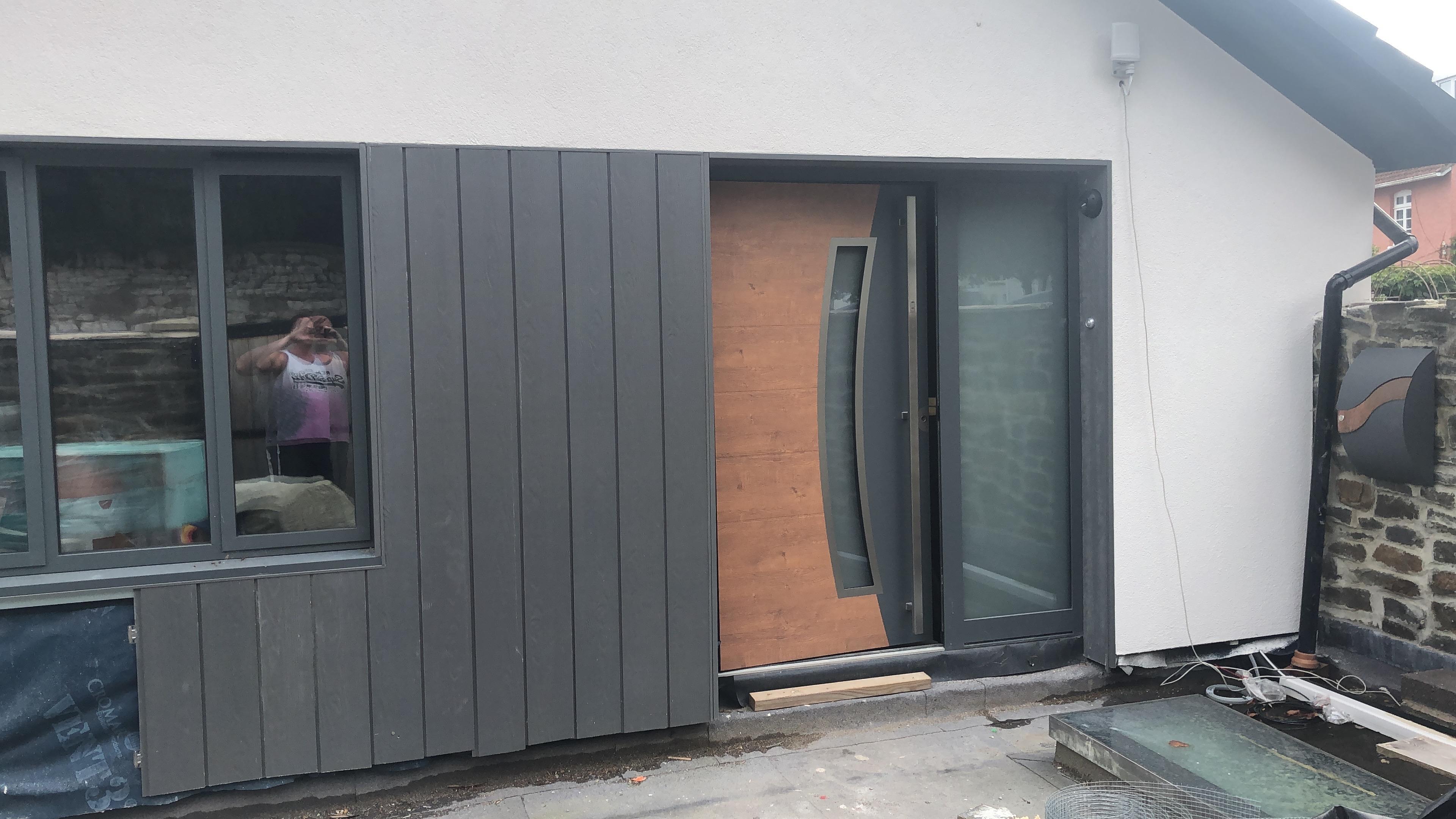

Pocster Posted February 7, 2021 Posted February 7, 2021 9 minutes ago, Dreadnaught said: Yes, I'm going for the extra fat, super-insulated version in this design. 1.5m wide so a bit wider than in the image. Black escutcheon (yes I didn't know either: keyhole) unlike in the image. That's a bespoke groove pattern by the way. Here’s ours 1
