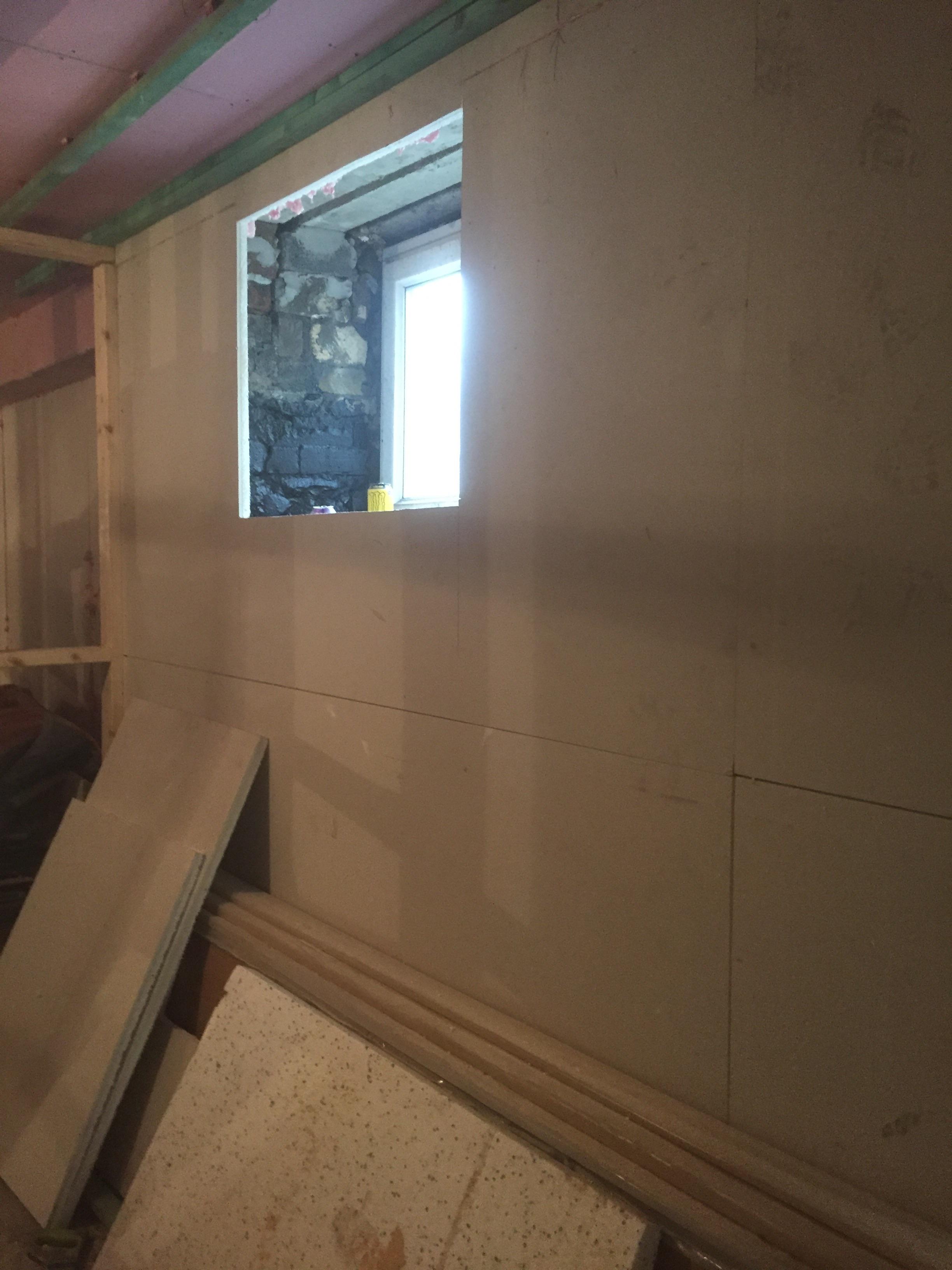

Nickfromwales Posted February 7, 2017 Posted February 7, 2017 If you just foam or dab EPS onto the wall you'll be surprised at how well it adheres and how rigid it goes. Just done the attic pine end ( stone ) walls this way and it's rock solid. I then foamed / dabbed PB straight on top of the EPS and skimmed. Fixing anything to the wall is a pita but I overcame that with BFO concrete screws ( 43" tv on tight with no movement ). Dont underestimate just how well EPS bonds without mechanical fixing, but I dabbed the shit out of mine so next to no voids . Whack one on and see for yourself. These are all 30mm EPS PB's stuck with dab and foamed all around. They're going nowhere.
