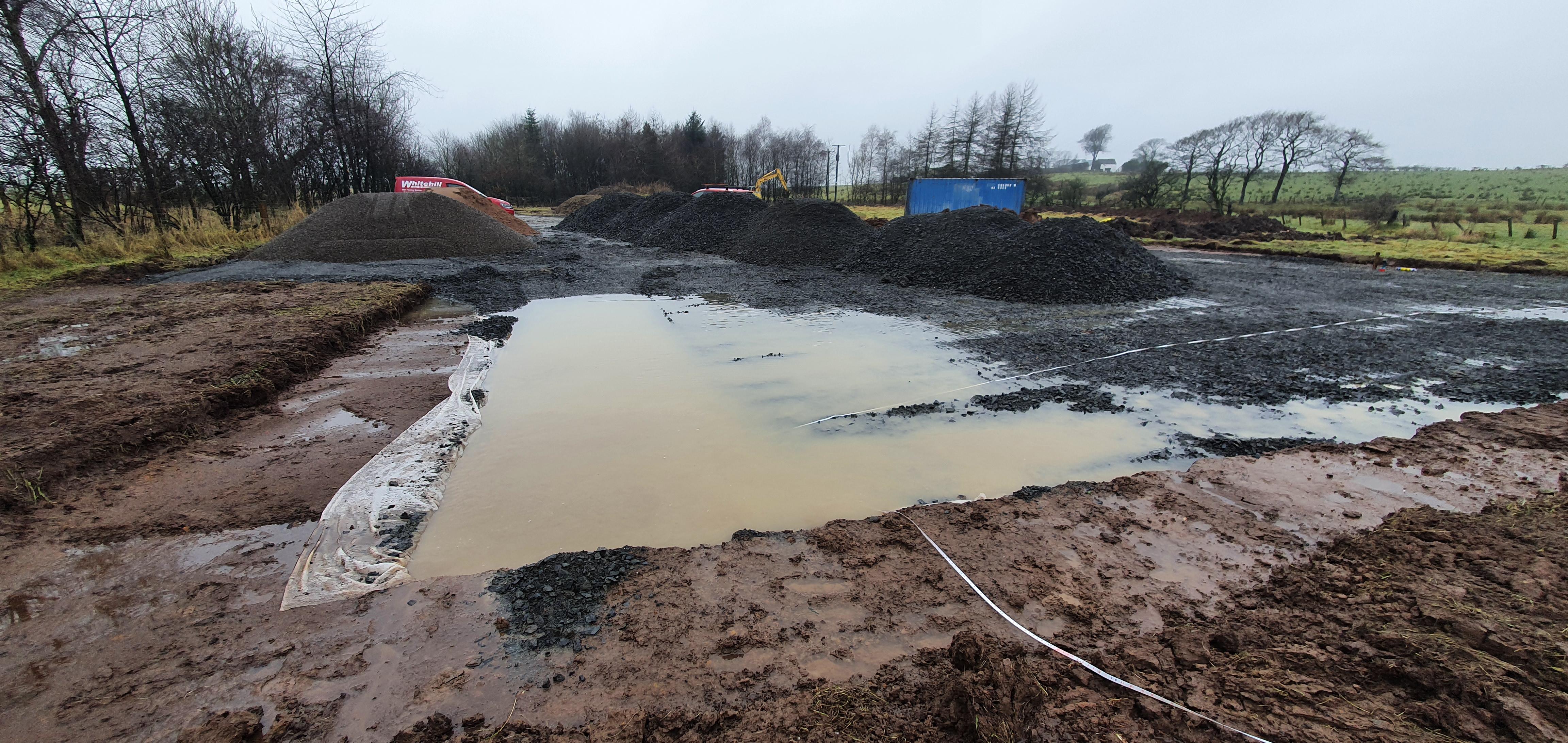

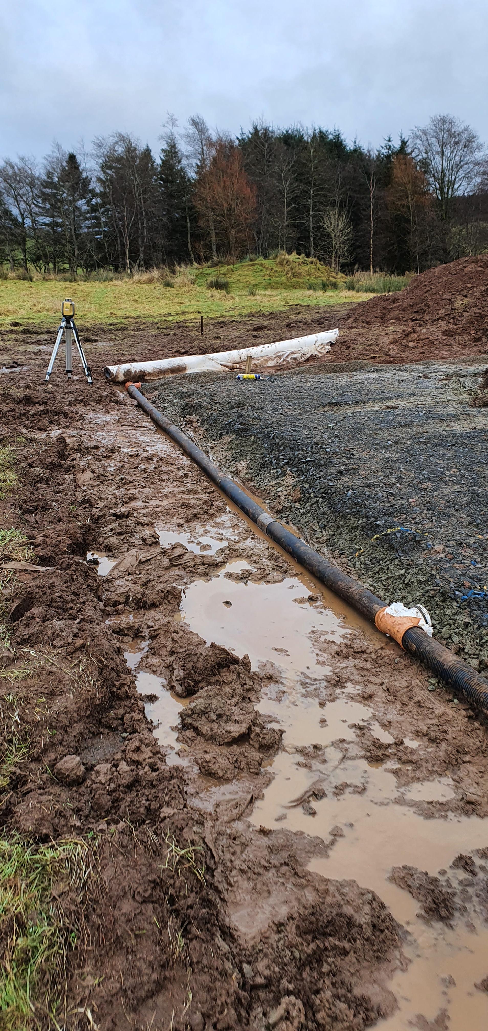

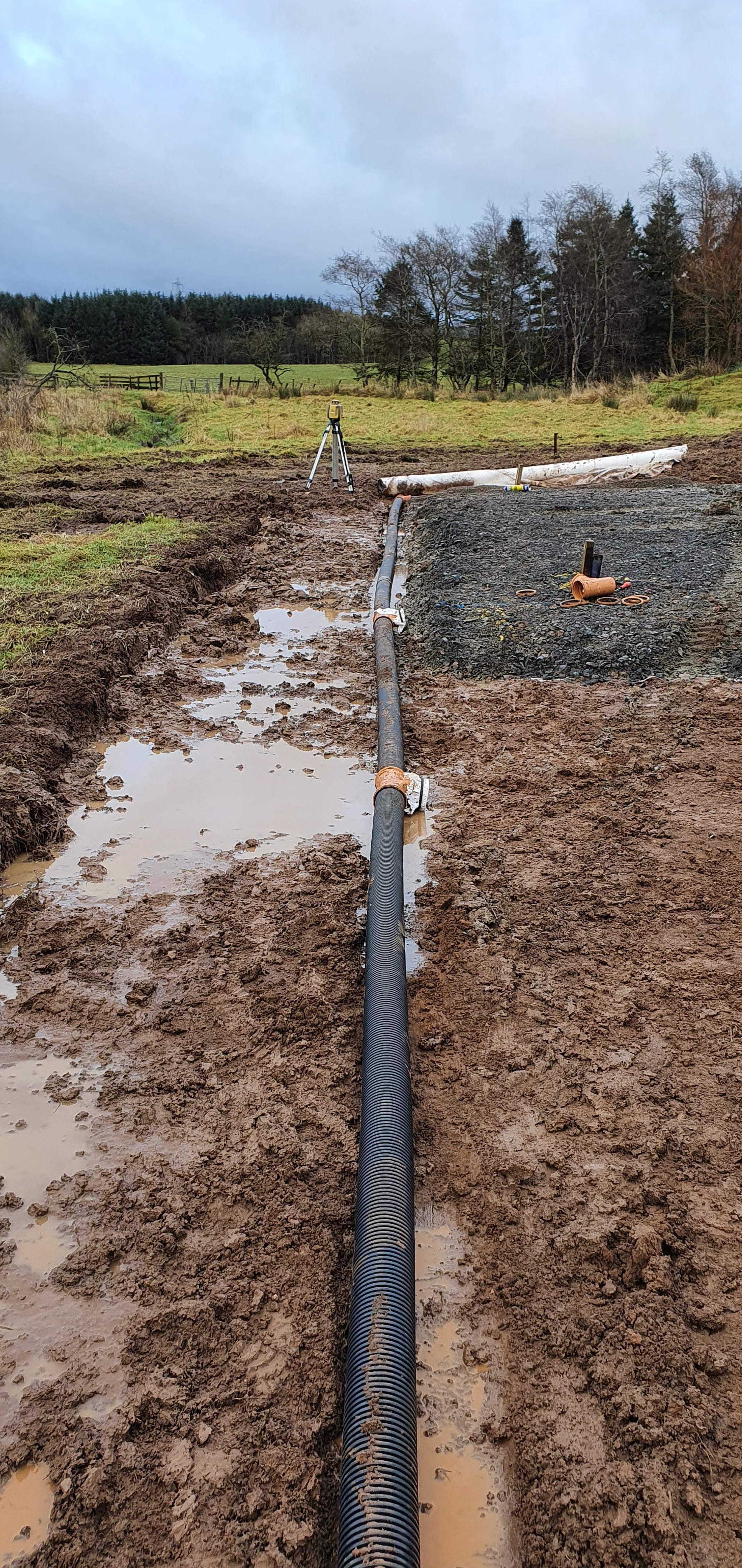

SuperJohnG Posted January 31, 2021 Share Posted January 31, 2021 On 30/01/2021 at 18:44, joe90 said: You could always do like I did and run the drainage pipe into you’re drains, that’s where the rain from the roof goes!!! This is exactly what I'm doing right now....I have 110mm twinwall land drain which I've just laid and added tees where the downpipes will drop in later on and then the whole lot discharges onto the burn. Few pics....and also the swimming pool at one end of my foundations (which no longer exists thanks to the drains. ) 1 Link to comment Share on other sites More sharing options...

Andy H Posted February 2, 2021 Author Share Posted February 2, 2021 On 31/01/2021 at 23:41, SuperJohnG said: This is exactly what I'm doing right now....I have 110mm twinwall land drain which I've just laid and added tees where the downpipes will drop in later on and then the whole lot discharges onto the burn. Few pics....and also the swimming pool at one end of my foundations (which no longer exists thanks to the drains. ) Thanks for the photos - are you in effect building french drains in the land surrounding the proposed building? A friend of mine suggested that I build a french drain system in my garden directing any rainwater from the garden ever getting around my building in the first place. It sounded like a good idea. I could try and do something similar at my neighbouring boundaries to restrict the rainwater running from their garden into the backfill around the building. Link to comment Share on other sites More sharing options...
SuperJohnG Posted February 2, 2021 Share Posted February 2, 2021 19 minutes ago, Andy H said: Thanks for the photos - are you in effect building french drains in the land surrounding the proposed building? Yes. Its just a land drain around the full perimeter of the house footprint, its required in my foundation systems drawings that there is a perimeter (french) drain minimum 500mm outside the edge if my insulated foundation. The footprint is now essentially an island. It just ensures and water can free drain and there's no possibility of frost heave. Link to comment Share on other sites More sharing options...
