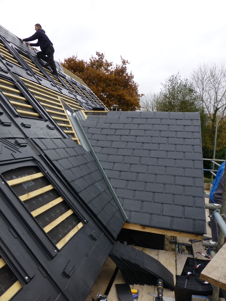

Rossek9 Posted April 14, 2017 Author Share Posted April 14, 2017 I've spoken again to the installer about the in roof kit and he assures me that if I am installing with slate the roof does not require to be battened at all. Does this sound right? In Scotland it is normal practice to just slate straight onto sarking although I thought that for the in roof kits there needed to be battens and counter battens to allow air flow behind? However I found this via the Easy roof website - Link to comment Share on other sites More sharing options...

Jeremy Harris Posted April 14, 2017 Share Posted April 14, 2017 (edited) I looked at this carefully, and there is definitely an advantage in ventilating under the panels. We have 18mm OSB sarking, counter battens, membrane, then battens, then the GSE in-roof system (near-identical to the Easy Roof system) fitted to the battens. This arrangement allows a good airflow up under the panels to the ventilated ridge. Our roof is also "slate": Edited April 14, 2017 by JSHarris Link to comment Share on other sites More sharing options...

Rossek9 Posted April 14, 2017 Author Share Posted April 14, 2017 4 hours ago, JSHarris said: I looked at this carefully, and there is definitely an advantage in ventilating under the panels. We have 18mm OSB sarking, counter battens, membrane, then battens, then the GSE in-roof system (near-identical to the Easy Roof system) fitted to the battens. This arrangement allows a good airflow up under the panels to the ventilated ridge. Our roof is also "slate": Is the advantage for performance of the panels or something else? Not having battens and counter battens seems to be bringing the timber frame package down by about £3k. Link to comment Share on other sites More sharing options...
Jeremy Harris Posted April 14, 2017 Share Posted April 14, 2017 It's mainly panel performance. The one disadvantage with in-roof PV panels is that they can run a lot hotter than on-roof panels, unless there is really good ventilation behind them to take away the heat. Panel performance falls off dramatically as they heat up, and even on-roof system performance will dip a fair bit on a hot day, with the panels reaching around 40 to 50 deg C or more. Getting the best ventilation you can behind the panels reduces the performance penalty from having them mounted in-roof. When I measured the surface temperature of our panels and compared it with the measured surface temperature of a neighbours on-roof panels I found that our were only about 5 deg or so hotter, which suggests that the ventilation does help. Link to comment Share on other sites More sharing options...
Rossek9 Posted April 14, 2017 Author Share Posted April 14, 2017 4 hours ago, JSHarris said: It's mainly panel performance. The one disadvantage with in-roof PV panels is that they can run a lot hotter than on-roof panels, unless there is really good ventilation behind them to take away the heat. Panel performance falls off dramatically as they heat up, and even on-roof system performance will dip a fair bit on a hot day, with the panels reaching around 40 to 50 deg C or more. Getting the best ventilation you can behind the panels reduces the performance penalty from having them mounted in-roof. When I measured the surface temperature of our panels and compared it with the measured surface temperature of a neighbours on-roof panels I found that our were only about 5 deg or so hotter, which suggests that the ventilation does help. Yes I did think that this might be the case. I just need to see if spending the extra £3k for battens and counter battens is going to be worthwhile in terms of payback from the panels. Link to comment Share on other sites More sharing options...
