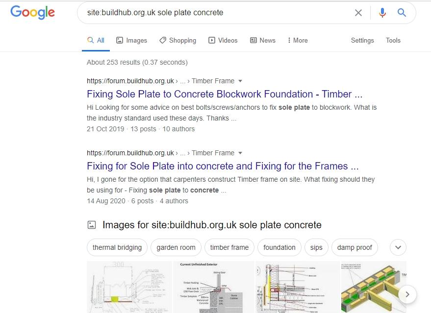

SteamyTea Posted January 27, 2021 Share Posted January 27, 2021 Or the easy way is to use Google and just search the site as the forum search is pretty poor. 1 Link to comment Share on other sites More sharing options...
