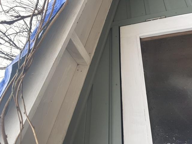

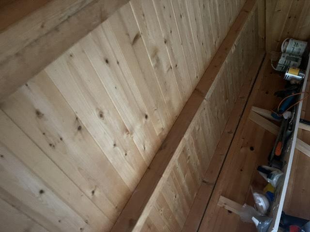

Went to the shed for the first time in a while yesterday and noticed wet handlebars on my bike so looked up to find quite a wet interior roof, however only about 1/4 of the shed nearest the door and rest is all dry. Roof has the usual felt and it looks to be in good condition so I’m a little bit stumped. It is concerning as it does feel very wet. Also the fascia above the door is very moist whereas the otherwise is dry, making me think that water has somehow got underneath the felt and is seeping down. A couple of pictures attached.
Any advice as to fault finding before I go the whole hog and remove the felt?

Do you think it’s worth putting a storage heater in there to dry to dry the wood out? I’ve got a tarpaulin over the roof for now to avoid further water ingress but the affected area is still quite wet inside.
Dehumidifier?

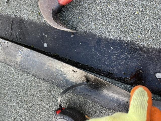

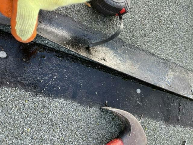

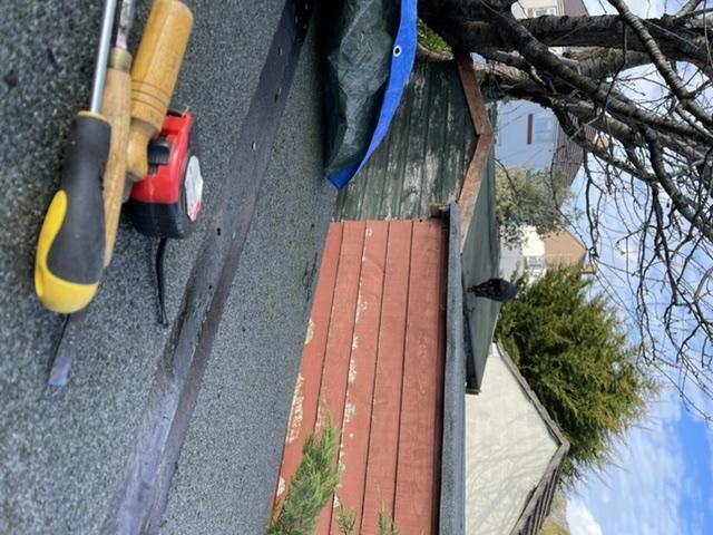

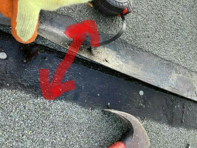

Ok so the overlap is hardly anything, this is surely the issue?
This is the picture I was trying to upload the previous two posts! Hardly any overlap, presumably this is the issue?
It’s 1m wide and really I need about 1.5m so I’ve got a 250mm overlap either side. Can’t seem to find felt wider than 1m.
Any thoughts how best to do it?
What way up is it, is the hammer "down slope"? Like this:

Was the batten the width of where the red arrow is?
The bit your finger is on is the factory edge, I think of the 1m wide roll piece used on the apex? There should be adhesive under that bit you're holding up. Where the nails are the adhesive appears to have been applied on top of the green mineral and maybe under the batten?
Looks to me like it's done wrong. How far up, does the bit with the nails in poke up under the bit you're lifting up?

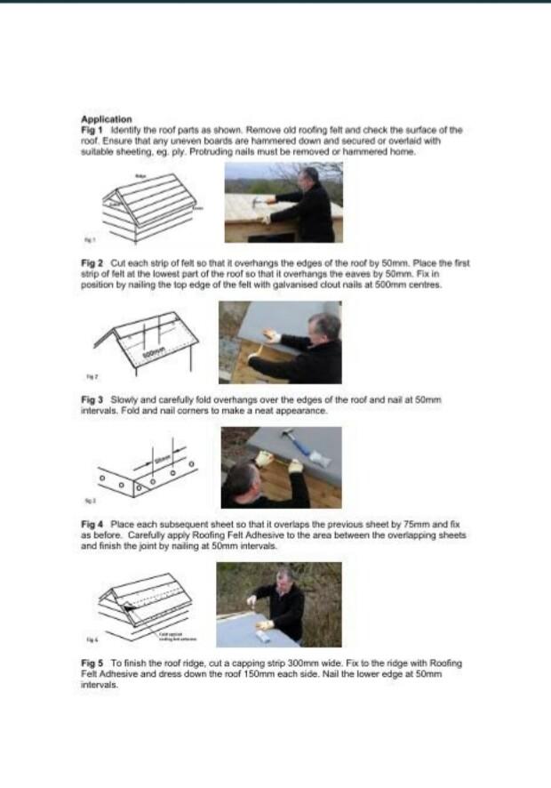

A shed roof btw should really have a minimum of two separate layers of felt. One underneath then the green mineral impregnated "cap" sheet you have there. How many layers have you got?
If you must go "one layer" there's a proper way if doing it. This from IKO (one of the big felt producers) for instance. It's good to know to help diagnose where yours is leaking:
You don't necessarily need wooden strips if done correctly. They can rot and in fact hold water, forcing it back under a poor lap. Not got any on my 2 layered shed roof. My joins are stuck like sh!t to a blanket. Have to be careful (good) to avoid adhesive dribbles. I just wipe and brush in the mineral "dust" onto any dribble. North facing elevation:

Regards where my finger is,  I do think that is the factory edge yes as this was not applied when the shed went up.
It barely poked under at all, maybe 10mm which I suspect is exactly where the water got in and seeped through, it was soaked. It’s not a one layer of felt job but I do think that’s where it got in.
I’ve done a patch up today, bought a roll of felt, removed the bit I’m holding up in the picture and started again. Used 3 3m long by 1m wide sheets (one either side with a much bigger overlap and one over the top), used adhesive and many more nails to make it nice and tight up there. Took me ages so hopefully it works!!

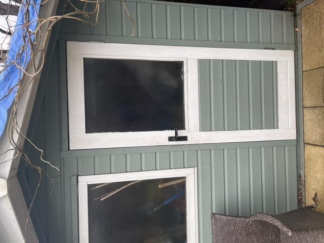

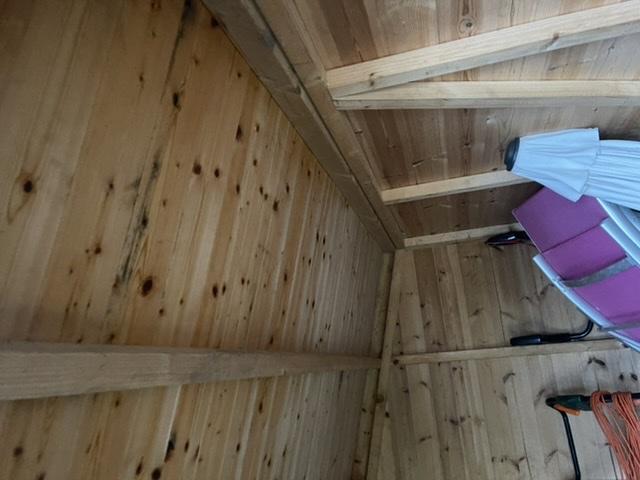

Here’s another angle of the before, complete with our cat inspecting other shed roofs. I think it shows clearly that there was sweet fa of an overlap.
Apologies that it is sideways, no idea why it uploads like that.
