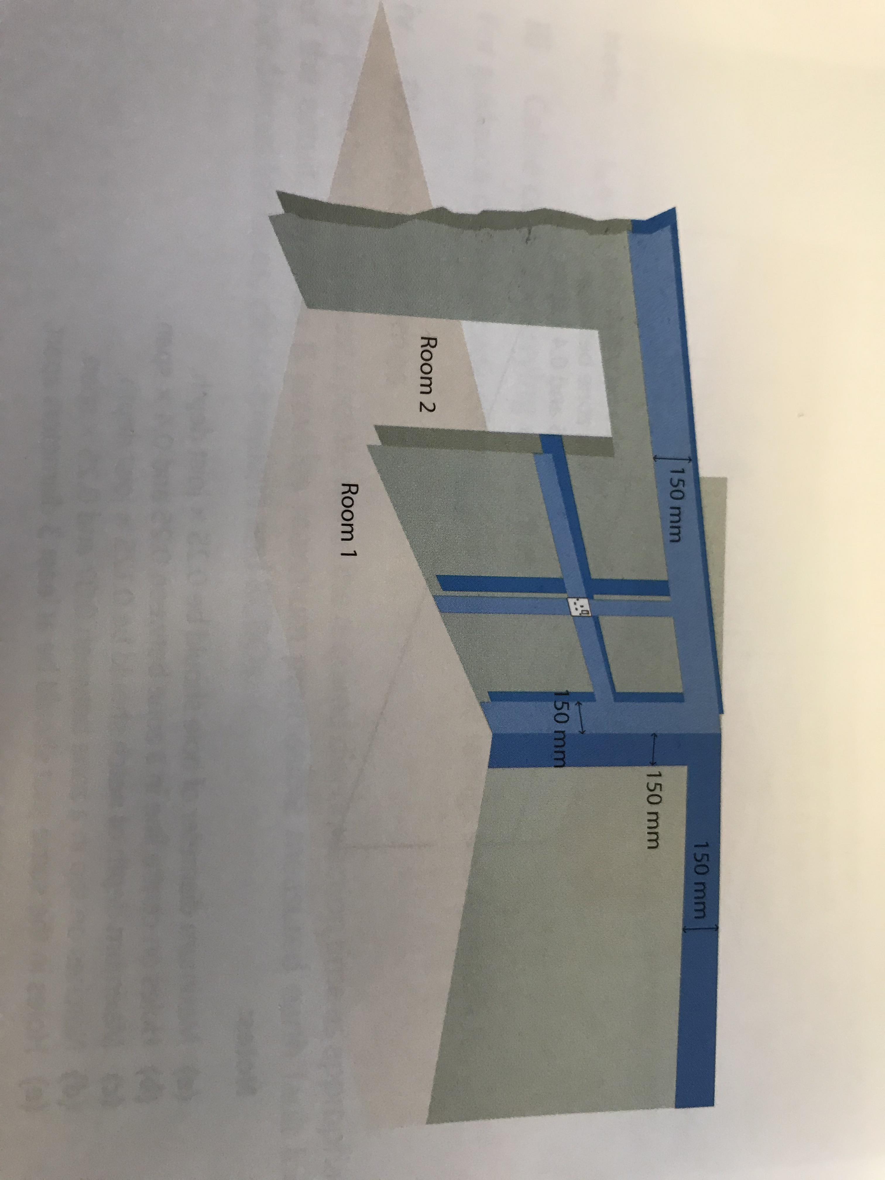

Cables should be 50mm from the surface
Or protected by 30mA RCD and installed in a zone or have earthed armouring.
Are you sure the ands and ors are typed correctly here?  The wording implies I can do anything as long as it is NOT in a zone and within 50mm of the surface.

Home now, and have found the regulation I think we are talking about: 522.6.202
My understanding of it is:
A cable is in a wall at a depth less than 50mm shall be in a permitted zone as per the diagram @TonyT posted AND be protected by RCD.
Where the accessory (etc) is on the other side of the wall and can be determined as such the permitted zone extends to the other side if the wall is up to 100mm thick (so essentially single skin blocks and stud walls only) OR it must comply with reg 522.6.204. This is the case I find myself needing to use. And strangely the RCD requirement seems to now not apply, but I see no reason NOT to have one!!
Reg 522.6.2-4 gives 5 options for various earthed, mechanical and isolation protections, SWA looking like the easiest.
So my choice seems fairly clear - the wall is about 250mm thick, so clearly the permitted zone does not extend. I therefore need either steel conduit or SWA on the inside.

@dnb @TonyTGreat info in this thread guys, thank you. One follow up question I need a bit of advice on…I plan on putting external lights at the same height as the internal ceiling safety zone. The cables would be run in that zone (batten service void), pass through the timber framed/rendered wall (260mm) and terminate directly into the light fitting
Do I need to joint and change to swa before the cable passes through the wall or can I continue in t&e but put in a short length of metal/plastic conduit?
Do I need to put a box and blanking plate on the inside wall surface to show presence of cables even though it’s in the safety zone?
