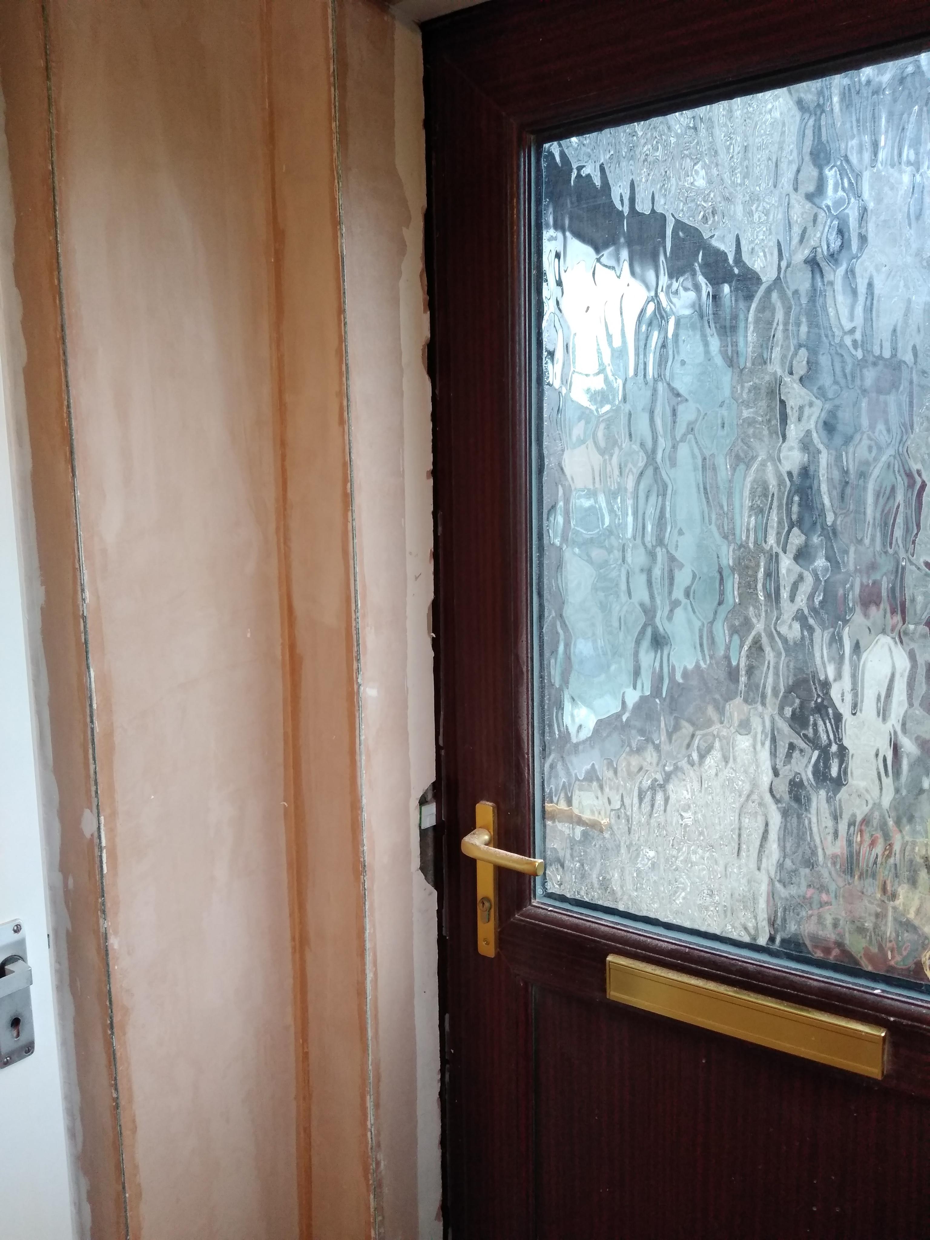

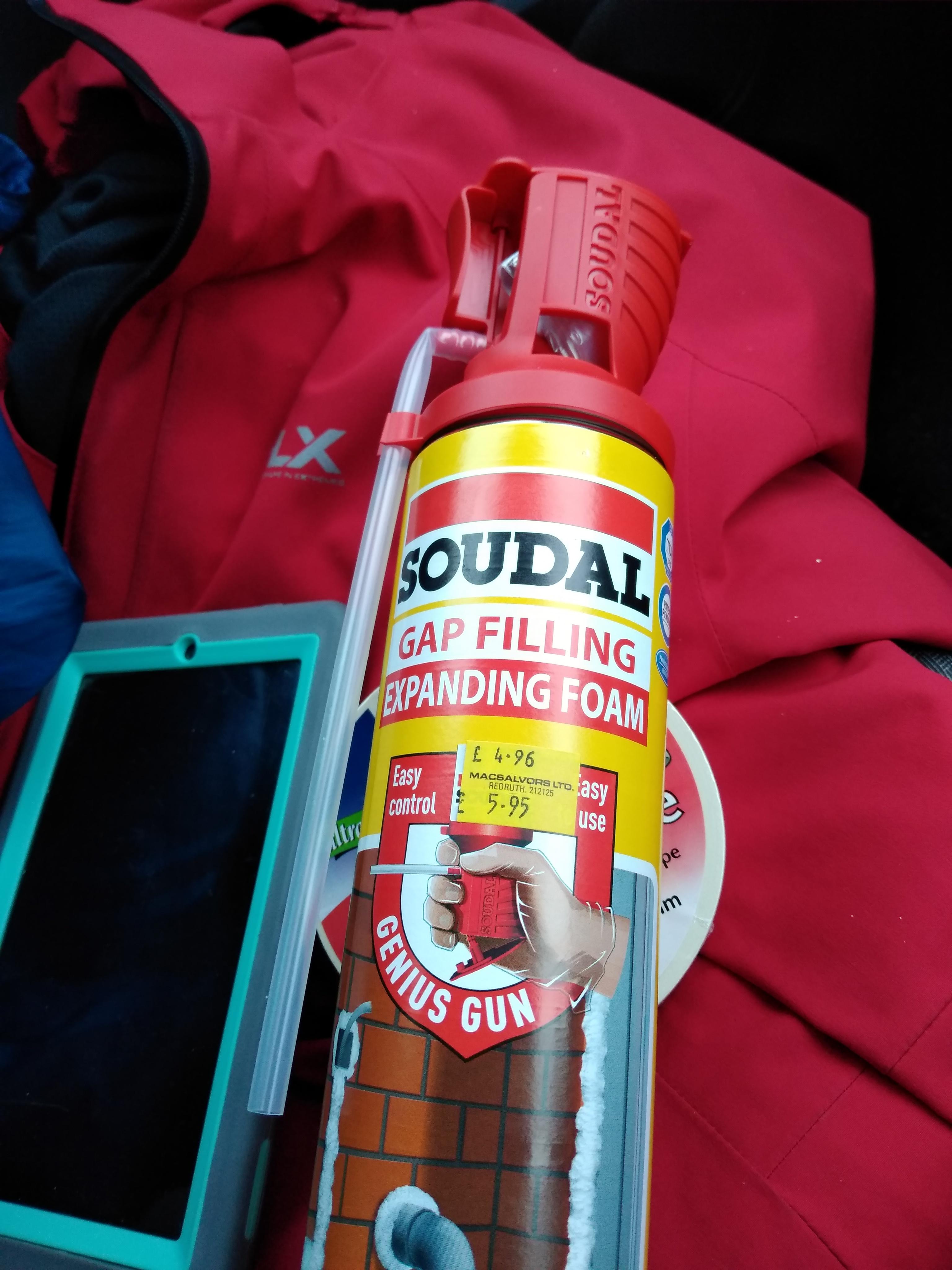

SteamyTea Posted January 20, 2021 Posted January 20, 2021 I hardly ever use my front door and porch. Partly because it is cold and miserable, even though it if SW facing. But now I have eventually got around to do a proper decorating job, I have found out why. Apparently the previous owner paid over £800 to have the door and frame fitted, and all that was keeping the weather out (remember it is SW facing in Cornwall, and I am at altitude) was some silcone on the internal plastic trim. Off to get some cans of foam now. Then I can try and work out why water gets into the actual door, and drains out when it is opened.

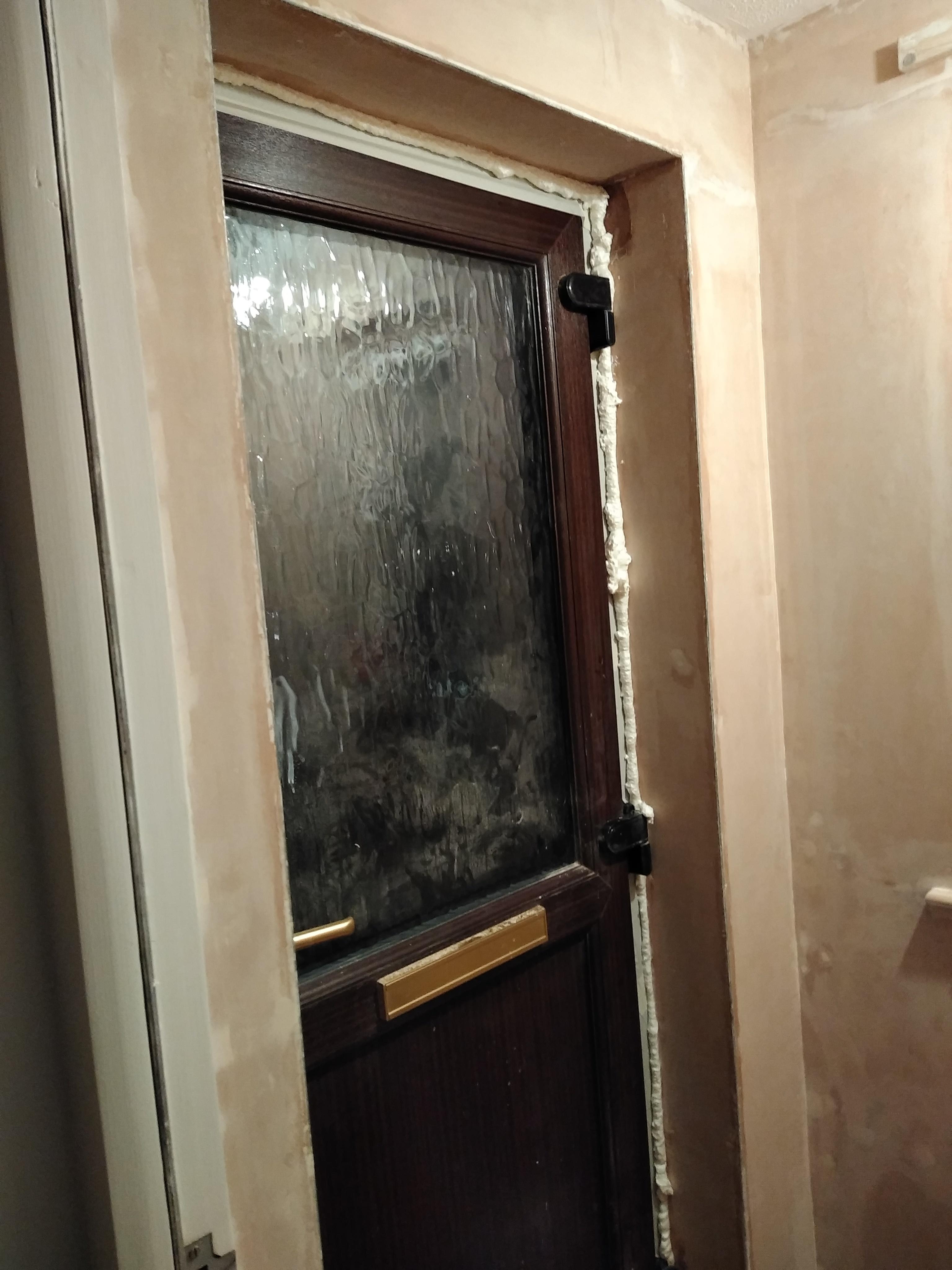

SteamyTea Posted January 20, 2021 Author Posted January 20, 2021 Semi inside would be the best description. It leaks water to. Should be fine as soon as I foam it all up. 1
SteamyTea Posted January 20, 2021 Author Posted January 20, 2021 Well filled the gaps, let's see what the morning brings. 1
