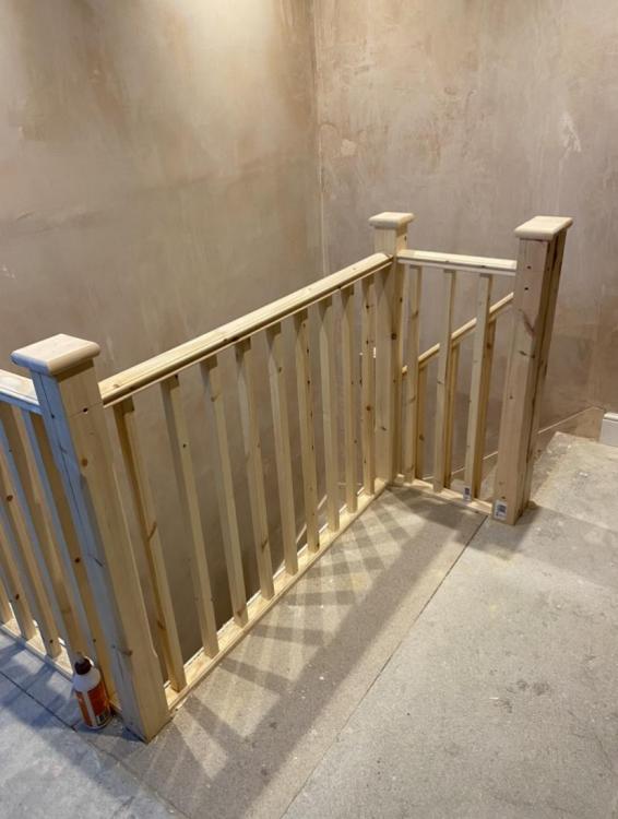

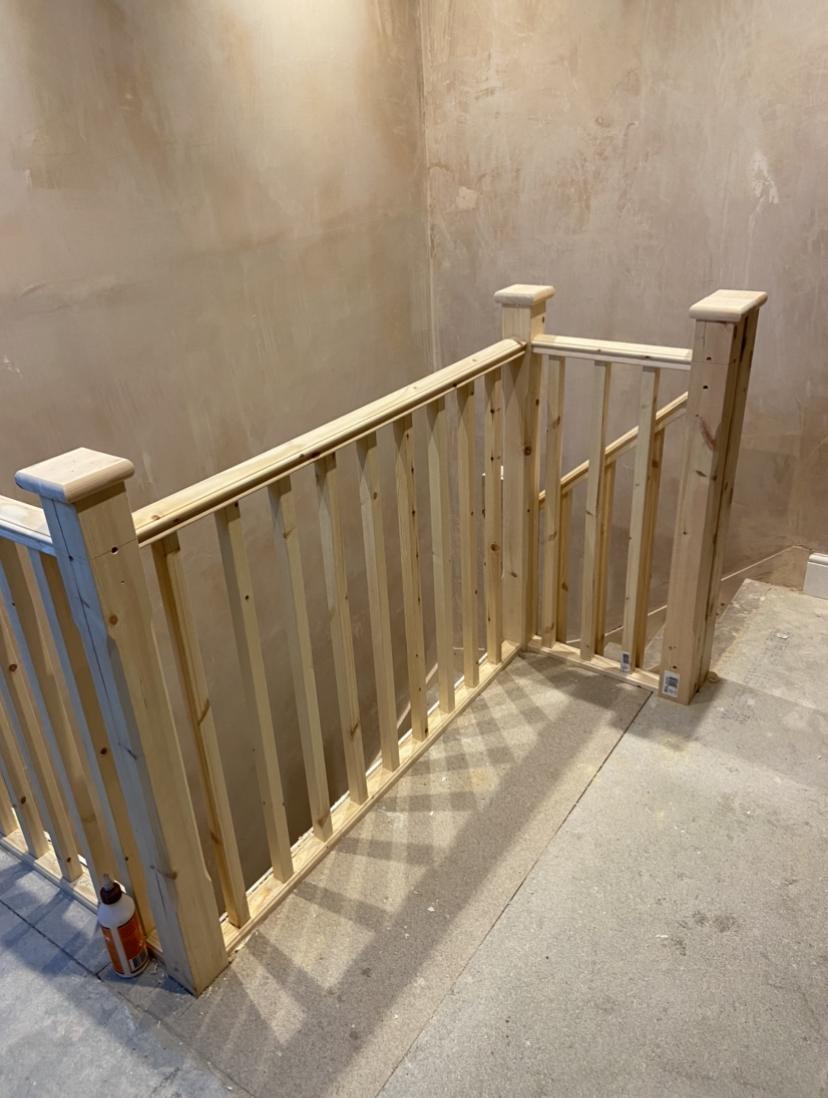

MarkB2610 Posted January 19, 2021 Author Share Posted January 19, 2021 2 minutes ago, Dave Jones said: put a door at top of stairs. get signed off. remove said door. It’s open plan with balustrade etc so not an easy fix - but one we will have to do if push comes to shove Link to comment Share on other sites More sharing options...
Dave Jones Posted January 19, 2021 Share Posted January 19, 2021 easy. screw a liner carefully into the opening so you only have screw holes to patch and then fit the cheapest fd30 howdens sell. half days work tops for a chippy. Link to comment Share on other sites More sharing options...

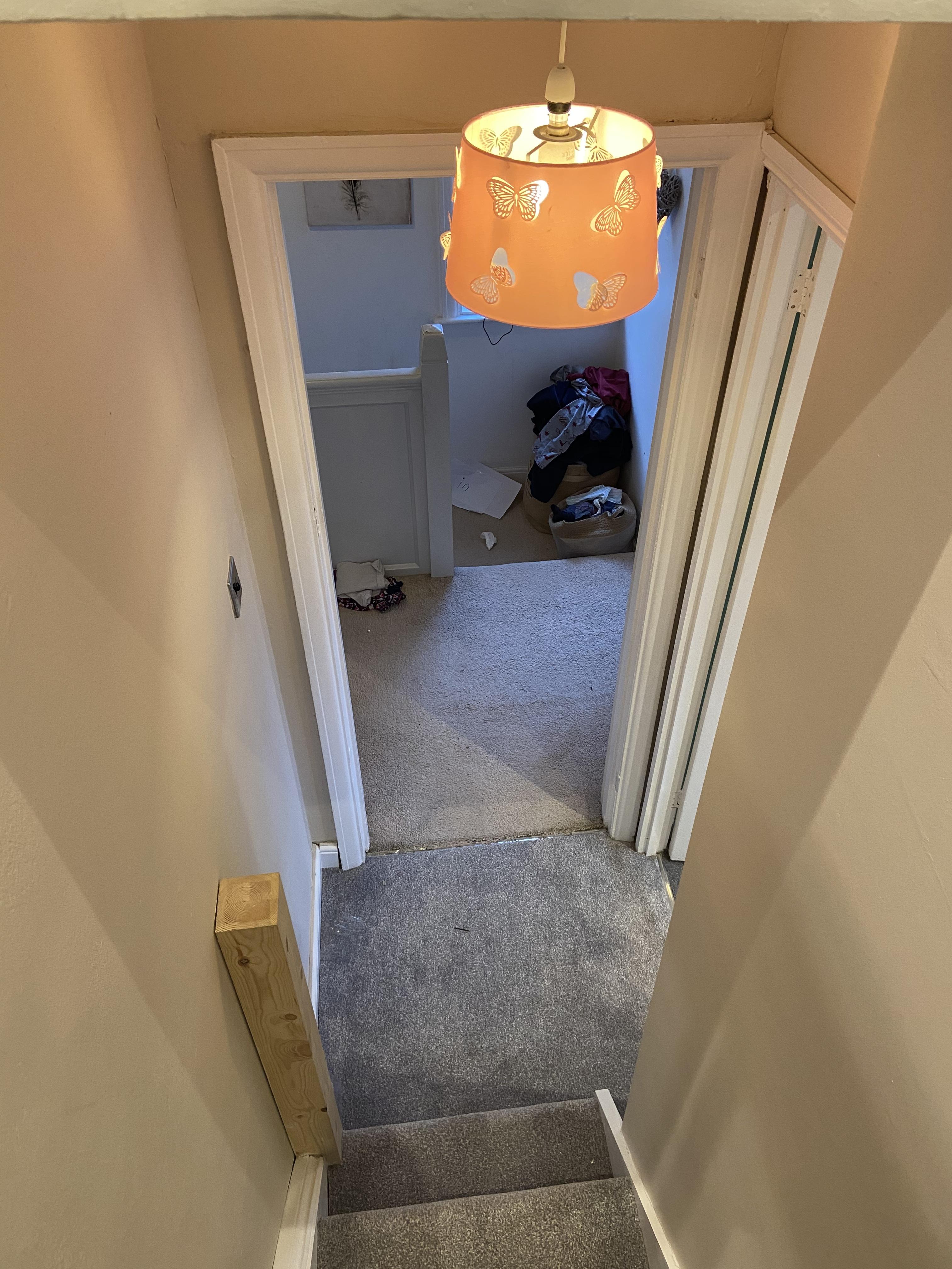

MarkB2610 Posted January 19, 2021 Author Share Posted January 19, 2021 3 minutes ago, Dave Jones said: easy. screw a liner carefully into the opening so you only have screw holes to patch and then fit the cheapest fd30 howdens sell. half days work tops for a chippy. Thanks... pre decoration it looked like this Link to comment Share on other sites More sharing options...
Dave Jones Posted January 19, 2021 Share Posted January 19, 2021 take carpet up. stud to the left and red plasterboard it, then liner. all unscrewable after. days work tops, pout it all in take photo or get BCO out then take it all down. pain in the arse but a days work tops so no real drama. Link to comment Share on other sites More sharing options...
MarkB2610 Posted January 19, 2021 Author Share Posted January 19, 2021 1 minute ago, Dave Jones said: take carpet up. stud to the left and red plasterboard it, then liner. all unscrewable after. days work tops, pout it all in take photo or get BCO out then take it all down. pain in the arse but a days work tops so no real drama. Ah right, ok thanks! A real PITA but worth it to get signed off Link to comment Share on other sites More sharing options...
Carrerahill Posted January 19, 2021 Share Posted January 19, 2021 (edited) 11 minutes ago, MarkB2610 said: Thanks... pre decoration it looked like this Ah - not impossible obviously but a bit more work than slapping a door in! OK - might not be so easy to bodge a door in... I personally would be investigating the BCO's involvement here, why was nothing said until now? What do you drawings show? If the proposed drg's are as you have now built and you have a BC stamp then raise this with him in as friendly a manner as you can. I had something similar, they asked about it right at the end, nothing in the drawings but suddenly he wants to see particular hold down ties - I wanted to reply and say, "Sorry, too late, you've missed the boat", but this is not the best approach with a council worker who you want to sign something off for you! Edited January 19, 2021 by Carrerahill Link to comment Share on other sites More sharing options...
