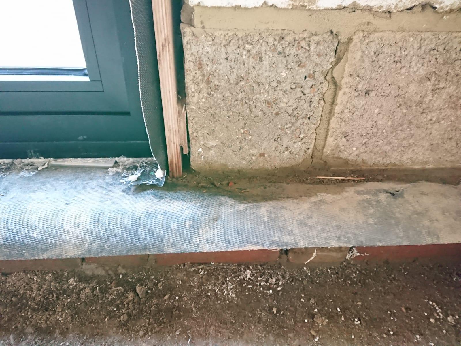

Jilly Posted January 18, 2021 Posted January 18, 2021 The new windows are great, but there are a lot of (some big) gaps between the ply (140mm block with external insulation covered with weatherboard). I'm quite sure the builder will squirt foam in there, but it seems crap and unpredictable. Is that the only way? You can see right through to the external insulation in places.
Onoff Posted January 18, 2021 Posted January 18, 2021 Decent foam, done right? is alright. Compriband BEFORE the windows/doors go in is better. Is it all going to be airtight taped? 1
Jilly Posted January 18, 2021 Author Posted January 18, 2021 (edited) Oh heck, done it again. My builder is clueless about all the things you lot worry about and I discover this things retrospectively. I've bought some Contega tape which a friend who has a Passivehouse recommended. What foams are the best as my builder will use nasty cheap stuff? Edited January 18, 2021 by Jilly
Onoff Posted January 18, 2021 Posted January 18, 2021 Illbruck is a name to conjure with. Really good stuff. They do airtight expanding foam and tape too similar to Compriband. <£10 a tin to go in a foam gun. A couple of quid cheaper you have Everbuild acoustic/airtight foam. We have a "window" man on here, can't recall his name, Craig? 1
craig Posted January 18, 2021 Posted January 18, 2021 (edited) That's unfortunate and not a lot you can do with it now in all honesty. However, I would recommend squirting Illbruck FM330 in the gaps and on the inner side 15mm - 7/12 TP600 compriband. You can't do a lot at the blocks other than trim the compriband. Then over that I would apply ME508 airtightness tape. I would also suggest buying ME902 primer before sticking the airtightness tape onto the blockwork. He has something running up vertically, not sure what type of tape it is but it doesn't look like it is doing anything tbh. Edited January 18, 2021 by craig 1

TonyT Posted January 18, 2021 Posted January 18, 2021 24 minutes ago, craig said: That's unfortunate and not a lot you can do with it now in all honesty. However, I would recommend squirting Illbruck FM330 in the gaps and on the inner side 15mm - 7/12 TP600 compriband. You can't do a lot at the blocks other than trim the compriband. Then over that I would apply ME508 airtightness tape. I would also suggest buying ME902 primer before sticking the airtightness tape onto the blockwork. He has something running up vertically, not sure what type of tape it is but it doesn't look like it is doing anything tbh. Looks like it’s the external facade wrap 1

Jilly Posted January 19, 2021 Author Posted January 19, 2021 (edited) Nope there's been no talk of airtightness, looks like we don't need the trickle vents! I'm going to talk to the builder and maybe do this bit myself with foam, tape and primer... Edited January 19, 2021 by Jilly
