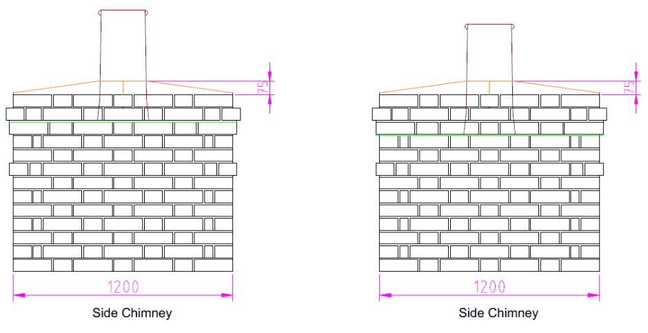

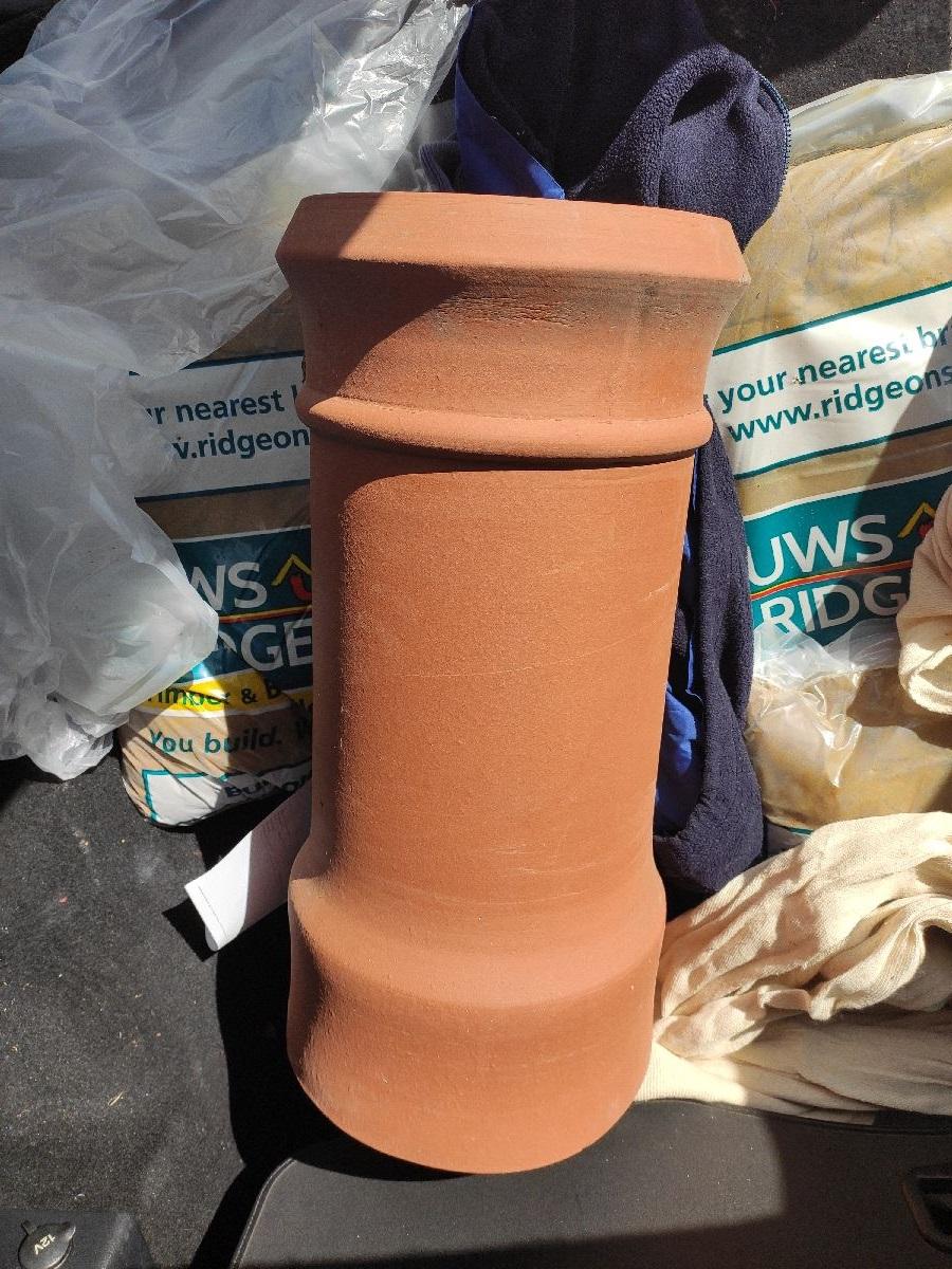

MortarThePoint Posted March 21, 2021 Author Share Posted March 21, 2021 I think this is where I have got to with the design now, a couple of options:. Is 75mm the right sort of height for the flaunching? The pot is a 600mm Red Bank Canon: Link to comment Share on other sites More sharing options...

epsilonGreedy Posted March 21, 2021 Share Posted March 21, 2021 How much were the pots, the ones I am looking at are nearly £100 and I need 5. Link to comment Share on other sites More sharing options...
MortarThePoint Posted March 21, 2021 Author Share Posted March 21, 2021 2 minutes ago, epsilonGreedy said: Any risk that a chimney sweep brush will catch the wedges and bend them down? The wedges are up the outside of the flue liner which passes through them and on a little higher. That means the brush doesn't get near them Link to comment Share on other sites More sharing options...
MortarThePoint Posted March 21, 2021 Author Share Posted March 21, 2021 2 minutes ago, epsilonGreedy said: How much were the pots, the ones I am looking at are nearly £100 and I need 5. £55+VAT each I think from Civils and Lintels. I need to track down the receipt. Link to comment Share on other sites More sharing options...
MortarThePoint Posted March 21, 2021 Author Share Posted March 21, 2021 Need to be careful buying the Red Bank Canon as lots of places say they have it and it turns out to be the Contemporary Canon instead. Can't remember the codes, but essential to check before travelling. Link to comment Share on other sites More sharing options...

MortarThePoint Posted March 22, 2021 Author Share Posted March 22, 2021 3 hours ago, Declan52 said: Both. Do you think 75mm high enough for the flaunching on a 1.2m wide chimney stack with one pot? Link to comment Share on other sites More sharing options...

Declan52 Posted March 22, 2021 Share Posted March 22, 2021 1 hour ago, MortarThePoint said: Do you think 75mm high enough for the flaunching on a 1.2m wide chimney stack with one pot? When you come to do it you will be able to gauge it much better when your up there. Might need some more to make such a heavy pot secure but without being able to see it from below. Link to comment Share on other sites More sharing options...
MortarThePoint Posted March 22, 2021 Author Share Posted March 22, 2021 1 minute ago, Declan52 said: When you come to do it you will be able to gauge it much better when your up there. Might need some more to make such a heavy pot secure but without being able to see it from below. I'll be at the mercy of the brickie so will specify "at least 75mm" Link to comment Share on other sites More sharing options...
