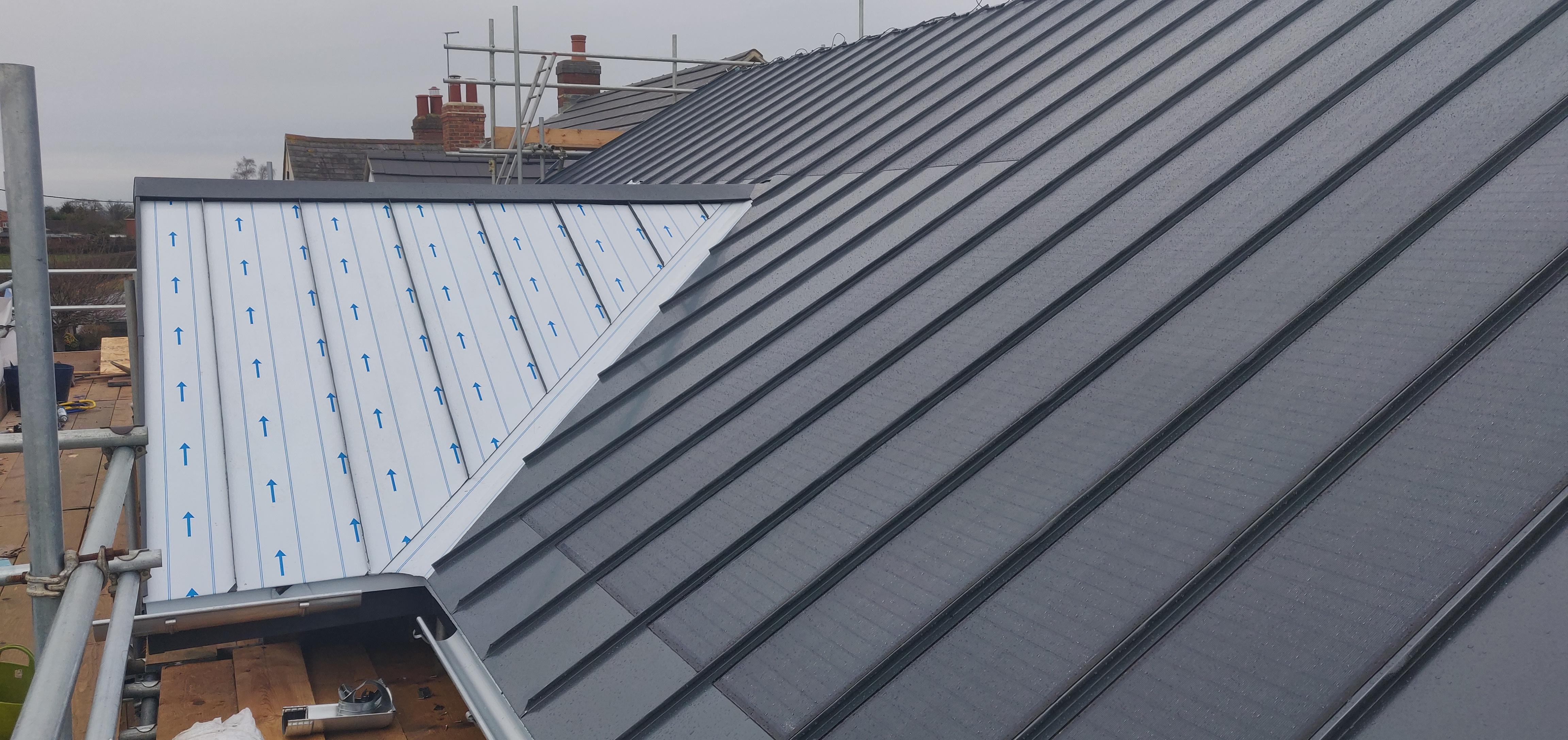

GaryM Posted February 8, 2021 Posted February 8, 2021 @Kevin Jlooks good. My Bipvco panels are being installed as I type. It turned out my roof was a bit too complex for the snap fit system. So I've Zenith Zinc fitting a coated aluminium standing seem roof and I have Paul from Gribben Solar Roofing doing the solar. At the moment they attaching the solar panels to the roof panels in my hallway. I'm excited, I think it will look great (well I hope so) 1

GaryM Posted February 8, 2021 Posted February 8, 2021 (edited) 6 hours ago, gc100 said: Am I right in thinking that the zinc/metal panels must be sent to Bipvco to get the PV fitted? Or can I order the PV and fit/glue myself? How do you get a quote from them? Sending then to Bipvco is an option, or get the roofing supplier to do it, we changed steel suppler so found someone else to do it. The surface should be tested first, then in a warmish room the an activator is needed and then the PV panels can be stuck to the metal. Because I wanted to ensure it is done correctly we got Gribbens to do it for us. I got my quote from Badclad, who said there were the sole supplier, but I have a feeling if you approached metal solutions they would be able to quote. Or give Paul Gribbens a call at Gribbens Edited February 8, 2021 by GaryM

GaryM Posted February 8, 2021 Posted February 8, 2021 @gc100 It can be done but not ideal, I suggest you give Paul Gribben a call at gribbenroofing 07881095628, he has been very helpful to me 2

GaryM Posted February 16, 2021 Posted February 16, 2021 I'm really pleased with the way the solar panels and roof is looking 4
Kevin J Posted February 19, 2021 Posted February 19, 2021 Super invisible, great shot. Look forward to seeing it when the scaffold is down
