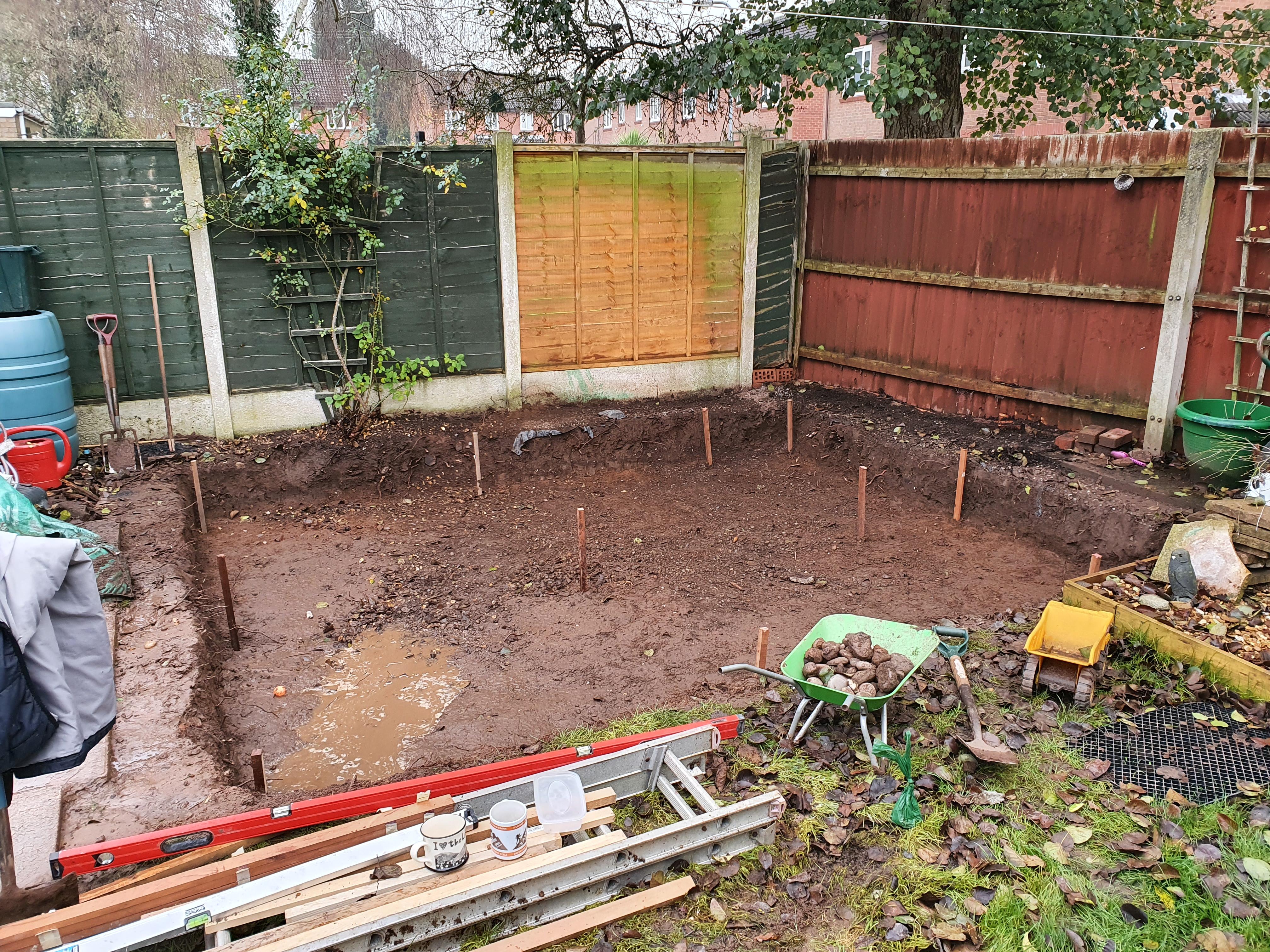

Stanley36 Posted January 2, 2021 Posted January 2, 2021 Hello all,happy new year I'm in process of building a 4mx3.5m garden room to house a few aquariums. Im wanting to do a concrete slab that finishes just above the surrounding land and have the concrete as the floor inside the room this will help with the 2.5m height ive got to work with. I've dug the area deep enough to allow 150mm of compacted type 1 mot......25mm sand 100mm insulation and 150mm of concrete. However ive joined a group on Facebook for home builds/offices etc and had a few people say that a slab built in this way won't be strong enough. The walls will be 2x4 then osb and cedar cladding and roof 2x6 with osb then rubber so not exactly light but far from weight of brick building. Ive been advised to do trench foundation and blocks to height of floor then concrete in the middle, is that really necessary for wooden building? Id also like to insulate underneath the slab, ive seen videos of people lining the bottom and sides of the form with insulation boards and then pouring the concrete onto this. Would this be good way to do it? As you can probably tell im no builder ?(car trade) and im quite confused as the best way to do it. If someone could help me out or point me in the right direction it would be much appreciated. Thanks ?
PeterW Posted January 2, 2021 Posted January 2, 2021 No idea who’s told you a 150mm slab is too thin but they don’t know what they are talking about ..!! There are houses on here built on less ..! If you want an insulated slab then you need to work out how to finish the sides of the insulation - with a 50mm insulation upstand you could put the walls over this and run the cladding down lower but you will need to find a way of finishing below ground (cement board may work) as timber will rot. Have you sketched any plans ..? And what’s the insulation going in the walls ..?? 1

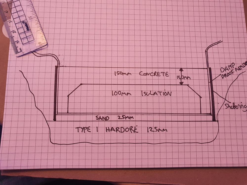

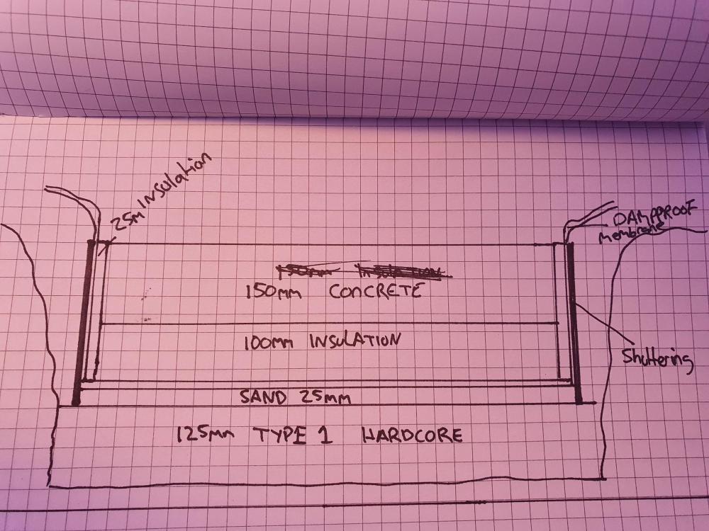

Stanley36 Posted January 2, 2021 Author Posted January 2, 2021 Thanks Tony Please excuse the poor drawings but these were 2 of my ideas. I was told that building walls on the edge of the slab would cause the edges to crack. open to any criticism or advice ?

TonyT Posted January 2, 2021 Posted January 2, 2021 A252 mesh was the reinforcing and will help the slab. don’t see a problem with either drawing for structural but insulation in a slab may affect and I’ve not done insulated slabs.

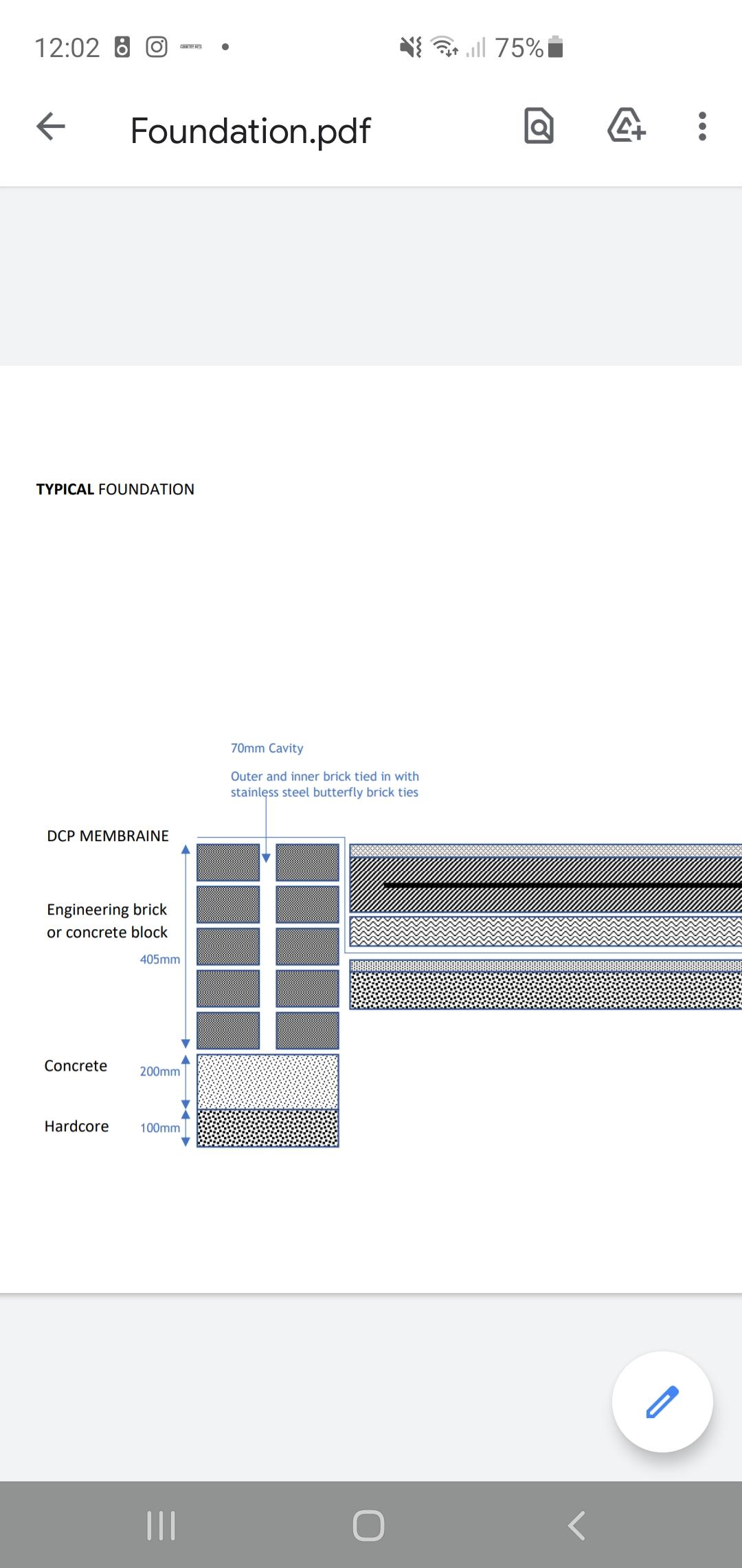

Stanley36 Posted January 4, 2021 Author Posted January 4, 2021 This is the way I've been advised to do it? Can I ask your professional opinion on this is this overkill or the best way to do it
PeterW Posted January 4, 2021 Posted January 4, 2021 @Stanley36 that’s overkill. You could lose the inner bricks and just line with insulation and a DPM and fill with 100mm concrete.
Stanley36 Posted January 4, 2021 Author Posted January 4, 2021 Thanks, would concrete blocks work instead of bricks?
Mr Punter Posted January 4, 2021 Posted January 4, 2021 If you cast the slab unreinforced onto insulation and build up to the edges it will probably break. The insulation under slab designs here have quite complex insulation and concrete specs plus reinforcing. I would go with 100-150mm concrete cast on the type 1, 2 or courses single skin brick perimeter or 7.3n blocks if you prefer. 112mm dpc. Treated timber sole plate held down via straps. Timber framed walls. The bottom of the sole plate must be at least 150mm above finished ground level, 225mm preferred. DPM in middle, lapped to DPC. EPS floor insulation (or whatever is cheapest) in middle. Polythene sheet, 22mm T & G chipboard flooring. You could screed but probably overkill and not easy to DIY.
