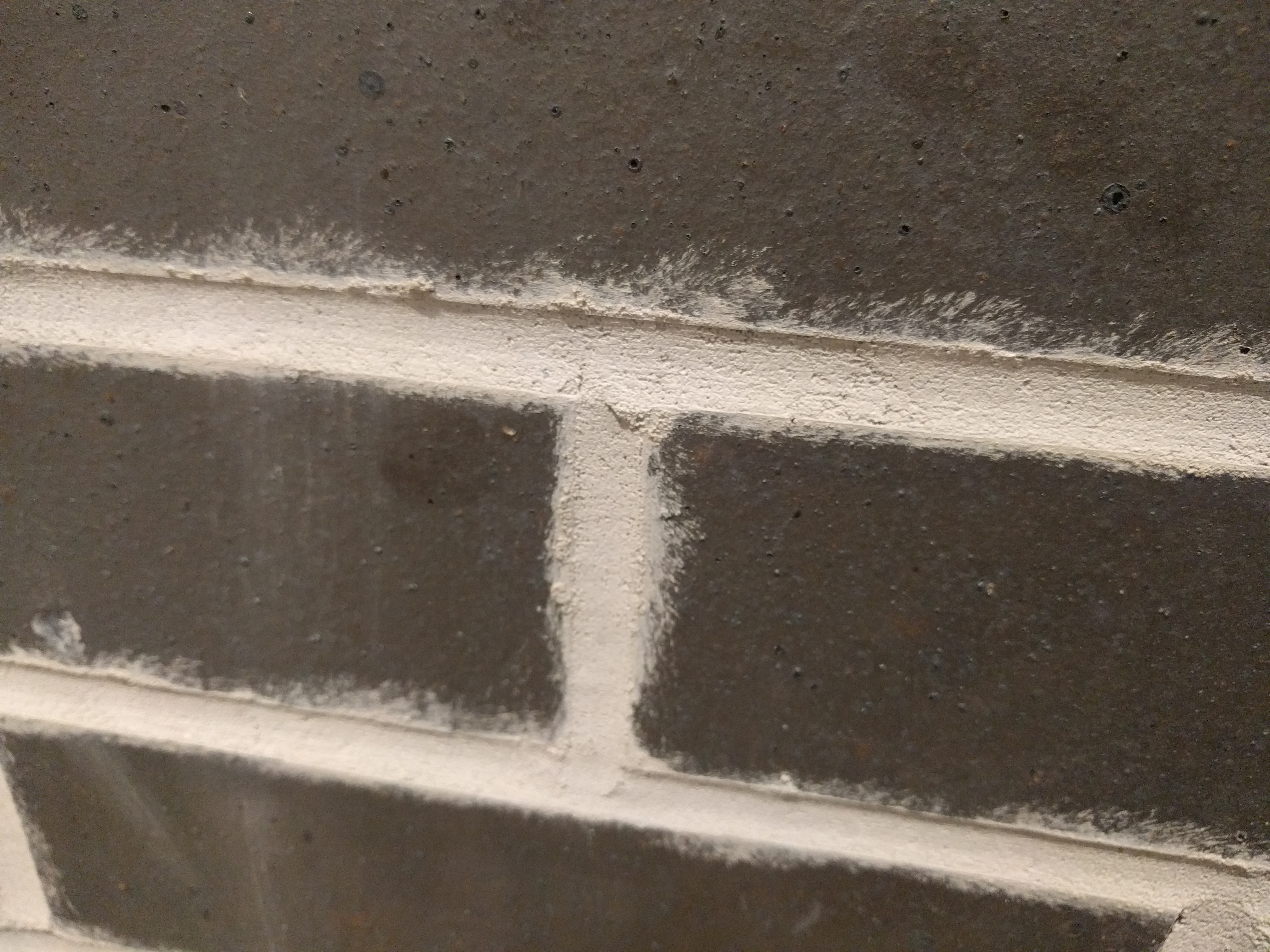

jack Posted January 30, 2017 Posted January 30, 2017 Hi all We're starting to work our way through the outstanding to-do list. A few of these tasks have been put off because they're awkward or we're not sure how to approach them for one reason or another. I'm going to try and start posting questions about these so that I have one fewer excuse to not do them! So this one relates to cleaning brickwork. We have a couple of internal feature walls that are covered in stafford blue brick slips. They mirror the part of the house outside that has the same. We went for a light grey coloured mortar, but we learned from the outside clean-up that the colour doesn't survive acid-washing, so it's gone back to a more natural colour (which, as at happens, we prefer anyway). We now want to clean the inside slips. Here's what we have: My question is how best to clean this off given that we're inside. I can use an acid- based cleaner, of course, but does anyone have any tips on things like: whether or not to get something with detergents (rather than plain old brick acid) or thickening agents what sort of dilution, if any, we should be looking at what precautions we should take, other than the usual eye protection, decent gloves and old clothing to what extent should I be worried about fumes - what sort of mask should I consider, and should I be concerned about leaving things like furniture in the room? how much rinsing should I aim for? We're working inside so obviously we can't just blast it with a hose! Assuming I can get it properly clean, is it strictly necessary to rinse it? HCl is a gas, so perhaps it'll just disperse on its own given time... Depending on the answers to these questions, I was considering chipping away at lunchtime each day and properly cleaning a section at a time, working from the top. That would give time for it to disperse each day before starting again the following day. Any reason not to take this approach? If you can think of anything else I should be considering, fire away! Many thanks, as always

Jeremy Harris Posted January 30, 2017 Posted January 30, 2017 (edited) Hydrochloric acid. Sold in 5 litre drums in Wickes, et al specially for the job as, unsurprisingly, brick and mortar cleaner! Just use it carefully! It's already diluted and don't add anything to it, in case it creates a reaction. It should do the job on its own with a bit of patience and scrubbing. It works because mortar (well, the cured cement in it) is soluble in most acids, and bricks, being fired clay, aren't. It will dissolve the mortar if you're heavy handed with it, and you do need a stiff brush, long sleeved rubber gloves, eye protection and ideally something like a rubber or plastic apron to stop the stuff making holes in your clothes. Easy to use, and should clean those bricks up better than most, because of their hard finish. You have to pick the sort of firm bristle brush carefully, I managed to melt an old washing up brush because the acid attacked the plastic bristles. It doesn't seem to attack the bristles on a stiff yard broom I have, the type that look "natural". It's easiest to spray on with a small spray bottle, and do a small area at a time until you get a feel for it. It can be quite hard work. Don't be tempted to use power tools. Years ago I tried a steel wire brush in a drill with the stuff, cleaning old render off a granite wall. It throws small drops of acid everywhere (seems obvious now, but didn't to me when I was in my 20's.................). Edited January 30, 2017 by JSHarris

jack Posted January 31, 2017 Author Posted January 31, 2017 Thanks all. 16 hours ago, JSHarris said: Hydrochloric acid. Sold in 5 litre drums in Wickes, et al specially for the job as, unsurprisingly, brick and mortar cleaner! Yes, that's the sort of stuff I was trying to compare to ordinary muriatic acid. They seem to be a bit coy on the websites about HCl concentration, but I did see one product that was around 9% HCl, so about a quarter the concentration of muriatic. I'm not sure what else is in it though. My main concern about using something like this is the potential for residues given that I can't exactly hose down as I go, hence my reference to: whether or not to get something with detergents (rather than plain old brick acid) or thickening agents Maybe these products are just watered down acid, in which case it's really cheeky charging more than the price of muriatic for the same size container at a quarter the concentration! But if they do have detergents in them, then it might be better getting plain muriatic and watering it down. 16 hours ago, Mikey_1980 said: I used these LTP Scourers for cleaning our external engineer brickwork, maybe less chance for acid flying anywhere with no bristles. http://www.ebay.co.uk/itm/LTP-Emusifying-Scourer-Black-Pad-Coarse-Texture-/200805084725 They look perfect for the job, thanks for the tip! 15 hours ago, recoveringacademic said: And @jack, don't decant the HCl into a container with a leak in; even a pinhole-size leak eh?. Oh no! Photos?
Jeremy Harris Posted January 31, 2017 Posted January 31, 2017 I'd not use detergents, as you've no idea how they will react, just use the stuff sparingly, and rinse off with a damp sponge. One thing to watch will be concrete polished floors, as the stuff probably attacks them too, as it dissolves cement pretty well.

jack Posted January 31, 2017 Author Posted January 31, 2017 1 hour ago, JSHarris said: I'd not use detergents, as you've no idea how they will react, just use the stuff sparingly, and rinse off with a damp sponge. I'm not talking about adding detergents as a separate product, I'm concerned that some of these "brick cleaner" type products (as distinct from plain acid) will include detergents in them. But short of going to somewhere that sells this stuff and checking the ingredients list, I don't know whether they do. Might just need to bite the bullet and drive to somewhere that sells it. 1 hour ago, JSHarris said: One thing to watch will be concrete polished floors, as the stuff probably attacks them too, as it dissolves cement pretty well. This is one of my major concerns, as there's polished concrete flooring along all the walls that need washing. Shouldn't be too hard to protect. 1 hour ago, Ashburyselfbuild said: You could try this stuff, it is acid free. I used it to clean up an old mixer with great success. http://www.ebay.co.uk/itm/Cement-Concrete-Grout-Mortar-Dissolver-Remover-for-Tools-Buildings-Garden-650ml-/111785451126?hash=item1a06ee9e76:g:ROkAAOSwBLlVeGRr Interesting looking stuff, thanks.
Jeremy Harris Posted January 31, 2017 Posted January 31, 2017 I'll have a look at the ingredients list later, as I have a 5 litre can of the Wickes stuff. I'm near-100% sure that it's only diluted HCl, with nothing added, though, as I remember checking before using it to re-balance the pH in our well.
jack Posted January 31, 2017 Author Posted January 31, 2017 Thanks Jeremy. As it happens, I just had a look and notice that there's a Safety Data Sheet linked from the Wickes site. Apparently it's 5-10% HCl (so perhaps around the 9% HCl I saw somewhere on a similar product), so as you say, dilute acid only.
Jeremy Harris Posted January 31, 2017 Posted January 31, 2017 (edited) Beat me to it! I'm just back and was going to say the same. Taping some polythene sheet down well should protect the polished concrete; polythene is not affected by HCl. I think those scouring pad things that Mike linked to should be ideal, then just a bucket of water and a sponge to rinse the brickwork off. If you just let the dilute HCl evaporate off it won't leave any toxic residue behind, but rinsing with a damp sponge will just remove the dissolved mortar. With a bit of luck, using is sparingly like this you shouldn't get the discolouration you saw outside, as I suspect that was most probably the HCl dissolving out the white pigment, which may well have been something like hydrated lime, which is highly soluble in HCl. If you have the patience, it might be and idea to just try and clean each slip one by one, trying to keep the HCl off the mortar joints. I have a feeling that this white mortar is probably pretty soluble in it, and so may just almost wipe off. Edited January 31, 2017 by JSHarris typo - missed out an important "not"!
jack Posted January 31, 2017 Author Posted January 31, 2017 Thanks Jeremy, the polythene sheet was already in the plans. Thankfully we still have a gap between bottom of the wall and the concrete floor, so I should be able to work it so that any wayward drips get directed away from the junction onto the sheet. And yes, based on what we saw outside the colouring comes straight off (glad we paid extra for coloured mortar!) I actually prefer the raw mortar - looks more natural - so am going to experiment somewhere out of the way to see what it looks like if I clean the mortar as well. I do plan to do this in sections so I can chip away at it a bit every day rather than tackling the whole job at once.
