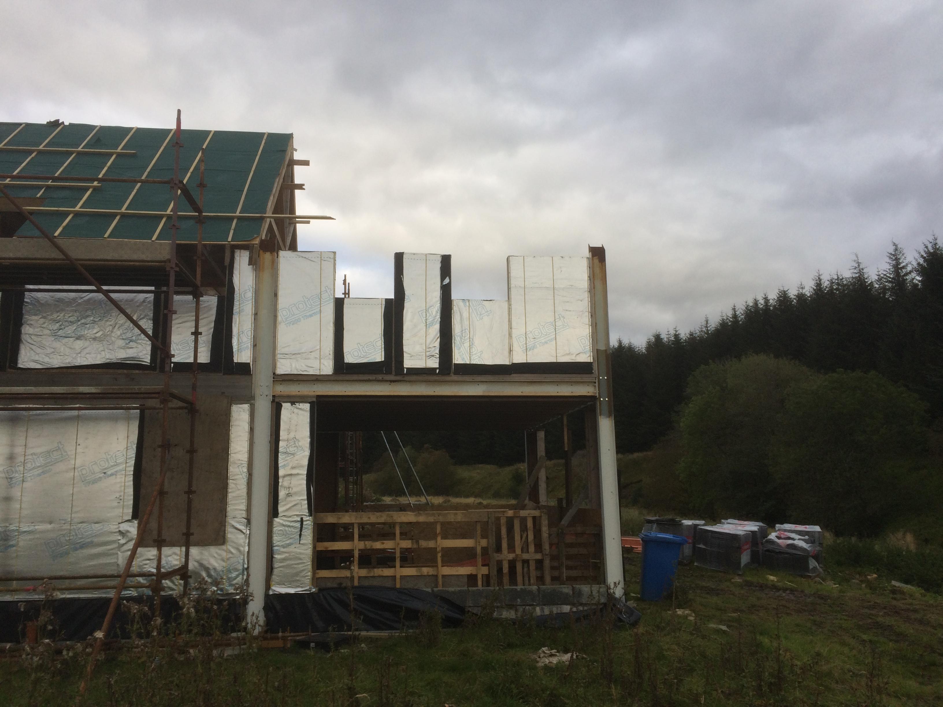

Hi I have a timber frame house that has a portal frame in it as well.  The house has a 50mm cavity.
The Steel I beams should the be insulated in the cavity.  At the minute we have some of the, insulated and some not and all are covered by breathable membrane.
i am not 100% sure to insulate them or not due t moisture and just let them have air flow to keep them dry and insulated in the inside of the house or it does not matter.
thanks

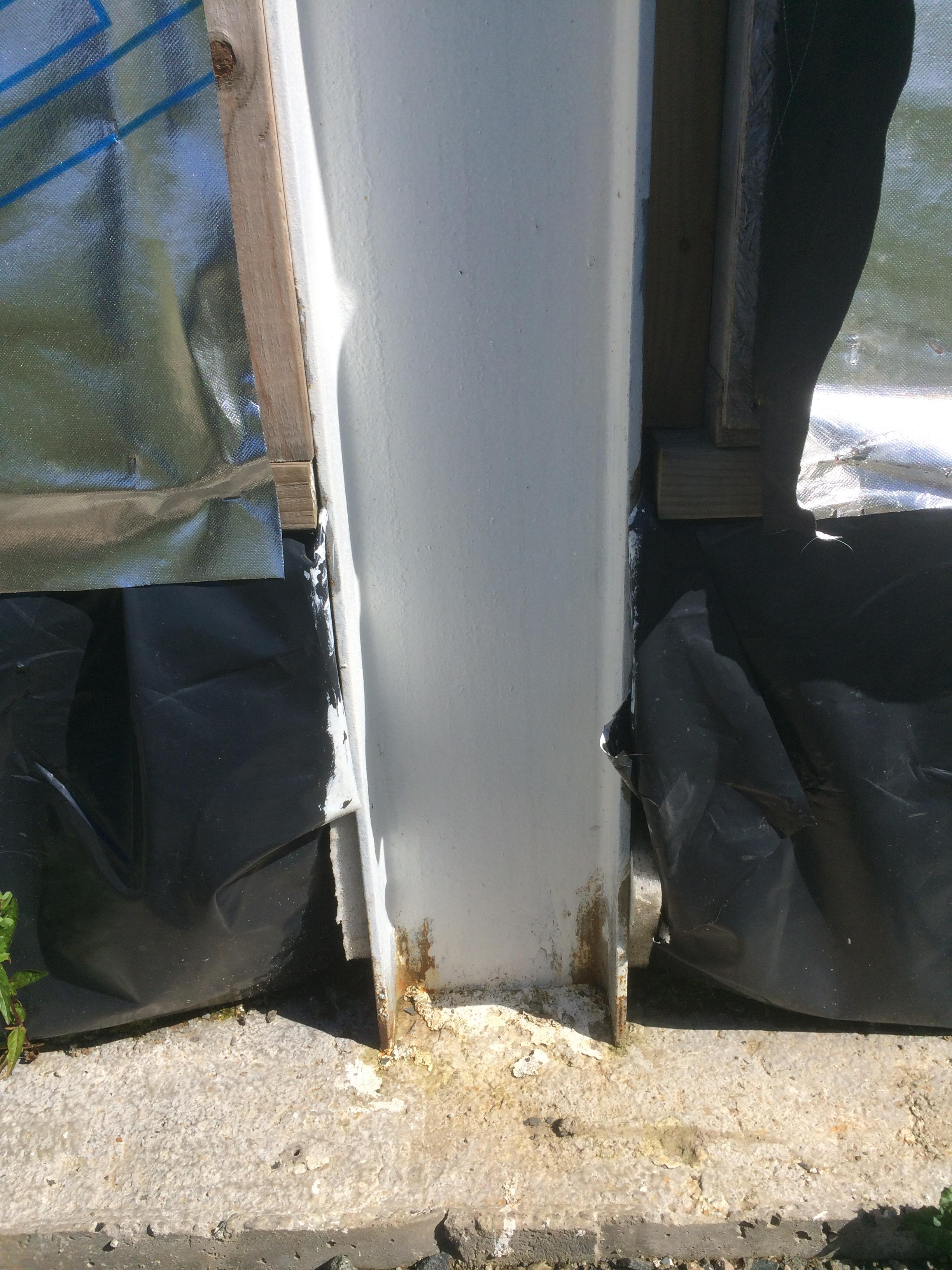

Hi, the white paint is meant for corrosion protection.  The builder that put the portal frame up did not paint the steel that went in the ground so raw steel is concreated in.
I am worried about water coming in from the outside,and corroding the steel.  As there is block or timber clad and a 50 mm cavity water should not be able to get to the steel I hope.    Some of the steel has breathable membrane over it and some has not and some is painted and some is not and been blocked in.

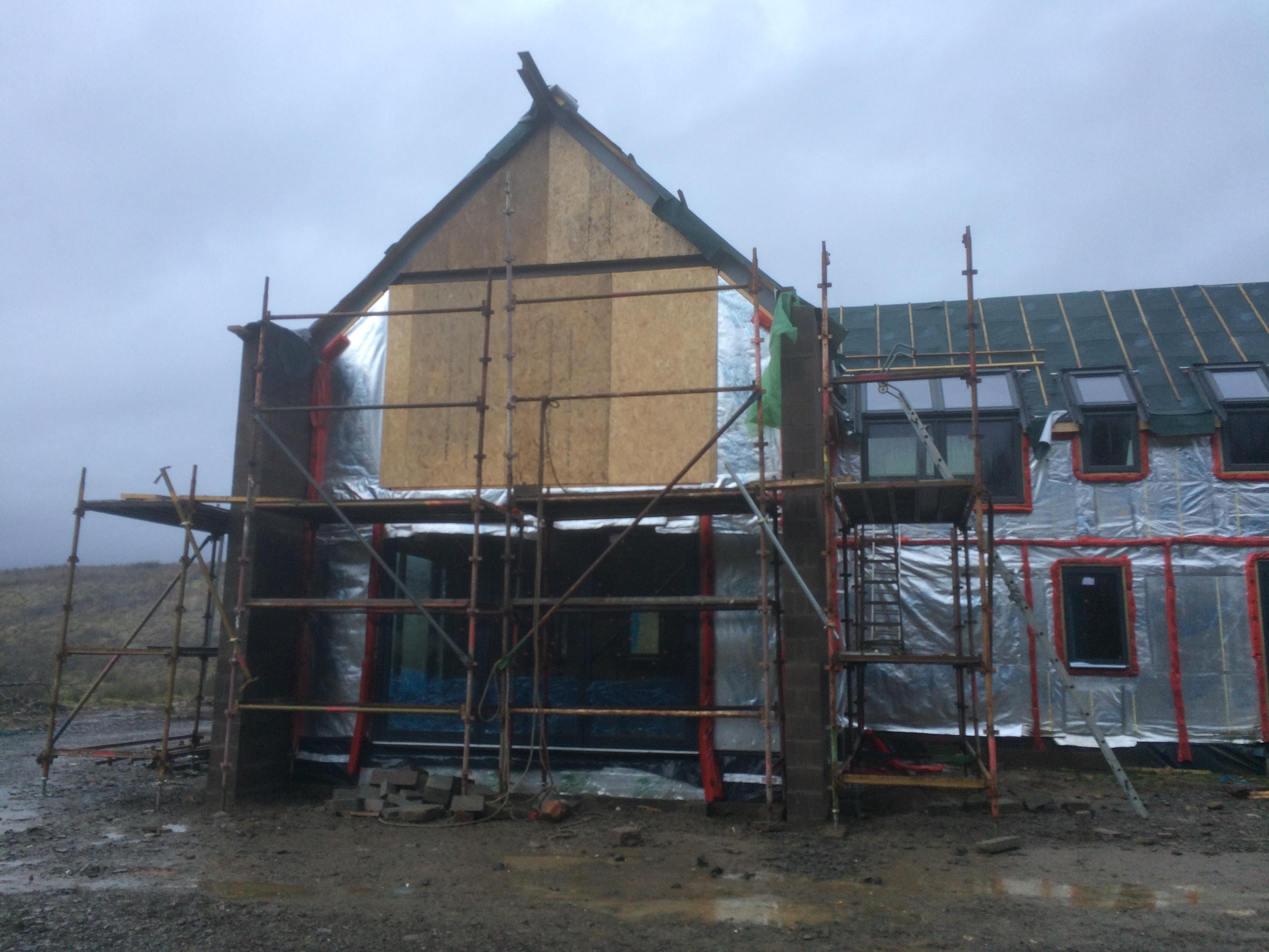

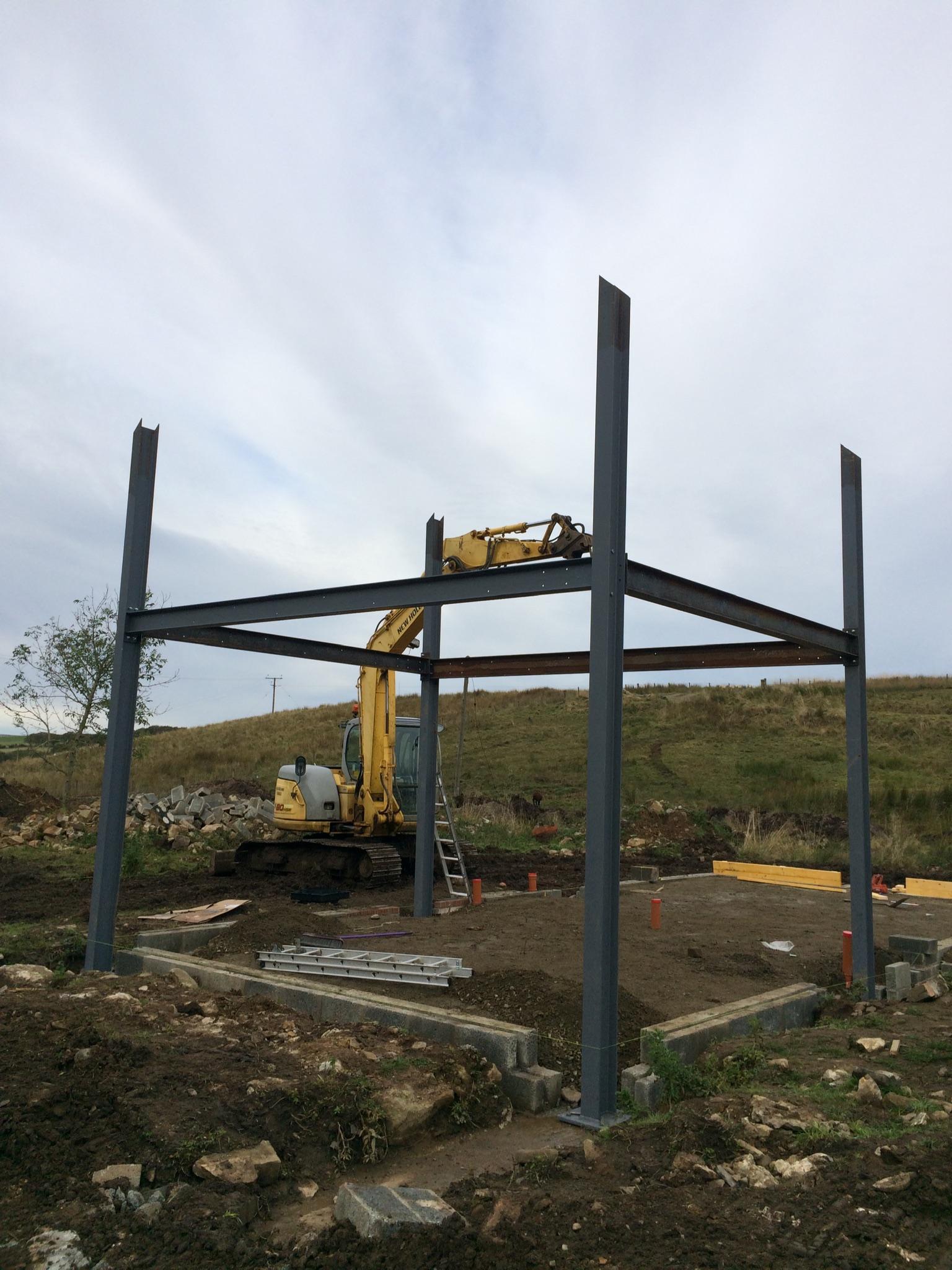

Attached is some of the steel erected and another of what it looked like a few weeks ago.
Edited by GrantMcscott

That looks great, enjoyable to see folk embracing the portal frame principle. Good size house! You have two slightly types of portal as one seems to be creating a large volume, the other supporting a floor.. for the keen the two types of frame perform in different ways depending on the floor level.
It kind of looks like a Scottish landscape the trees and grass, maybe Wales I don't know. And that leads me to the steel corrosion. I'll take stab in the dark here but it looks like you may have had some tree stub muncher in so it's hard to see the soil, but looking at the type of trees it may be that you have a shallow clay soil, a bit sandy maybe. If so the soil is likely to be a little acidic such that it promotes a little corrosion compared with a more alkali soil like limestone. I would have a look at the SE spec not just for the steel but also for the grade of concrete used under the ground. If the grade of concrete is high then that may indicate aggresive ground re corrosion potential.. ask your SE. If you are in Scotland then this steel protection should have been speced to get your Building Warrant and the Builder should have followed this specification.
It may be that the the detailing is such that the steel is ok re corrosion. Interestingly @Jilly was posting about something similar recently.
I would have a word with your SE, if the builder has deviated from the spec then discuss. There are often easy solutions to this.. sometimes you just need to re appraise and all is proved to be ok.
The SE may say.. don't worry there is plenty sacraficial steel available to deal with the corrosion so cart on. They may say..mmm I don't know. In this case ask why then raise the possibilty of introducing some cathodic protection. You can find info on this on the web but it't just like protecting a boat from corrosion and it should not be horrifically expensive especially if you good wet clay soil.. There are members of this site that know about all about the physics of this. But simplistically (I think) you could just bury some lumps of zinc  in the ground and electrically bond this to the frame, (check with the Electrician if need be so that what you are doing is compatible with their work) make a note to monitor every five years and get on with enjoying what looks like is going to be a great new home.
Hopefully this is some reasurance.

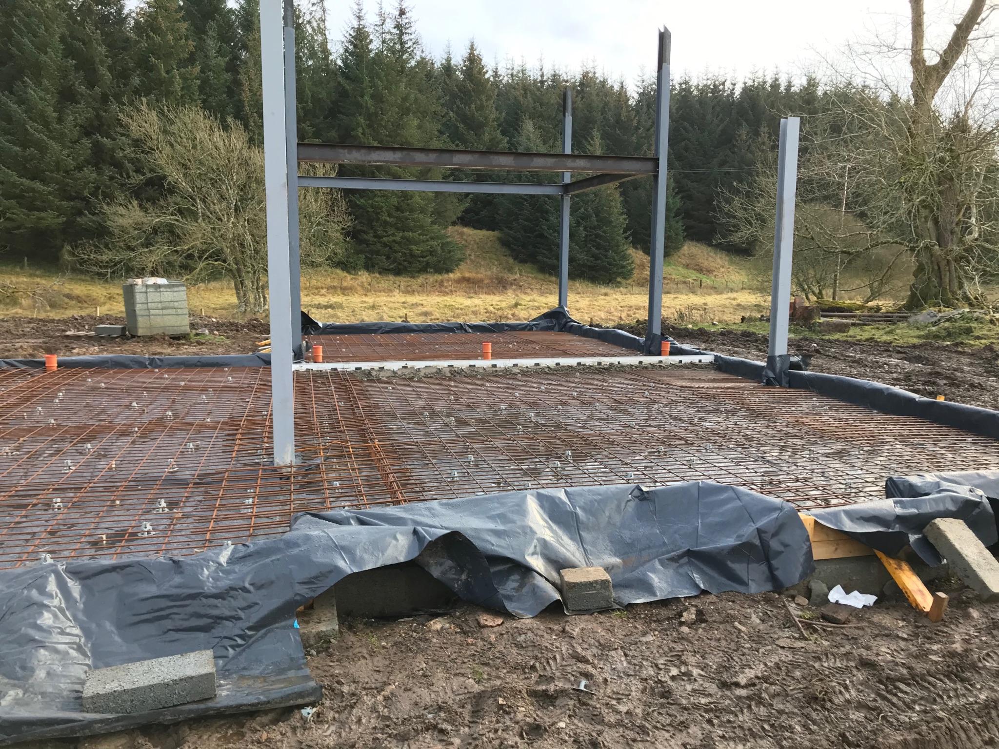

The steel well encased in concrete so no way to get protection to it now, and Architect says it should out last my lifetime.  There was a SE spec but builder ignored it.
here is a pick of it going in and in some places there is a metre of concrete below it.
Ground is very wet and I will be draining round the house.

Don't worry too much about the steel that is encased in the concrete.
For all, one way to look at this is as follows. For simple domestic stuff it's a bit of a rule of thumb. You'll often see that simple strip foundations have mesh in them. For foundations bearing on the soil the cover to the steel is often specified as being a minimum of 75mm. Roughly the first 25mm is to account for the fact that the machine you dig the found out with can't reasonably get closer than 25mm tolerance (much worse in real life) and pratically ~ 50mm is to account for a bit of the "nesting" of the reinforcement when you lap mesh etc and for soils that are a bit aggresive to concrete) it's all a bit vague. However, roughly the main thing is that is you have a good couple of inches of concrete round your steel and this protects the steel from corrosion for a good while.
Grant.. you can see here that once the columns are embedded in the concrete pads that part of them will be ok. It's the little bit just above the top of the concrete that is a little more vulnerable. Practically, your Architect is in my view is on the right side of the argument.. but a key question may be.. will they take that on under their PI cover.
The steels in the photos seem to have been reasonably primed , it's just that some of this seems to have been abraded at the bottom when the founds were poured. If push comes to shove then it's a question of examining how much if any of the steel is in direct contact with the soil, the soil type, how much is in the cavity and protected to some extent and how much on the inside is in contact with the inert fill under the floor. This information would be used to underpin an evidence based argument should someone (BC) query the view that the steels as they are good for the design life of the house.
