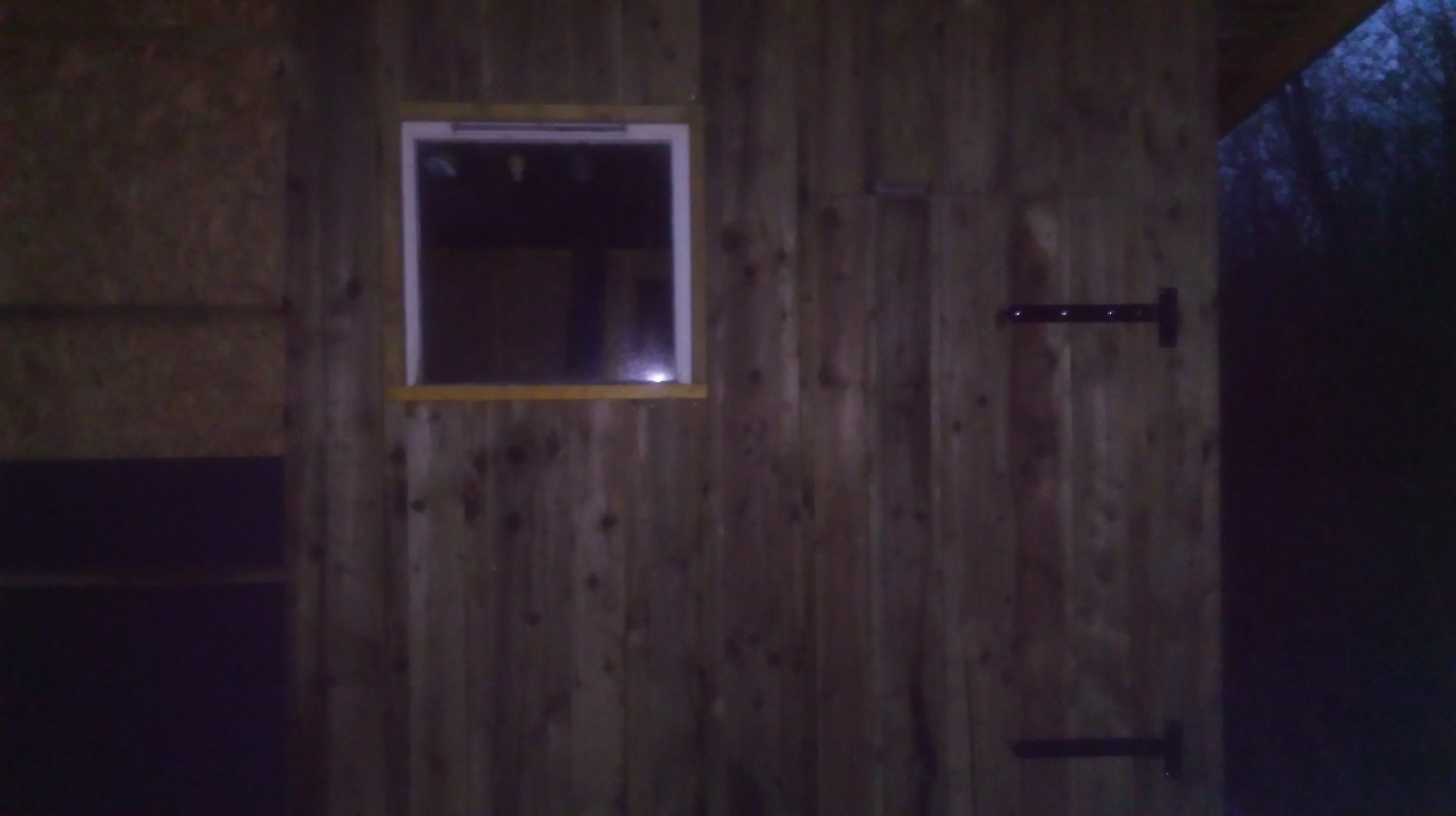

Tennentslager Posted January 29, 2017 Share Posted January 29, 2017 Rubbish pic as it was getting dark but went for a *hidden* door on the shed...although the hinges spoil the hidden effect just a tad? Link to comment Share on other sites More sharing options...

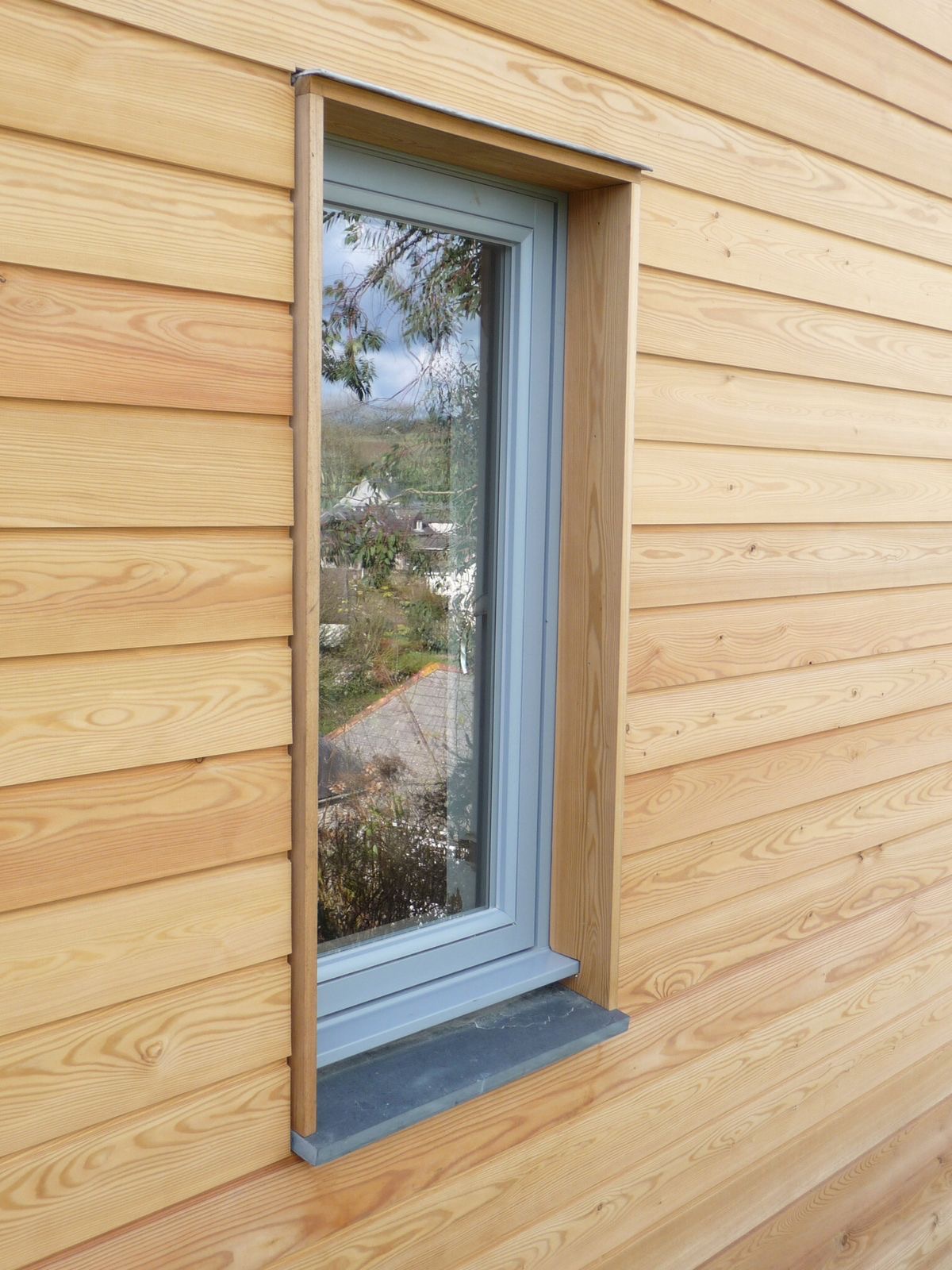

Triassic Posted January 30, 2017 Share Posted January 30, 2017 This is what I did Link to comment Share on other sites More sharing options...

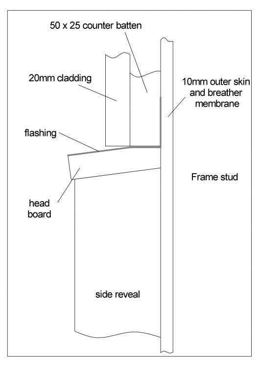

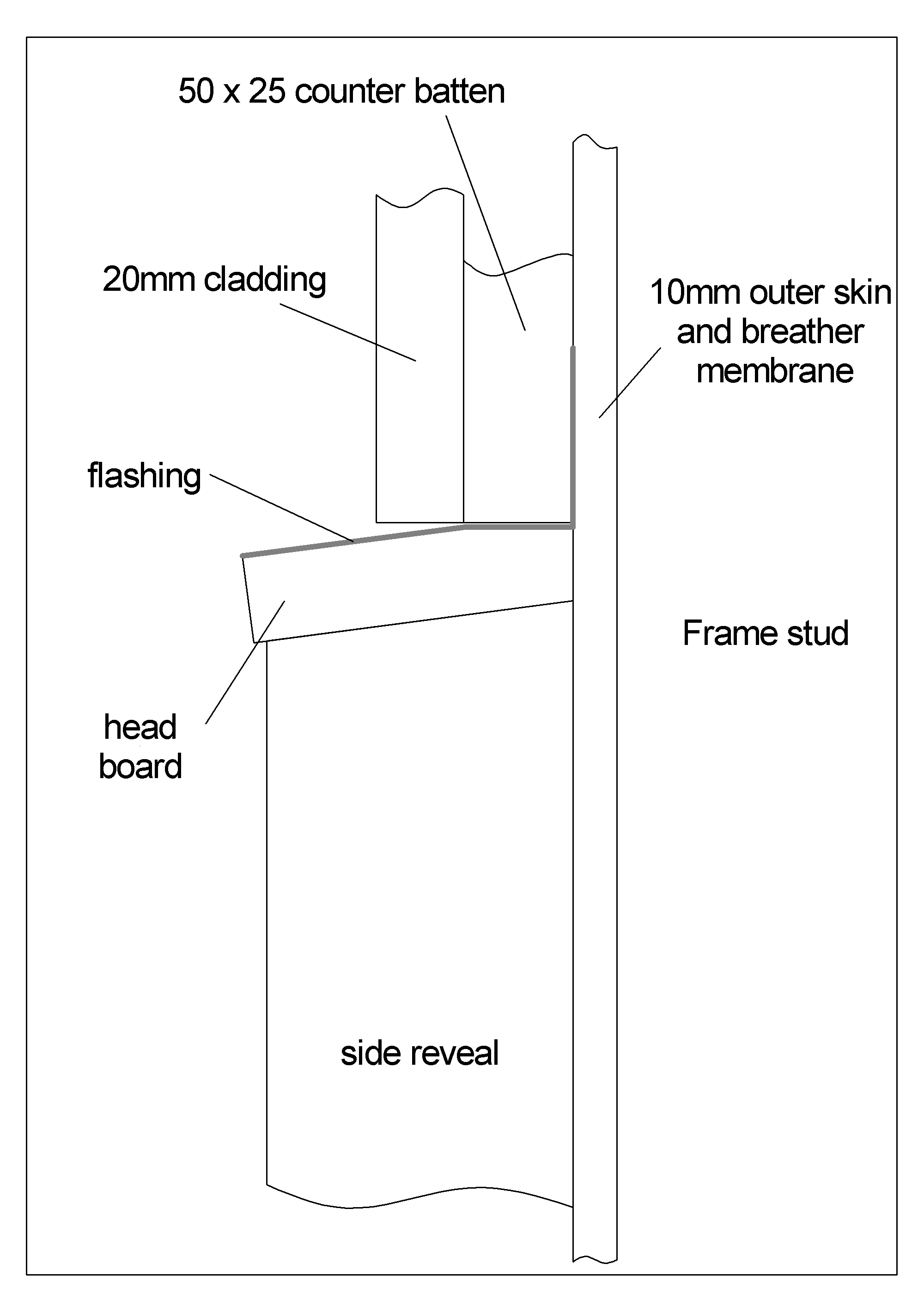

Jeremy Harris Posted January 30, 2017 Share Posted January 30, 2017 (edited) We found that getting a neat finish where the boards around the reveal abut the window wasn't that easy. In our case we have windows with integral cills, so the lower part of the reveals at the sides was easier to cut than those shown above, but I didn't like the idea of just a bead of sealant to fill the corner. I found a supplier of small section black PVC angle, 6mm x 6mm x 1mm, and bonded this with clear neutral cure, high modulus, silicone into these corners. It was a bit fiddly, but I'm glad I did it as it looks neater than a bead of sealant, I think. This is a section of the way we finished the head of each opening: Edited January 30, 2017 by JSHarris Link to comment Share on other sites More sharing options...
Crofter Posted January 30, 2017 Author Share Posted January 30, 2017 That's a slightly different aspect of the detailing but a very useful one, thanks. I used black Siga Wigluv tape to seal the join between the window and the frame, and the reveal boards should hide that. Te plan had been to run a bead of sealant but the PVC strip seems quite interesting. Link to comment Share on other sites More sharing options...
