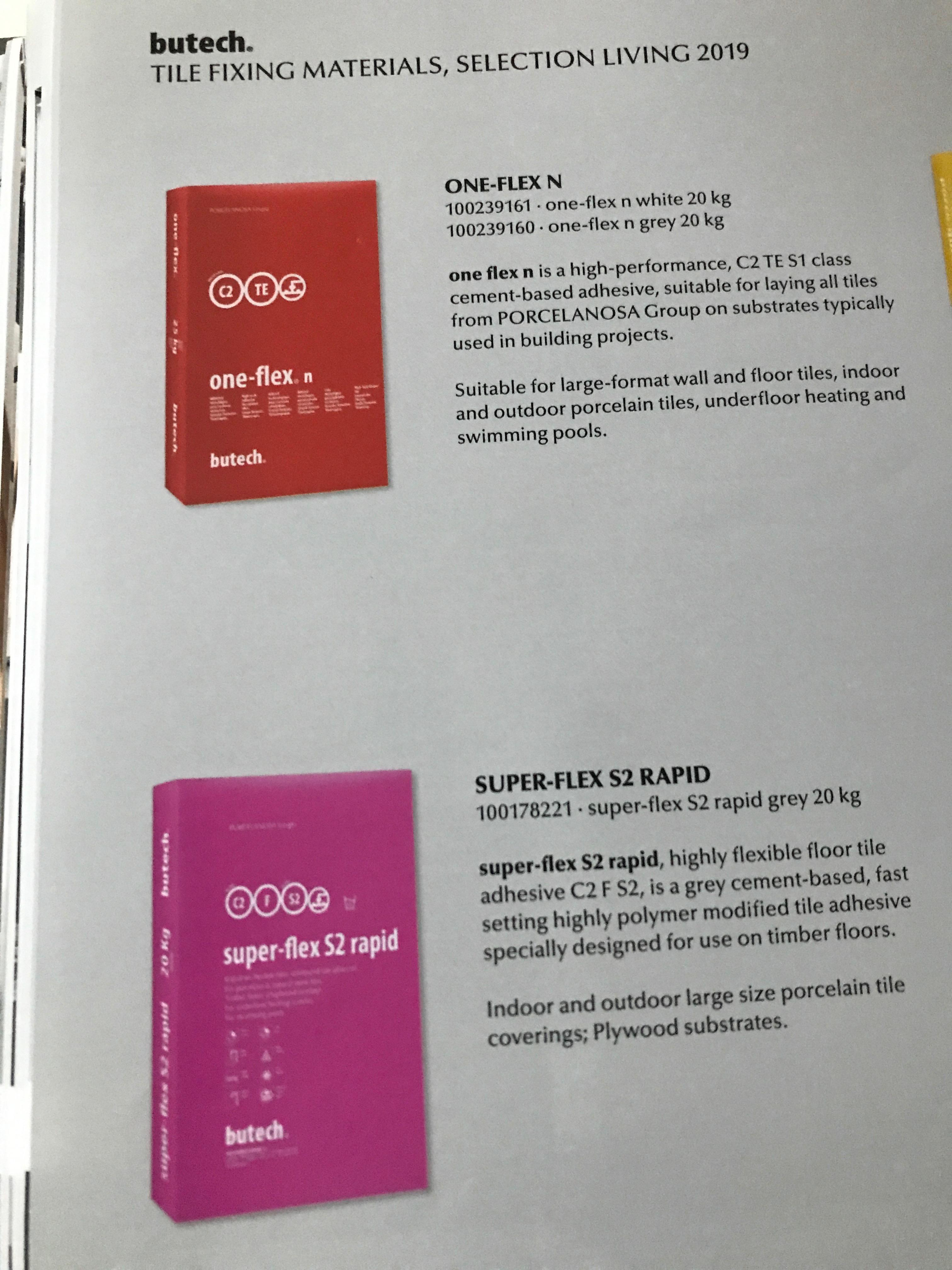

Taff Posted December 30, 2020 Share Posted December 30, 2020 So we’ve received the tiles prior to crimbo they came with the recommended adhesive see pic. Ineed to crack on with the tiling as the A’s the cooker is being delivered early Jan. I’ve phoned our suppliers helpline however they are on their jollies. our setup for the floors are block and beam with a screed downstairs with UFH. Upstairs are egger boards or similar over low profile UFH boards. ive been sent 2 types am I right in thinking one flex is the product to use on the downstairs concrete floor, super flex s2 on wood upstairs. I’ve read instructions a few times and yep I’m so confused. Any help/guidance appreciated ? Link to comment Share on other sites More sharing options...
PeterW Posted December 30, 2020 Share Posted December 30, 2020 Yes correct. What primer have you got for the wooden floor ..? Link to comment Share on other sites More sharing options...
wozza Posted December 30, 2020 Share Posted December 30, 2020 S1 tile adhesives are deformable and withstand deflection of more than 2.5mm and less than 5mm. S2 tile adhesives are deformable and withstand deflection of more than 5mm. Are you using a decoupling matt? Link to comment Share on other sites More sharing options...

PeterW Posted December 31, 2020 Share Posted December 31, 2020 13 minutes ago, Taff said: I haven’t purchased the primer just any recommendations? Whatever the adhesive manufacturer recommends ..? They say Uniprim which you may struggle to find but looks remarkably like the Mapei Primer-G available in most areas. Link to comment Share on other sites More sharing options...
Nickfromwales Posted December 31, 2020 Share Posted December 31, 2020 I’d be worried about tiling straight onto the Egger boards over the overlay UFH system as that’ll usually be running a higher flow temperature. I would either use a mat or overboard with a 4mm marine grade plywood glued ( PVA ) and screwed with screws on 120mm centre X & Y minimum. If the Superflex is 2-part then you may get away with it directly onto the deck boards. Are they 18mm or 22mm ? Link to comment Share on other sites More sharing options...

Taff Posted December 31, 2020 Author Share Posted December 31, 2020 6 hours ago, Nickfromwales said: I’d be worried about tiling straight onto the Egger boards over the overlay UFH system as that’ll usually be running a higher flow temperature. I would either use a mat or overboard with a 4mm marine grade plywood glued ( PVA ) and screwed with screws on 120mm centre X & Y minimum. If the Superflex is 2-part then you may get away with it directly onto the deck boards. Are they 18mm or 22mm ? Sorry I explained wrongly. The egger floor went down first as that was part of the sips. We then put low board 18mm down with the UFH installed. Then the 4mm ply went down screwed at the correct points. so from your advice I think we’ll mat upstairs over the ply, so would I need primer prior to placing the mat down? 1 Link to comment Share on other sites More sharing options...
wozza Posted December 31, 2020 Share Posted December 31, 2020 50 minutes ago, Taff said: so from your advice I think we’ll mat upstairs over the ply, so would I need primer prior to placing the mat down? Yes - the primer is used to ensure a good bond - whether its tiles or matt you should use primer - its not that expensive and its easy to apply. Link to comment Share on other sites More sharing options...

Nickfromwales Posted January 1, 2021 Share Posted January 1, 2021 (edited) On 31/12/2020 at 16:02, Taff said: Sorry I explained wrongly. The egger floor went down first as that was part of the sips. We then put low board 18mm down with the UFH installed. Then the 4mm ply went down screwed at the correct points. so from your advice I think we’ll mat upstairs over the ply, so would I need primer prior to placing the mat down? Were all the layers bonded to the sips / between layers? Eg no movement when you walk on the floor? Edited January 1, 2021 by Nickfromwales Link to comment Share on other sites More sharing options...
Taff Posted January 1, 2021 Author Share Posted January 1, 2021 1 hour ago, Nickfromwales said: Were all the layers bonded to the sips / between layers? Eg no movement when you walk on the floor? Yep all tight the floor was part of the sips installation they wouldn’t erect the structure without it Link to comment Share on other sites More sharing options...
Nickfromwales Posted January 1, 2021 Share Posted January 1, 2021 1 hour ago, Taff said: Yep all tight the floor was part of the sips installation they wouldn’t erect the structure without it Then I’d say the mat may be omitted over that then. Is the plywood top layer glued and screwed well? Link to comment Share on other sites More sharing options...
Taff Posted January 4, 2021 Author Share Posted January 4, 2021 Yes it is glued and screwed there doesn’t seem to be any movement either. When the primer goes down how long should o leave it until I can start to tile. I’ve read the data sheet however, it doesn’t state wait times Link to comment Share on other sites More sharing options...
