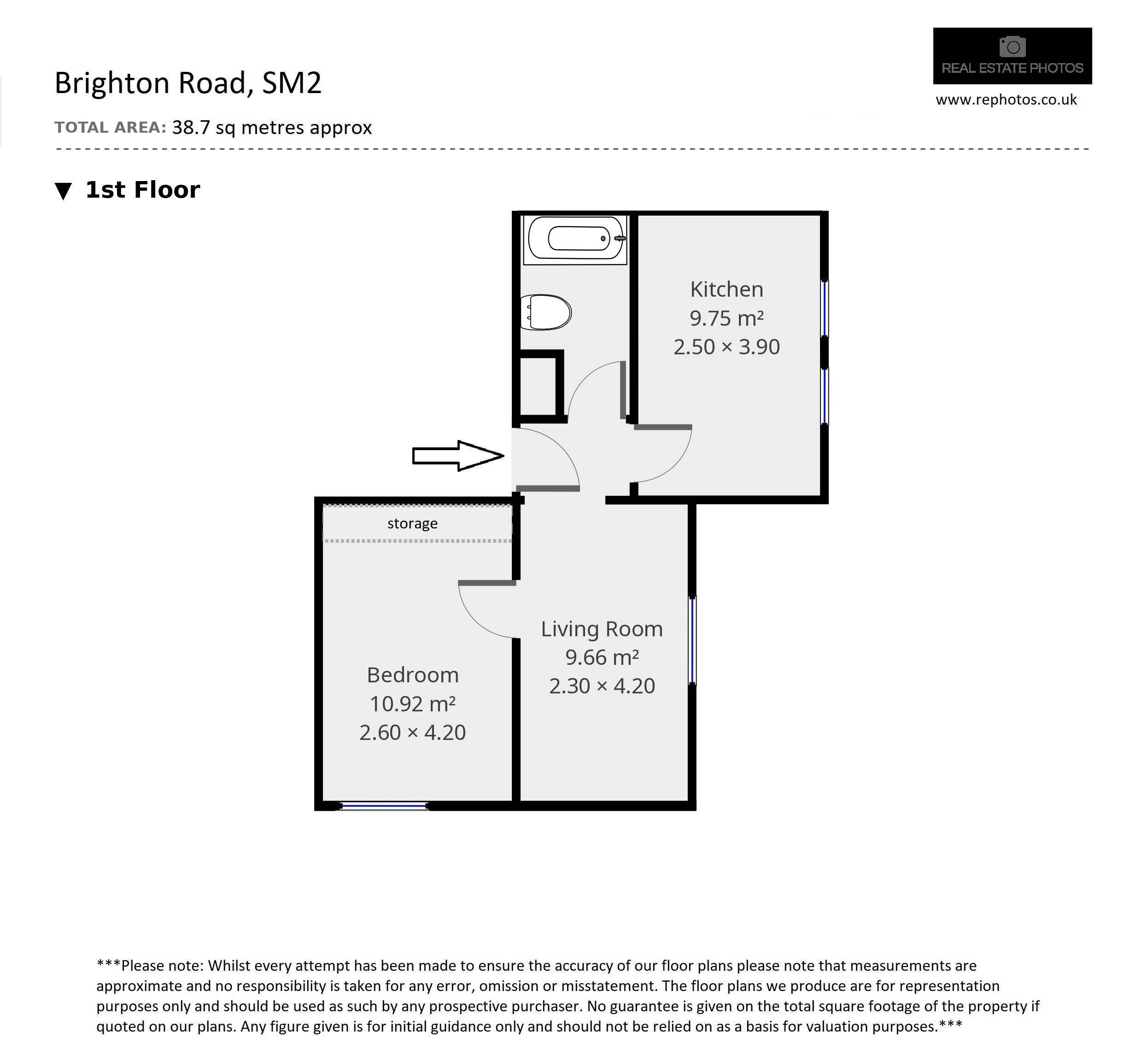

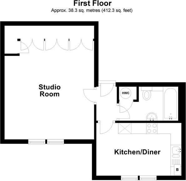

Hi there, wondering if anyone could give me any advice, I recently converted my studio flat into a 1 bed which involved putting up a stud wall, replacing an existing window that was covered up with a new double glazed one, I also removed a doorway and door to create a more open plan hallway area/lounge. Have recently sold the flat, somehow throughout this whole process no one told me that I needed to get building regs approval (don't ask..), so have paid for regularisation/retrospective approval with my local council building control. Have been speaking to one of their people over the last few weeks sending pics of stuff etc and have an inspection in a few days time. Although it has been a bit of a fight have and I think I was assigned quite a new/junior person have managed to get their approval on most things eventually. One thing they seem adamant on is replacing the archway into a door again. They want a protected lobby/ hallway area which I think is written in ADBV1. My flat is a very small first floor flat in a converted Victorian building which has 2 storeys and 4 flats in total. One ground floor flat which has its own entrance at the front and is completely separate, and 3 flats (2 first floor and 1 second floor) with an entrance to the side sharing a communal staircase. My flats floor level is less than 4.5 metres, roughly measured was 3.6 metres from ground level.
1. My flat is in a building that was converted into flats in the early 80s - does it definitely come under a block of flats or can it be classed as a dwelling? (as the building was converted into flats) being classed as a dwelling would seem to allow me to have the open plan layout but the building control seem to class it as a block of flats - its not really your standard purpose built block of flats.
2. I am basically looking for ways around putting in a door/doorway again where the arch is now, as this will create a very small impractical hallway around 3ftx4ft in size, where doors will open onto each other etc - if anything I would class it as more of a fire risk/trap but that's my opinion... I do understand the reasons behind protected lobby's. The flat front door opens directly onto the shared communal staircase. Is there any reason I could not class the living room area as the protected hallway as essentially you access all rooms from it as it's now open plan. Have attached the floorplans of the flat before and after the work.
Also if installed one of those permanent fold out fire escape ladders on the outside of the building going from the bedroom window (which is a fire escape window and goes down to a shared secure alleyway) thus creating 2 means of escape from the flat would this change anything? I also thought of replacing the kitchen door to a fire door with smoke seals, front door to a new fire door with smoke seals and all the mains connected smoke/ heat alarms which building control want installed anyways...surely in a flat so small this is suffice? It just seems like there is a slight lack of common sense when it comes to my local building control.
Any help or ideas would be much appreciated! Cheers

So to summarise... the top image is what you had, the bottom image is what you have now and the BCO has asked for a door to be provided/reinstated between the Living Room and Hall?
If this is the case, it sounds like the BCO is trying to make sure there is a protected escape from the Bathroom or Kitchen to the communal stair/lobby. However, both Bathrooms and Kitchens are not considered to be inner rooms (ADB, Volume 1, Paragraph 3.7) so having the open plan Living Room as the ‘access room’ in my opinion should be permitted.
There is the other case of the escape from the Bedroom only being possible via the Living Room. However, this can be overcome should the Bedroom have a window that meets the means of escape requirements (ADB, Volume 1, Paragraph 3.6).
Can you ask the BCO the reasoning for wanting the separation?

Yep that's - the top floorplan is before, the bottom is after I converted the flat. Basically the BCO wants a door reinstated between the hallway and the living room, after I enlarged the old existing door opening and put an archway in - creating one general access room like you say. Problem is reinstating the doorway creates a tiny hallway which seems mad to me where you open the front door and you block the door to the living room etc, the flat is small as it is!

@alex199 There are some alterations you could carry out which would enlarge the Hall. This would involve pushing the door into the Kitchen further into the Kitchen, more or less aligning with the external wall to the Living Room. Then have the door between the Hall and Living Room closer to the Kitchen end... if that makes sense. But a bit of a ball ache to have to carry out those alterations at this stage in the process. But as you’re selling, would it really be the end of the world if a door did go on as it’d be then up to the new owner should they decide to remove it? Or a sliding/pocket door could also work.

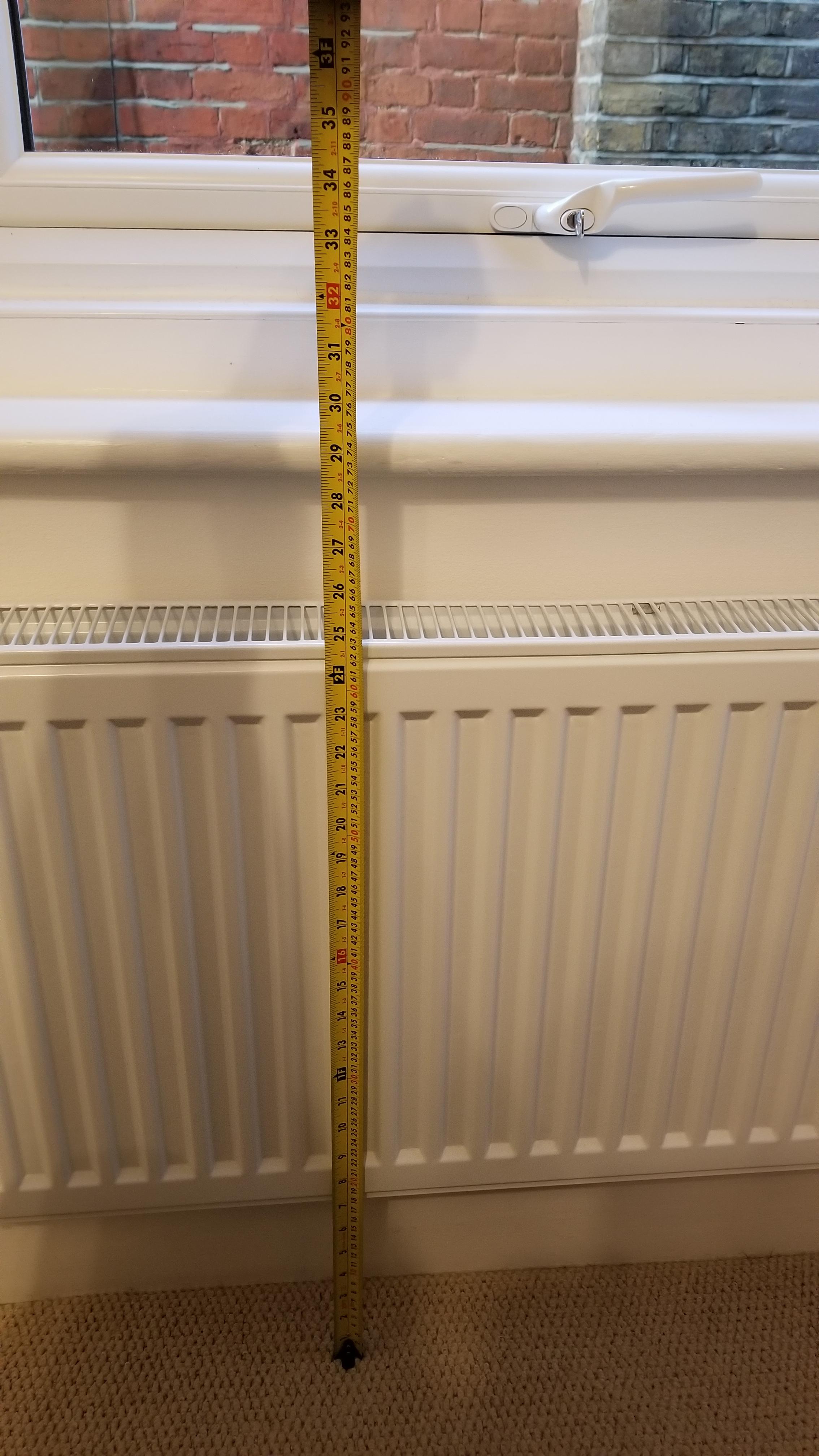

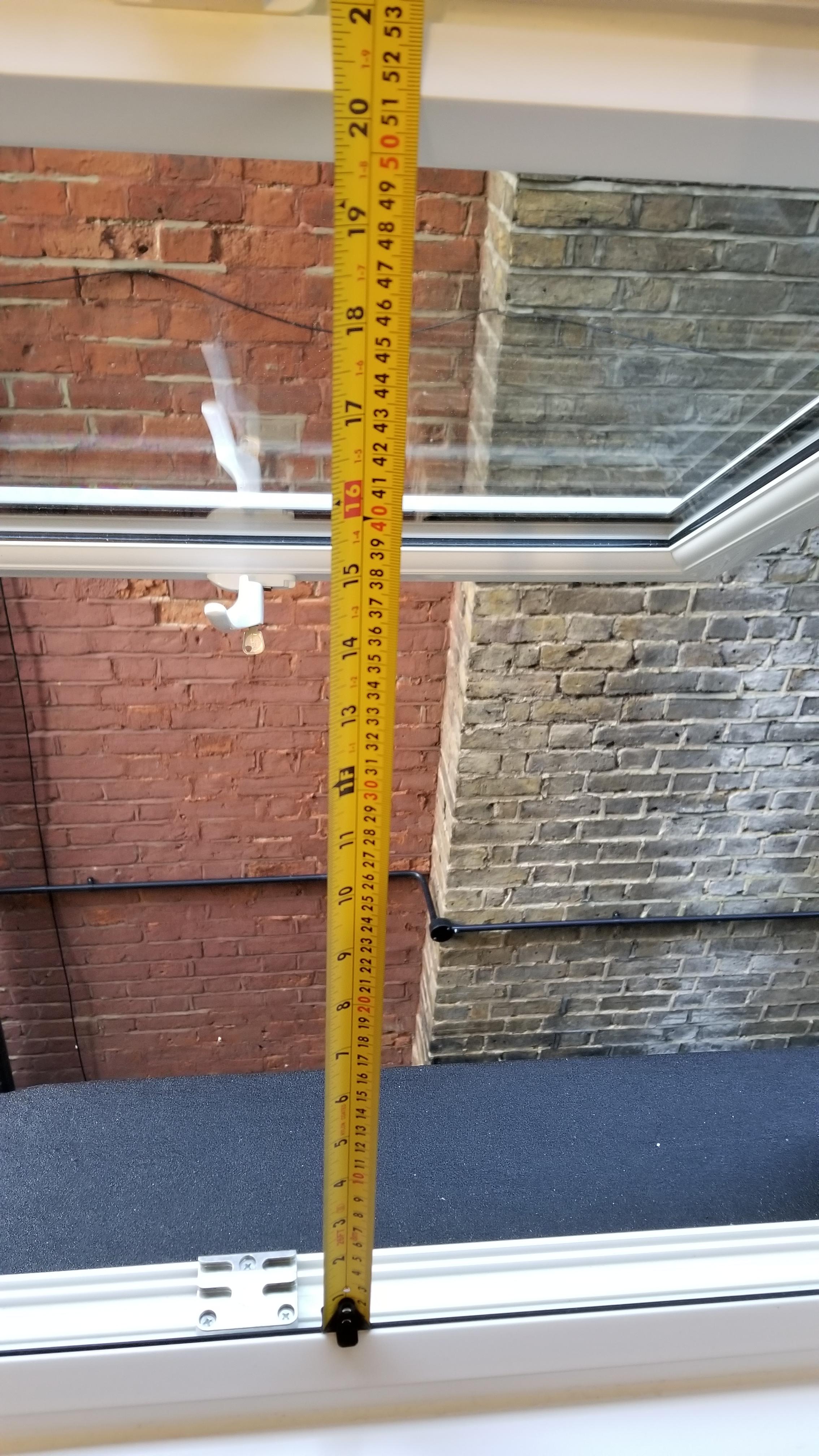

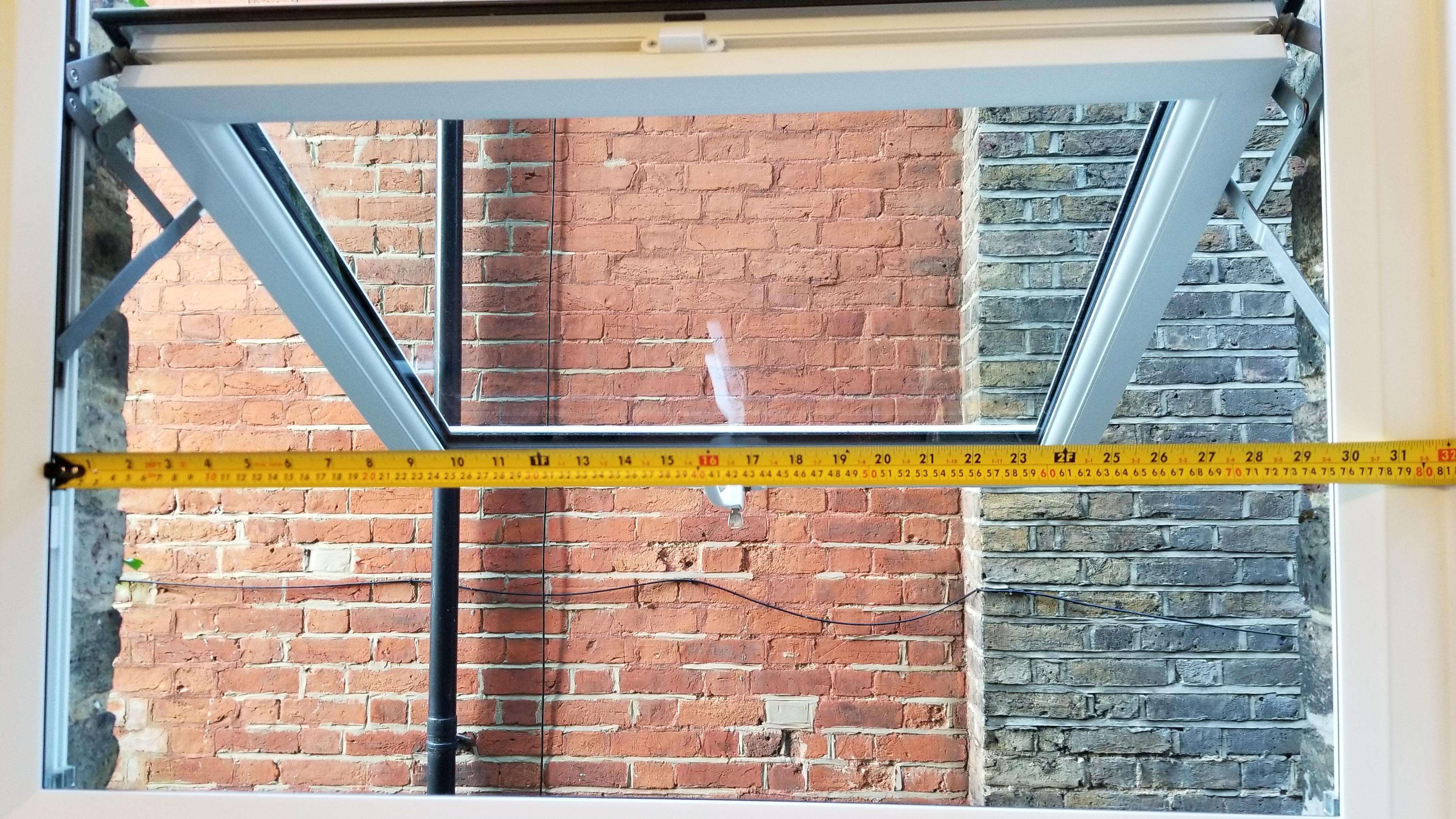

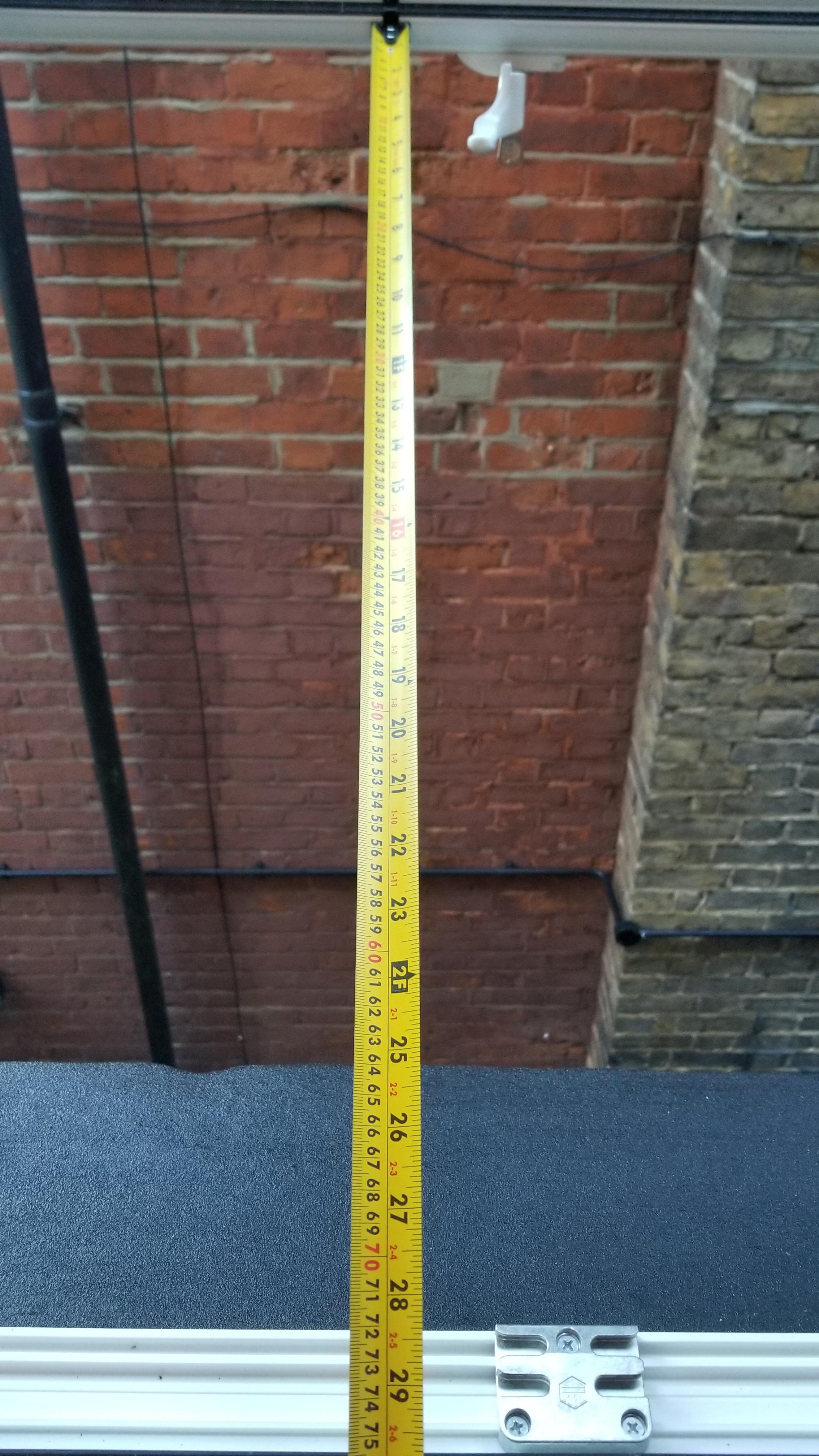

I think the window does, got some pics below took before for them, it doesn't stay open at the max on its own hopefully that shouldn't be an issue. Otherwise I think you can replace the hinges on the window which would save replacing the whole window I guess, it meets all the other requirements height from the floor etc.

@alex199 Your opening dimensions appear to comply as they provide a clear openable area of 0.5. How high is the cill above floor level as it should not exceed 1.1m? As for the hinges, Paragraph 3.6d states...
”Windows should be capable of remaining open without being held.”
So you would need to replace the existing hinges.

Cheers DevilDamo, Yeah I think it does comply, is well under that from floor level. It stays open wide enough on its own I think, but it won't stay open at it max 90degrees for example without being held would drop a bit, hopefully that's not an issue..bit chilly atm to be replacing windows :)
Posted
Looks to be around 840mm to the opening so that’s ok.
If the window stays open to a point where it provides the min. escape requirements then no need to change the hinges. As you have a 750mm wide opening, you would only need 450mm at the base.
Posted
It easily stays open at 450mm at the base, brilliant thank god for that...just the doorway , fire doors and smoke/heat alarms to sort out then, I reckon they should do a 'building regs for dummies' book for newbies like me ?
