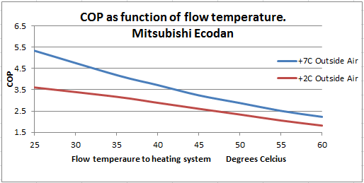

Jeremy Posted December 22, 2020 Author Posted December 22, 2020 On 22/12/2020 at 14:56, AliG said: Does the house have access to mains gas? If you have to heat the water above 45C in the ASHP the COP is going to suffer and it will be materially more expensive to run than a gas boiler.I Expand Ok, am back with a question: I did a quick check on the tech specs for performance on the Samsung 12kw ASHP we are looking at. At -2C ambient temp, running the pump at 55C, for 5.33kW in it will produce 8.73kW of heating. Isn't that still almost twice as efficient as gas?
AliG Posted December 22, 2020 Posted December 22, 2020 This is the heat loss calculator provided by a previous member of the group. It gives a good idea of heating requirements for a house. I personally would allow for as built performance being worse than calculated performance so add something on for this. https://forum.buildhub.org.uk/applications/core/interface/file/attachment.php?id=18333Fetching info... With your U-Values it will be very difficult to run UFH in a suspended timber floor and get enough heat into the room. I tried this in my last house which probably had around 0.25 U-value and had to run the flow at 60C in the kitchen for when it was cold outside. This gives you an idea of the COP of a heat pump depending the flow temperature and the outside temperature, ideally they are run at 35C or less for heating. At 45C flow you are looking at a COP of 3 or less which means that it will cost almost twice as much as gas for heating, but with less carbon. However, if you can get registered for the RHI then you will get more than the extra cost back.
AliG Posted December 22, 2020 Posted December 22, 2020 On 22/12/2020 at 21:09, Jeremy said: Ok, am back with a question: I did a quick check on the tech specs for performance on the Samsung 12kw ASHP we are looking at. At -2C ambient temp, running the pump at 55C, for 5.33kW in it will produce 8.73kW of heating. Isn't that still almost twice as efficient as gas? Expand We cross posted there - Yes, but gas costs around 2.5p/kWh and electricity around 14p, currently electricity is 5-6x the price of gas (On my tariff it is 2.14 vs 14.29, so electricity for me is over 6x the price of gas, you will lose a little bit of the benefit in the efficiency of a gas boiler being less than 100%)
Jeremy Posted December 22, 2020 Author Posted December 22, 2020 On 22/12/2020 at 21:19, AliG said: We cross posted there - Yes, but gas costs around 2.5p/kWh and electricity around 14p, currently electricity is 5-6x the price of gas (On my tariff it is 2.14 vs 14.29, so electricity for me is over 6x the price of gas, you will lose a little bit of the benefit in the efficiency of a gas boiler being less than 100%) Expand Gotcha. Thanks for the clarification. Definitely plan to get this all on RHI (thus solar thermal as well), and then get Solar PV installed in a few years (hopefully we get a decent subsidy regime in place soon as feed-in scheme is pretty dismal), so cost not as much of a concern overall for me. But point taken re: cheap gas!
PeterW Posted December 22, 2020 Posted December 22, 2020 On 22/12/2020 at 21:09, Jeremy said: Ok, am back with a question: I did a quick check on the tech specs for performance on the Samsung 12kw ASHP we are looking at. At -2C ambient temp, running the pump at 55C, for 5.33kW in it will produce 8.73kW of heating. Isn't that still almost twice as efficient as gas? Expand But at 85% efficiency, 8.73kW of heat needs 10.27kW of gas at a cost of 28.75p/hr. Using 5.33kW of electricity at an average of 14.5p would cost you 77.6p/hr or nearly 3 times the cost of gas. Efficiency and cost can be very different !
