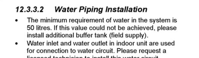

PeterW Posted December 15, 2020 Share Posted December 15, 2020 TBH that is my thoughts on all of these as you can stick an immersion in the buffer and get a backup if the ASHP fails or if you want a dump load for a PV array. For the sake of £2-300 it does seem like the logical solution, but in this instance the OP is referring to, the installation is authorised and as per the MIs so Panasonic need to cough up and fix it. 1 Link to comment Share on other sites More sharing options...
Rohan Posted December 22, 2020 Author Share Posted December 22, 2020 On 14/12/2020 at 22:29, PeterW said: So in the MIs it states the following : Go back to Panasonic, quote their own MIs and say this did not require a buffer as over 50 litres. Give them the exact reference above and then ask them when they would like to send their engineer .... The problem I am having is who is telling the truth. Panasonic say that a buffer tank should be fitted as part of the installation requirements. The installer is saying on his commissioning paperwork that there are 50ltrs water volume so doesn't require one. As an ordinary householder how do I know what is required. He says that he has fitted over 300 heat pumps with no buffer tanks. I am know faced with a bill to put this right by another installer. Link to comment Share on other sites More sharing options...
SteamyTea Posted December 22, 2020 Share Posted December 22, 2020 9 minutes ago, Rohan said: The problem I am having is who is telling the truth Let's tackle the problem from another direction. What is the power range of your heat pump? i.e. 3 to 12 kW What is the heat load range? 4 to 7 kW Then it should be easy to work out if a buffer is needed. Link to comment Share on other sites More sharing options...
jack Posted December 22, 2020 Share Posted December 22, 2020 3 hours ago, Rohan said: The problem I am having is who is telling the truth. Panasonic say that a buffer tank should be fitted as part of the installation requirements. The installer is saying on his commissioning paperwork that there are 50ltrs water volume so doesn't require one. As an ordinary householder how do I know what is required. He says that he has fitted over 300 heat pumps with no buffer tanks. I am know faced with a bill to put this right by another installer. Can't you figure out how much the volume of your system is? I assume you have an UFH heating design somewhere, telling you how many metres of UFH loops you have. You can also estimate the volume of pipework between the manifold and the ASHP. Assuming all that amounts to at least 50L, the installer situation becomes irrelevant, because you have it in writing in Panasonic's own manual that a buffer tank is only needed if the volume is less than that. What they say verbally is irrelevant given that it appears to contradict their own written instructions. Link to comment Share on other sites More sharing options...

Marvin Posted December 9, 2022 Share Posted December 9, 2022 Hopefully @Rohan will be able to help. On 22/12/2020 at 17:42, jack said: Assuming all that amounts to at least 50L, the installer situation becomes irrelevant, because you have it in writing in Panasonic's own manual that a buffer tank is only needed if the volume is less than that. What they say verbally is irrelevant given that it appears to contradict their own written instructions. Assuming this was not updated information. I would check with the manufacturer for the latest. Link to comment Share on other sites More sharing options...
